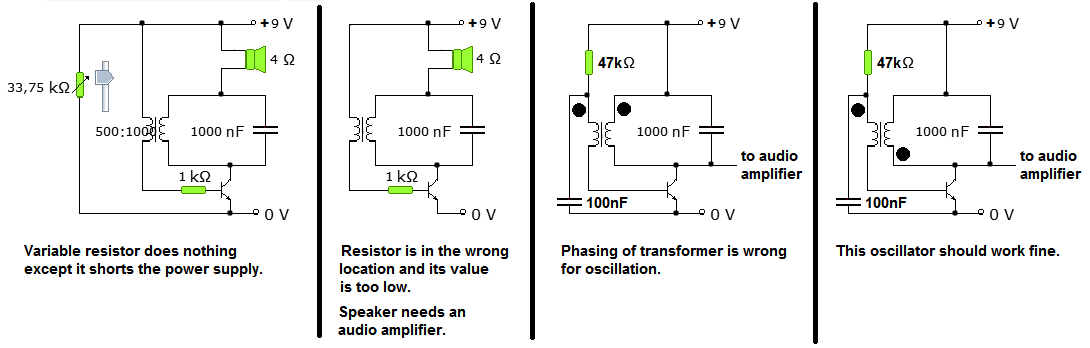

An oscillator uses noise in the circuit to get it going. But a simulation program has no noise, you must "kick" the circuit with a pulse to get it going.
Your circuit has a few things wrong, I fixed it and explained why:

Hey, thanks! I just tried it but it doesnt seem fully to work... In Yenka i have the ability to analyze the current/voltage etc from several parts.
And it doesnt seem to oscillate yet. What do you mean that i shouldnt phase the transormator? Do you mean the coil direction? Because it doesnt look like there is an option to change that.. surprisingly..
And to the amplifier... actually if i plug it to a sinus generator, it releases a correct tone, what is exactly the reason i could not plug in the way i had?

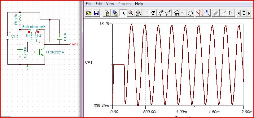

Some SIMs don't allow (or have the means for) adjusting the polarity of transformers. All that's necessary is to wire them to acheive the polarities needed, as below:
(Credit to AG for the schematic)
The transformer provides feedback so that the circuit can oscillate. If the coil directions (the big dots on my schematic) of the primary and secondary windings of the transformer are not correct then the phasing will be wrong and the circuit will not oscillate.
Either Yenka needs to go to electronics school or you need to go to Yenka school to change it.
Your circuit had a few problems that I discussed on my schematic.
