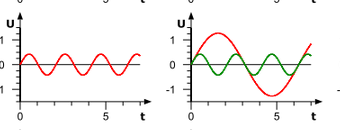

i could just add these two oscillations together:
and then get the sound.
The question is, how these two oscillations can be plugged together in a way, so they would produce a correct wave in every frequency pitch.
I hope this is understandable - the relation between the oscillators should be always the same in order to produce the correct result.

A musical instrument like a violin has MANY harmonics but you show only one harmonic (its second harmonic that is double the frequency of the fundamental frequency).
You begin with a frequency that is high then divide it down with a digital divider IC to get the harmonics and fundamental frequencies you want, then each must be filtered into a sinewave because the outputs of a digital divider are squarewaves like a buzzer. Then you must adjust the level and phase of each harmonic then mix them together.

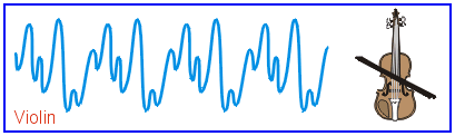

I found the waveform of a violin in Google Images. It has only a few harmonics:

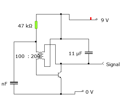

An oscillator uses noise in the circuit to get it going. But a simulation program has no noise, you must "kick" the circuit with a pulse to get it going.
Your circuit has a few things wrong, I fixed it and explained why:
I will try this circuit in RL on Monday, I think it might work, but could it be advanced in a way to be able to controll the pitch with an antenna? Replace the one condensator with the antenna? (Sorry, im really not that good in electronics :S)

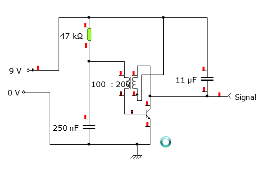

So... let's start over... What frustrates me in the first place is that none of the oscillators Ive ever tried in the simulation program really worked - audioguru's and cowboybob's as well. As soon i connect the ground in the bottom right with the transistor, Yenka starts to act awkwardly, the curser loads all the time... Probably I did something wrong but cant identify it.
So I am still stuck in the beginning, because none of all oscillators Ive found on the Net work for me. Maybe the program is "crap"? I dont know... do you know any other simulation program? I am going to try it on LTspice..

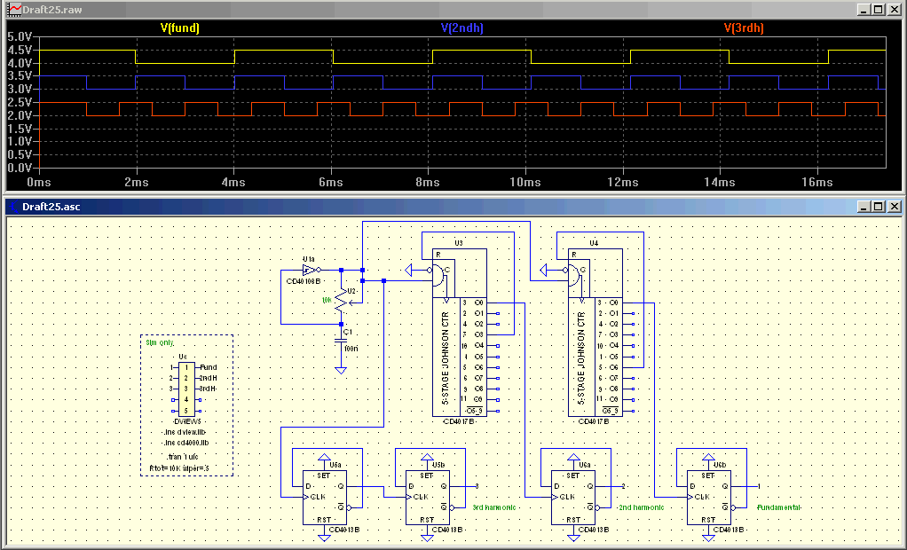

Here's a quick-and-dirty relatively simple way of getting a tunable fundamental frequency square wave plus its second and third 'harmonics'. You would still have the problem of filtering each signal to get something resembling sine waves, and tunable filters would be reasonably complex in themselves.
No inductance values of the primary and secondary windings of the transformer are shown. What have you defined them as?
And an 11uF tuning capacitor
That must be a close tolerance one: 10uF +10% tolerance :D
Oh.. i misread this
as 11 u. :sorry: My bad. But the problem with the never-ending loading still lies somewhere else...
Transformer inductance values... I think this program is not that advanced.. ^^ I can only vary the windings.
The scheme you have done looks very nice, but I dont know how to read it (its because of my low knowledge). Would it be too much expected from you to explain it in a simple way? As I see, there are not obvious inductors, so what do these "boxes" do? I am bothered by the feeling that i go on your nerves, because I dont understand everything that fast. I hope you can tolerate it for some time. :joyful:
