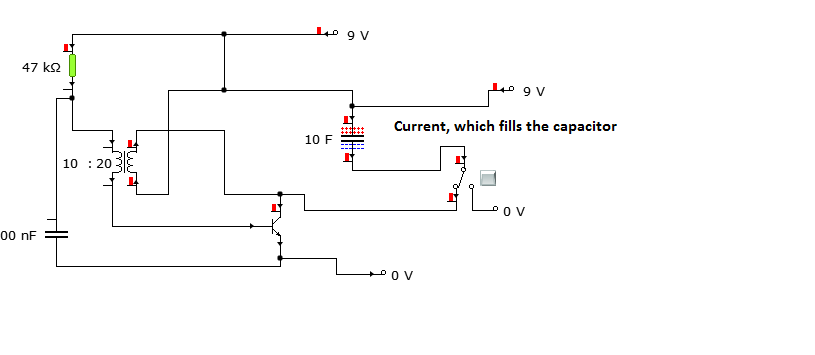

Transformer inductance values... I think this program is not that advanced.
I don't see how Yenka can simulate your circuit without inductance values!
The scheme you have done looks very nice, but I dont know how to read it

referring to Your post #21: i tried Your oscillator one more time and changed the plugging, as Cowboybob suggested. You spoke about "noise" that is needed? What do you exactly mean? That there should be first some current in the circuit to make it oscillate? I added a switch to a current, which will fill the capacitor and then oscillate... if I am not fully mistaken (im not sure about nothing anymore):
I made the Capacitor 10 F because yenka still crashes when I try to adjust it to 1 uF in Your scheme. Im not really sure what is wrong about it..

All electronic parts generate wideband noise at many frequencies. When power is applied, the transistor amplifies noise in the circuit and quickly turns on creating a pulse that also gets the oscillator going.
I think you should get rid of the transformer and make a digital oscillator and divider chain.

I wouldn't expect it to work with 10uF anyway, and as alec_t keeps pointing out, it's not going to work without inductance values either.
But even worse, you're essentially making an RF style oscillator, while it's perfectly valid for audio as well it's an expensive and large option with big transformers needed.
It's also totally unsuitable for syncing a series of oscillators together as you require.
