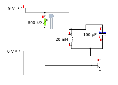

I have found the Armstrong-Oscillator and have build one with a program called Yenka. But it didn't really work so I made some prototype based on logic and eventually it oscillates. (Screenshot of the circuit I made) The problem know is, that I don't know on which parameters the frequency depends. I know that it depends on the Capacity of the capacitor and the inductance of the inductor, but still I need to know how i can determine it precisely so i can get the frequency i need immediately. There is the formula of Thomson - is it applicable to my circuit?
And is the program reliable, I mean, would that circuit Ive made really oscillate, and are there better solutions?

Your circuit is not an oscillator. An oscillator has positive feedback but your circuit has NO feedback.

Here is your schematic with the Yenka garbage marks removed:

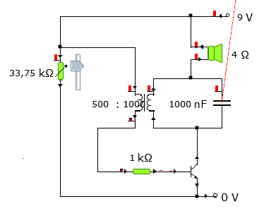

A Question: If i plug in a Transformator in a oscillator circuit instead of an inductor and wire to only wo one half (so to one conductor), should this circuit oscillate?
An illustration:
And furthermore: shouldn't this circuit oscillate...?
As i said, im not sure if I am doing it wrong or the program. ^^
