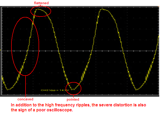

EDIT: I get the best looking signal with a 47uF AC cap:
Bottom sine peak looks only truncated due to oscilloscope scaling.
And with the transformer primary coil in series (just out of curiosity):
Reducing the value of the feedback to ground capacitor value to 100nF reduces the amplification of low frequencies (50Hz) but the distortion from the XR2206 at 100Hz and 150Hz has the original amplification so there is more distortion at the output.
Your 'scope shows severe distortion at the output. The amplifier should show no distortion so something is wrong.
If you refer to the small ripple waves on the fundamental wave, then this is most likely coming from my USB scope. I am a bit punished with it, because it has this ripple even with everything disconnected and after calibration.
I have no clue how to fix this, actually it probably can't as manufacturer states 3 % noise as normal

This explains why your circuit or oscilloscope is garbage:
Thank you. My oscilloscope and my circuit are garbage.
That noise looks like it is somewhat systematic which means it could be coming from inside the scope itself and interfering with the signal. It's probably coming from the timing circuits inside the scope. What might help is to use some external amplification and set the vertical sensitivity a bit higher. For example, with no amplifier and the scope vertical set on 0.1v/div you might see some objectional noise riding on the signal, but if you use a 10x external amp and set the scope on 1v/div that noise should not be as pronounced as long as the external amp is designed right. Perhaps a high speed op amp will get you there, but i dont know the max frequency capability of your scope.
You could build a small op amp amplifier and power it with a battery or two and see how it helps. The input impedance for your new scope booster amp doesnt have to be super high for testing the transistor amplifier you are working on or for testing power supplies.
