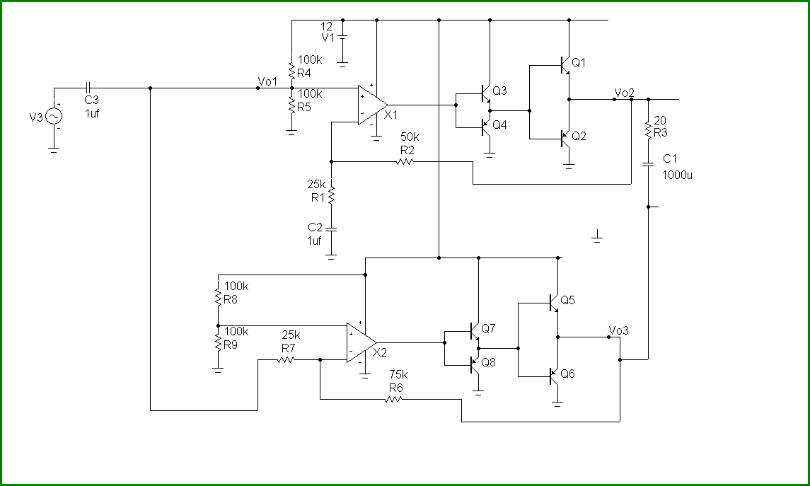

Hi again,
Well, the other amp you posted is a little better, having a current boosted voltage follower output stage. That's only got about 1 diode drop, which isnt bad really. That should work too without going to too much trouble.
You should be able to get this to work one way or another. You'll have to remember though that with a 12v power supply putting out a sine wave without using a bridge arrangement will mean only 6v peak is available even with a rail to rail device. That's only 0.6 amps peak into a 10 ohm load too.
With a bridge arrangement you can get 12v peak with a rail to rail, or about 10 or 11v peak with a standard transistor output. That's about 1 amp peak into a 10 ohm load.
For a bridge arrangement you build two such circuits and invert one of them with the op amp or another op amp. You then connect between the two outputs rather than between output and ground. That gives you twice the output voltage peak that you would get from a single output amplifier.
Thank you for that suggestion. The idea of doubling the circuit for a higher voltage swing is very good.
Just to make sure i understand it correctly, would it look like this?
This would also split the XR2206 4.8 mA output to 2 circuits for 2.4mA each right?
Here is an example.
Note the gain of the top stage is 3 so the bottom stage gain should be the same, so the feedback resistor is different.
Also note R7 is the same as R1.

MrAl. Very kind of you to draw it. Thank you.
I will get the additional components and experiment with it and hopefully figure
out the right current flow between the transistors to reach the 1 Amp mark.
For the full voltage swing i would also probably have to change the feedback resistor ratio.
Hi again,
Unfortunately all those emitters (3 of them) in series means we'll lose a lot of voltage which will be significant at 12v. To get better you'll have to switch to a current boosted voltage follower output stage like your other amp link showed. Using only four transistors per amplifier, that allows up to about 9.5v peak output which would be 950ma peak into a 10 ohm load. This also requires a rail to rail output op amp.

Since you need only 12V x 1A=12W then an audio amplifier circuit is fine.
Your circuit does not work because its max output is only about 7V p-p with a 12V supply and your transformer does not work at a frequency as low as 50hz.
Here is a quick pic of the new output stage. This will help get up to the full voltage. Note the voltage drop caused by the first transistor is still around 0.7v, but the second transistor now can get near saturation which could mean only 0.3v drop. Since we only have an equivalent plus and minus 6 to work with relative to the average output voltage, that means we may get an equivalent plus and minus 5v out of each amplifier and when connected in a bridge arrangement that means plus and minus 10v across the load which into a 10 ohm load provides the 1 amp peak requirement.
As usual, the feedback resistor connects directly to the output which in this case is the two transistor collectors.
Something to watch out for is a little more distortion around the peaks when trying to drive this thing to the full amplitude possible Cutting back very slightly on the input amplitude should reduce that distortion if it is a problem.

@MrAl: I have built the circuit with the bridge-connected amplifiers.
Now i must start to determine possible resistor values for the bases of the first transistor stage. I believe i smoked them out by doing an initial test.
I should get a dozen of those hehe.
According to the datasheet, the op-amp puts out something like 40-50 mA, with the resistors used as per your schematic suggestion the voltage is exactly 5 Volt RMS.
With a hfe of 150 for the BC546/BC556, the collector current would be
750 mA.
The hfe of the TIP121/TIP126 is 1000.
Now, if i don't get that wrong only a base current of 1mA would be needed to get a collector
current of 1 amp at the 2nd transistor pair.
So is it the right approach to find a base resistor value for the first transistor stage that would give a collector current of 1mA? So 5kOhm resistor?

After studying a lot of circuits, i realized that i am maybe too overcareful with the resistors and possibly this arrangement kind of regulates itself. So i went ahead and just connected the transistors with a 100 ohm base resistor and for one amplifier i got a current of 300mA RMS through the load resistor. This looks like a good figure.
Hi again,
Yeah the resistor cant be too critical because the gains of the transistors changes with temperature anyway. To work properly the circuit doesnt really need base resistors so all they would do anyway is provide for some simplified output current short circuit protection perhaps. You might try changing the values to see that you get full output yet limited current if you try to increase the load current too much.
The other circuit you posted has resistors going to Vcc to make sure the second transistor turns off completely when it's not supposed to be conducting.
