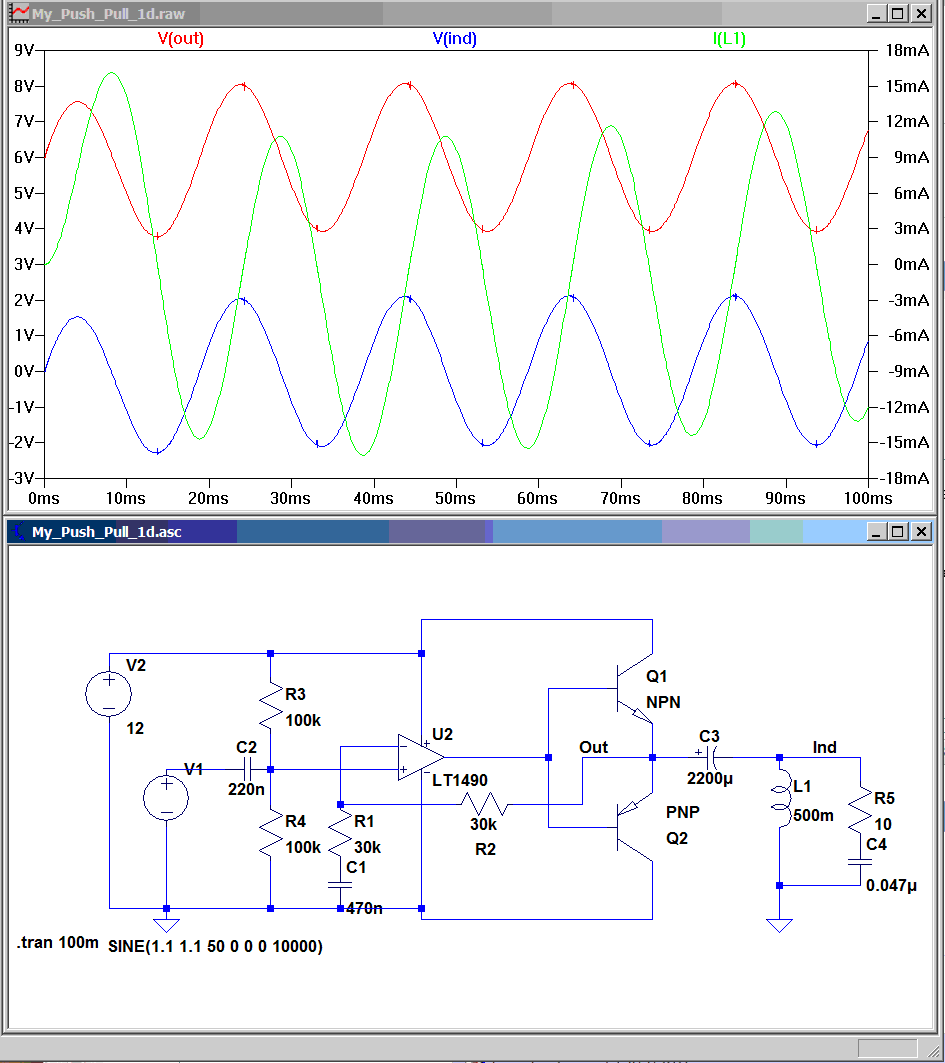

Hi xeno,
In my previous post i mentioned that you changed the feedback. What i meant by that was the connection itself.
Try connecting the right side of R2 to the two emitters of the two transistors.
You can get away with connecting the feedback as you have it if the signal to the transistors is large, but with smaller signals like 1 or 2 volts you'll see a ton of distortion. Connecting the feedback resistor to the emitters instead of the bases allows the op amp to compensate for the voltage drops of the two base emitter diodes, and thus reduce distortion. You still might get some crossover distortion, but much less than what you are seeing now.
Start with a low gain like both resistors equal to 25k and work up from there. Gains too large will also cause clipping depending on the input amplitude.
To model the inductor correctly you should also put a small series resistance in series with it. Say 1 ohm.
@MrAl. Thank you, i have gone ahead and connected the feedback to the emitter again and have both R1 and R2 30k now. The waveform across the coil looks like this now:

Try a 10R and a 0.047uF in series across the output load.
The output of the push pull stage MUST be coupled to the output load inductor via capacitor, say a 220uF or 470uF for starters

What kind of NPN and PNP transistors are you using? If they are too large there may not be enough drive. Try small ones like 2N4400 and 2N4403. If that doesnt work there's really something very basic wrong.

@MrAl: I am using TIP120 and TIP125. Without connecting the coil, there is a good signal at the emitter, so i don't think it might be due to the transistors alone.

As i suspected, the transistors look too big to drive directly from the op amp. Try smaller transistors like i mentioned earlier. Once you get that working you can always work your way up to larger ones being driven from the smaller ones.

The problem is that the impedance of the 10mH inductor is only 3 ohms at 50Hz, thus the transistor has to drive a lot of current. An actual transformer will need to have a much higher inductance than that to minimize the magnetizing current. You probably need at least a few hundred mH.
Attached is my simulation with a 500mH inductor and a larger output cap (it resonates somewhat with a 220uF cap). That gives a little over 10mA peak inductor (transformer) magnetizing current.
The small glitches are crossover distortion.
