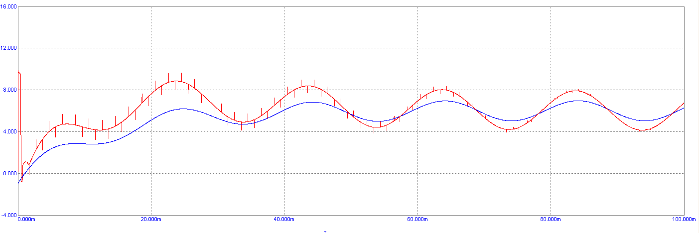

Since you were having so much trouble with this amplifier i decided to sim it myself too. The results are shown in the diagram attached.
This is with two 25k resistors for R1 and R2 and on the output i have 1 ohm in series with 10uf in series with 10mH.
The input is a 1v peak sine 50Hz. The blue wave is the junction of the two 100k resistors, and the red wave is the output at the emitters of the two transistors. The two transistors are 2N4400 and 2N4403, and that is all that drives the output. At this somewhat lower voltage level the sine output looks quite good as expected with the type of feedback we are using.
You can see some initial spikes on the output, but they go away as the caps charge up to their nominal values. Toward the end of the diagram you can see the sine start to look very good.
If you are getting saturation in the real world, you wont be able to use that particular coil. That's the way it goes. If the coil primary can not sustain the voltage presented to it at the required frequency then all you can do is get another coil that can handle the higher current levels.
How are you getting these waveforms BTW, are you using a scope? If so, try looking at the current wave into the coil and post that too. It would also help for you to post the pics with a little bigger text so we can read the text too.

Thank you for the simulation and the explanation.
I had used 0.8mm wire for winding the primary, i will try a much smaller diameter wire which
will have more resistance.
The amplifier part should work fine now as your simulation showed.
All that is left for me is to educate myself more on how to design the transformer
appropriately to avoid saturation.
