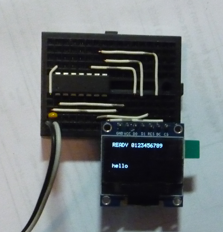

I have that same 0.96" SPI 128x64 SSD1306 OLED display. When I received it a few months ago I tested it to make sure it worked using Arduino code.

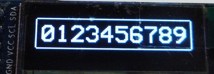

Since I have working I2C (xc8) code for a little 0.91" SSD1306 128x32 OLED display, I'll attempt a version for the 0.96" SPI display, if you'd like.

I tried out the adafruit code it works But I'd like to use with a pic something to play with LOL I found some code I could make sense of LOL
Just it's for a click more pins on the click
http://mplabxpress.microchip.com/mplabcloud/example/details/103

Edit: Probably some boolean types in there you'll have to make uint8_t.
I just converted my 'minimal' XC8 (16F1823) demo program for the little 0.91" 128x32 I2C OLED display to a "minimal" version for the 0.96" 128x64 SPI OLED display. It's a single file, a little over 300 lines, and uses just over 400 words of program memory, including the 240 word 96 character 'packed' 5x7 font table... I'll try to run this on real hardware tomorrow...
The I2C program for the 128x32 0.91" display is a bit longer and larger due to all of the I2C functions but I really like the 2-pin I2C interface (you could use it on an 8-pin PIC) and I'm kind of tickled to be running the I2C interface at 1-MHz without any problems.
Thanks DirtyLude And mike if you don't care id like to see your code as well
Happy to share but even though it's an XC8 program, it has a bunch of assembly language. Sorry! I try to use straight C code but I can't help myself when I look at the code XC8 generates and so my programs seem to end up being assembly language programs in a C wrapper.
Caveat! The program is "untested". It's for an "enhanced mid-range" 16F1823 running on INTOSC at 8-MHz, hardware SPI (500-kHz clock), and Vdd = 5v. Hope to test it on real hardware soon.
Mike
  • XC8_OLED_SPI_v1.c
With minor tweaks to the SSD1306 config settings the program runs on real hardware and I've updated the source file in the previous post. It's very "minimal" and probably not a very good example but it's a good starting point (for me) for that Key-chain Domino Calculator (grin)...
Cheerful regards, Mike
