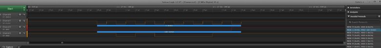

Hi T,
I expect the 1st (0 BYTE to be a DUMMY) and the next BYTE to be a £ (163), which it is as can be seen in this data analysis.
My logic is that the MASTER sends it's M2S and when the SLAVE wakes up it receives the M2S and exchanges it's S2M, so this is the order I put them.
It will take me some time, to figure out from what you say, what the errors are.

On the slave side, as long as you don't care what the master's sending (which seems to be the case here), I suppose it doesn't matter if the slave reads garbage. You don't even need the m2s() array... you could replace that with 'WREG = SSPBUF' and it should give the same result. You do need to read SSPBUF so that it clears the BF flag, but you don't need to do anything with the result.
The 'delayms' call on the master side all depends on what else the slave might be doing. If there are no interrupts then that could be reduced to just a few usecs. If the slave is using interrupts (for something else) then that delay call would have to be as long as the worst-case interrupt execution time.
