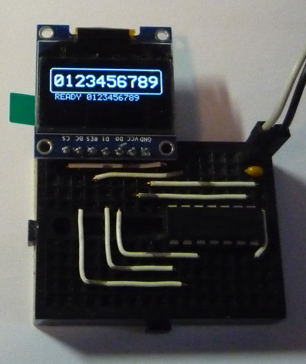

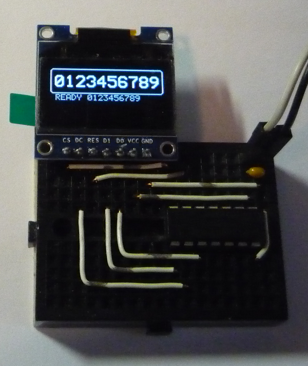

Oled spi in C
The hardware SPI interface is running at 4-MHz now with just a minor change to the code...
C:
 *   main setup                                                         *
   void main(void)
   { ANSELA = 0;                    // Analog off (digital I/O)
     ANSELC = 0;                    //  "
     TRISA = 0;                     //
     TRISC = 0;                     //
     OSCCON = 0b01111000;           // INTOSC 16-MHz
  *  initialize MSSP module SPI mode 0 (CKE=1/CKP=0, Fosc/4)            *
     SSP1STAT = 0x40;               // CKE = 1
     SSP1CON1 = 0x20;               // SPI Master, Fosc/4, CKP = 0
Research suggests, and experiments seem to confirm, that we can trim the initialization sequence by taking advantage of SSD1306 controller defaults. The SSD1306 default display orientation with these 0.96" displays is connector at bottom of display. All of the examples I've seen use the 'A1' and 'C8' commands to flip the orientation on these displays to connector at top of display.
