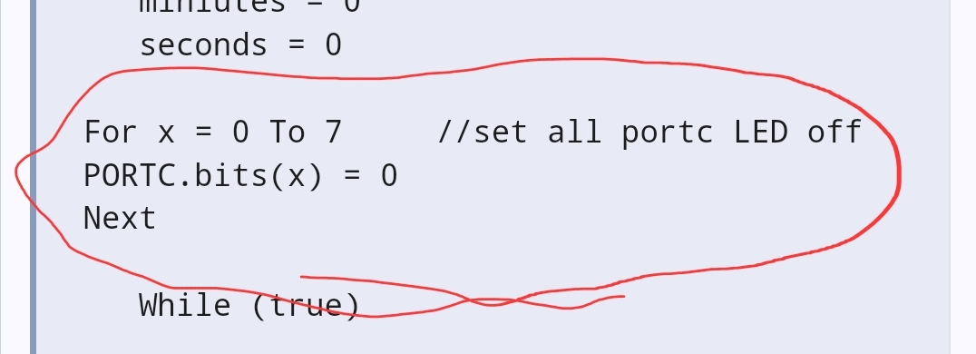

this code is clunky but it works for hours and miniutes.
How to show you don't understand basic concepts without saying so.
A quick glance shows some problems are edge cases.
The part I pictured will do the job – it just shows a fundamental lack of understanding.
The "edge cases" I refer to are around incrementing and decrementing where carries are involved. I think some of the less than / greater than tests are backwards. Sometimes people fail to test what happens at the edges.
For MrDEB education, let me explain my above comment.
For x = 0 To 7     //set all portc LED off
 PORTC.bits(x) = 0
 Next
This loop runs through 8 times and generates a whole lot of machine code to set each bit of PortC to zero.
This command does the same thing in one step.
PortC = %00000000
The percent sign indicates a binary number of 8 bits, all set to zero.
%00000000 (binary) = 0 in decimal.
PortC = 0
Same result as above. All bits set to zero.
Let's say you wanted to make all the outputs high to turn all the LEDs on. A similar loop could do it.
 PORTC.bits(x) = 1
 Next
But it would be easier to use this.
PortC =:%11111111
The binary number sets all bits to 1 in one step.
What does this do?
PortC = 255
256 is the decimal number equal to %11111111, so it sets all eight bits to 1.
What about this?
PortC = $FF
The $ indicates a hex number. F = %1111 in binary, so FF =:%11111111. Same thing again. All LEDs on in one step.
Finally, before I go back to sleep, think about what this would do.
While 1 = 1
     PortC = %10101010
     DelayMS(1000)
     PortC = %01010101
     DelayMS(1000)
Wend
Think it through. It's not difficult.
