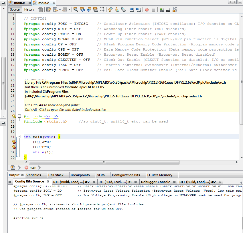

I've got a project and MPLAB X underlines all the variables (PORTA etc.) in the include file with a red line and says it can't find the include file.
The error is,
When I hold Ctrl as suggested, I get this,
The file compiles without warnings or errors.
Anyone and idea how to solve this?

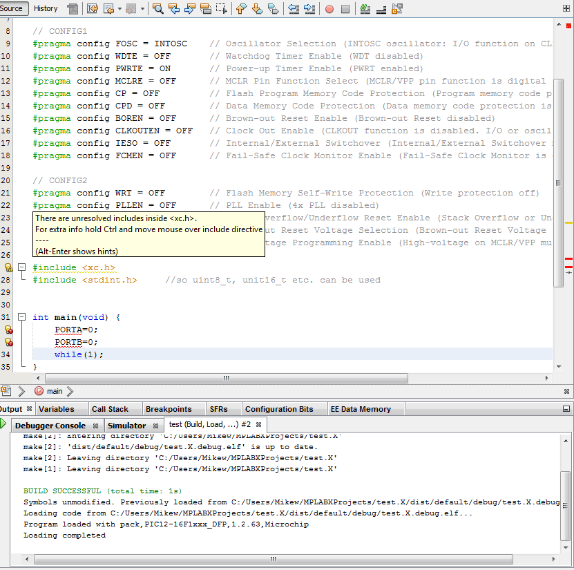

No, but I get the same issue occasionally - and sometimes only part of the include file names appear to be missed out, with the rest working, and defines sometimes don't highlight in blue either.
The dreaded mplabx "red squigglies". Search the microchip forums and you'll get 1000's of hits.
I don't think there's a single "this fix works for all situations" answer.
The accepted resolution seems to be if it compiles ok then ignore it. Isn't that great?

I find it's usually It's usually variable or function names that are built in to the compiler, rather than being defined in an include file that MPLab can parse so it recognises them.
That's down to the way a specific compiler works, rather than a fault in MPLab.
Every variable should ideally be visible / defined for the editor, else it cannot know it's not an error or omission.
Sometimes it also seems to come from nested includes that have not been fully parsed - but those usually vanish after the first compile.
I routinely use the "production - Clean and build" menu option as a quick checker for any syntax or compile problems, then only use the debug or programming functions after verifying everything compiles correctly.

The compiler can see ALL of the includes as it compiles without error. It's a bug in MPLAB X that needs fixing. I've copied the include files into the project directory and that fixes the problem, how do you explain that other than a buggy compiler or IDE. Are you suggesting that PORTA is defined in the compiler? It redlines ALL the SFR names in my file.
This is the extent of it,
And it still compiles fine, even though every single line has an error. Except, while(1).
Any explaination?

The port A - B - C registers (and a few others that may be accessed as a whole rather than bits) have this style of definition, to trick the IDE into seeing a definition without upsetting the compiler:
#define PORTA PORTA
Some registers have the address hidden in an asm line, whish may mess up the IDE recognition??
asm("SPBRG equ 0FAFh");
What happens if you add the #include for the specific device first, so it's not hidden away?
I copied the "missing" include file into the project directory and included with quotes and that fixed it for one compile and then it came up with an error (on subsequent compiles) that I had no idea what it meant. So, compiled fine once and an error after that!!!!!!! This thing is broken. Microchip need to fix it.

It puts underlines on all compiler built-ins on the initial load of a project, though they disappear after building it for the first time (not using the quick production one, as I thought - but they do not re-appear when that is used afterwards).
What happens if its after the xc.h include? It should only be read then if the IDE or compiler has not used the buried copy?
I've now got a new warning,
main.c:27:10: warning: non-portable path to file '"pic16f1827.h"'; specified path differs in case from file name on disk [-Wnonportable-include-path]
But only after the second compile!
