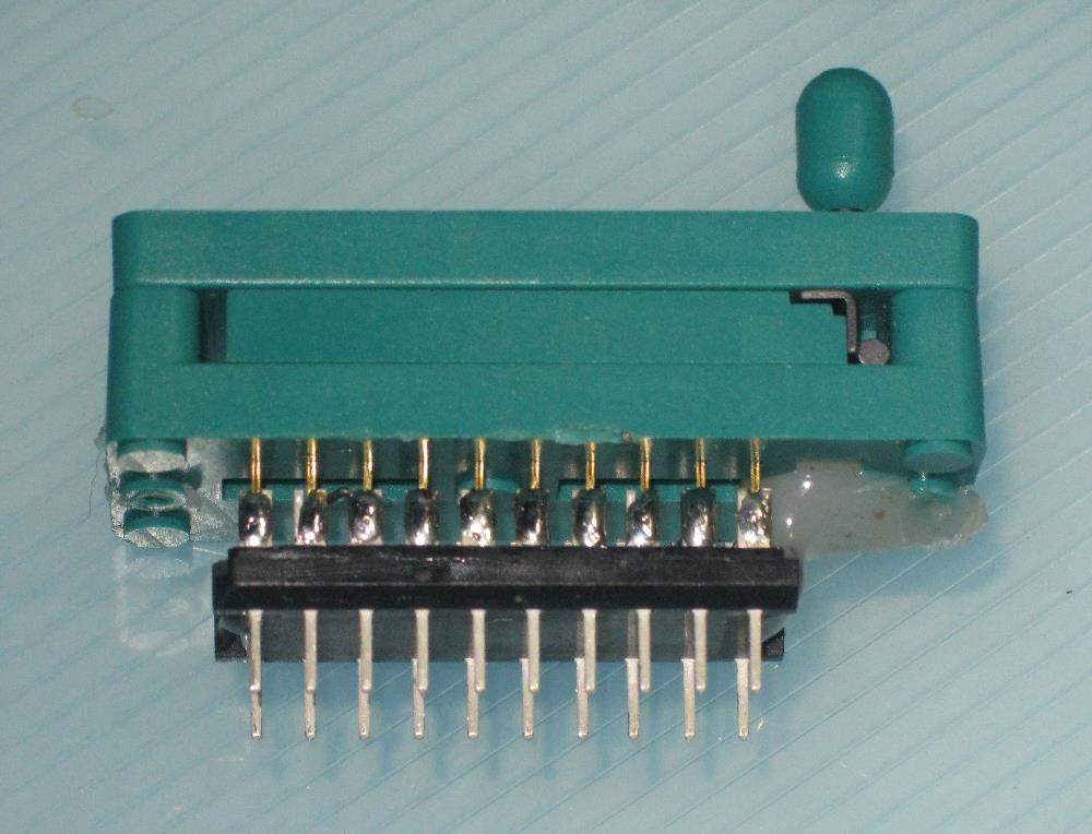

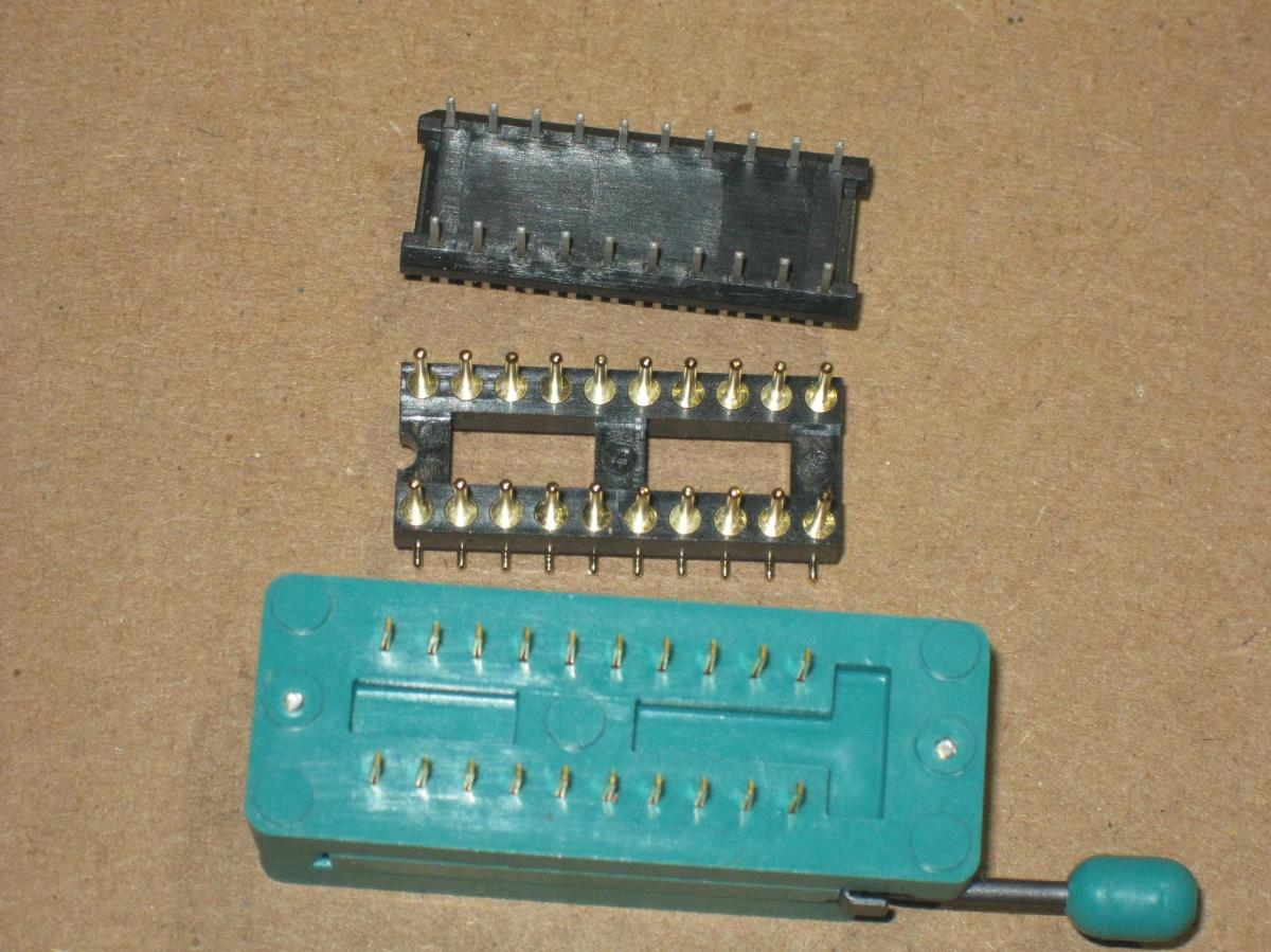

Hello,
There are a number of different pin sizes, shapes, and diameters. This leads to problems sometimes which i'll describe here.
Most DIP chips can mount in PC board holes that are of a very very small diameter. Most sockets that hold DIP chips have similar pins on the bottom, so they can also mount in the same PC board holes. This allows us to use sockets when possible so we can exchange the chip easily.
I purchased a ZIF socket and expected the bottom pins to be roughly the same size as a regular DIP socket. But apparently they wanted to change the whole thing to something else, and who knows where they got the idea to go with a non standard shape/size/orientation. Let me explain in more detail.
A 'normal' 0.3 inch row spaced DIP socket or IC package has pins that are rectangular, but the long side of the rectangular pins is oriented along the LENGTH of the package. The ZIF socket does have rectangular pins, but they are larger than a standard socket and also are oriented along the WIDTH of the package. That makes it impossible to insert into a PC board that has holes drilled for a regular socket or IC package.
Any ideas why this is so? I am sure they can be made more standard one way or another. Why make then non standard? That makes it hard for a manufacturer to use a ZIF socket as an afterthought.
I am including a picture of the bottom of the ZIF socket (bottom of pic) and two DIP headers for reference, but you can look at a standard IC socket or package to see the more standard pin shapes and sizes. Note also that one of the DIP headers shown here also has non standard pin diameter where it is very much larger than a standard package so it will NOT plug into a machine tooled socket and maybe not even a dual wipe socket because the pins are too thick.
What it means for the ZIF socket is i have to use one of the headers to make an "adapter" for the ZIF socket, so it will fit into a standard socket or PC board drill pattern for a standard DIP package.
Any ideas?

I don´t think it matters whether the pins are square, round, flat lengthwise or widthwise. What matters is the diameter of the pins.

Well the shape and orientation does actually matter because if the shape was the same for example but the orientation was 90 degrees rotated, it would fit in a standard dual wipe socket (not a machine tool socket though). That's what i was hoping for in the first place.
The wide of each pin is about 50 percent wider than a standard dual wipe socket, and the thickness of the metal used to make the pin is also about 50 percent thicker. So look at a standard socket and multiply the width and thickness by 1.5 and that's pretty close to the ZIF socket pin dimensions.

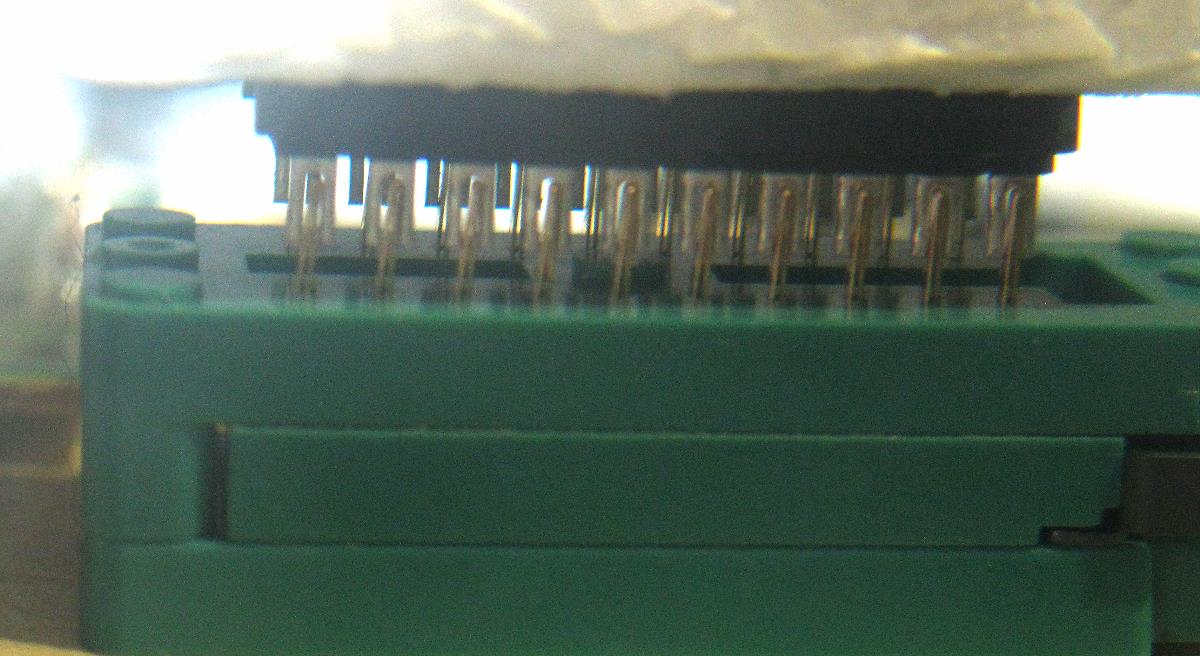

The only method i see so far is to use that one DIP header with the grooves in the top part pins (the pins on top are forked). The ZIF socket pins are orientated so they will sit nicely inside the grooves, but it's got to be aligned perfectly and then all pins soldered for strength. That's going to take some care and careful setup. If they made the socket better to begin with none of this would be needed.

I'm thinking that the reason the pins on a ZIF socket are that orientation, is due to the way the ZIF socket operates.
As the socket has to allow for different width DIP devices, perpendicular to the length, the spring contacts are simply folded from a single sheet, resulting in the fold being used as the pin for the ZIF itself.
Perhaps if they twisted the folded portion, the contacts may easily fracture or not align with the housing correctly?

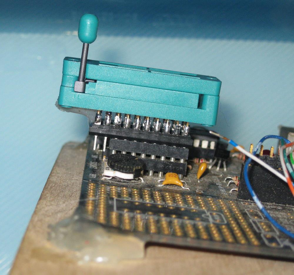

Also consider this: View my attached photos, then consider that if i wanted to pull that Eval socket and replace it with the ZIF socket shown previously, it would be impossible without redrilling all the PC board holes that accept the socket. That means that boards already produced can not simply change to a ZIF socket like this. That's a big disadvantage to the company that sells ZIF sockets because that limits sales to new deigns only.
Note it may be possible to do with an older board, but the holes would have to be bigger and that could cut off traces that already exist and so require inserting small thin wires into each hole to make sure it makes proper contact with both sides of the board. In other words, it's very difficult to do a full mod like that.
Now consider a socket that does have the right size pins: It's a snap and takes no more time to install than a regular socket.
Considering the normal price for these sockets is about $17 USD, they should be right to begin with dont you think?

Here are a few pics of the finished "product" that fits easily into the old socket or can be used to replace the old socket. Note how high it has to stick up with the extra header requirement. I am also posting a pic of the socket it has to plug into.
You can also see how nutty this looks when it's plugged in. I do have one extra socket but it is low profile.

I fail to see the point here, who would put a socket into a socket? These are meant to be soldered into boards, not stacked one on top another.
I not only *would*, i actually *did*, plug a socket into a socket. That converts a standard socket into a ZIF socket if the application frequency spec's allow it. That means the user can convert their socket into a ZIF socket after market.
Didnt you see the last picture i posted with the whole thing plugged into the board?
The more conventional approach would be to unsolder the old socket, then mount and solder the new ZIF socket. But that creates serious problems with the existing board layout.

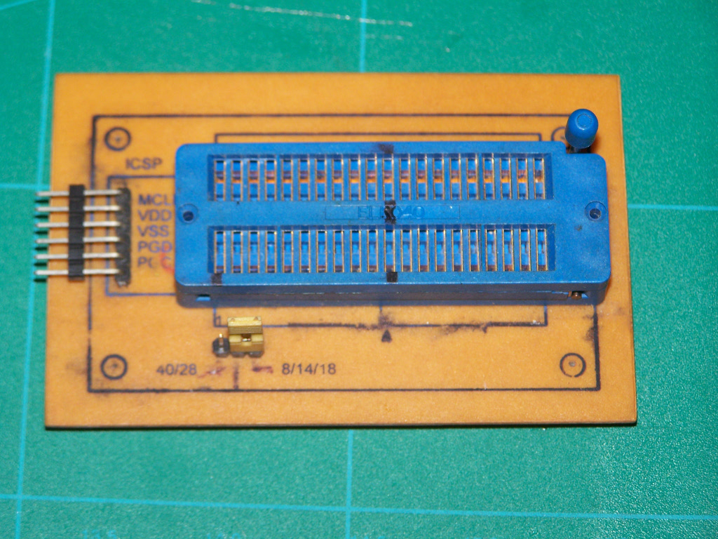

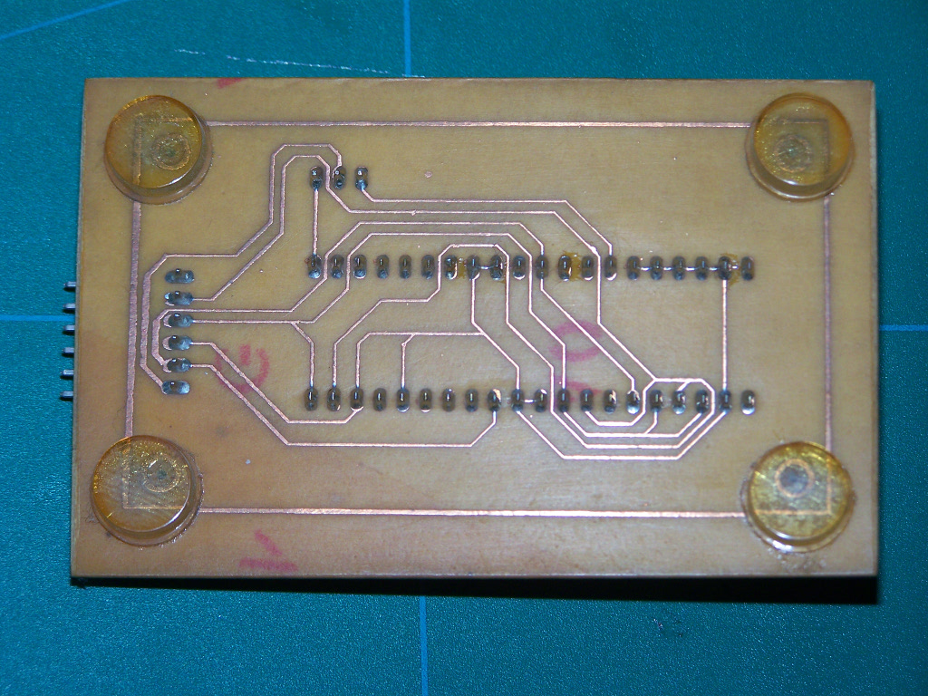

I knocked up a 40-pin ZIF board a number of years ago, using EAGLE.
It is based upon a JDM board, built by Feng3, but is not a JDM, it plugs straight into a PICkit or ICD using the 0.1 header.
https://www.hamradio.in/circuits/feng.php?sid=fb6a833773e6360ce5b01daff33e1cb3
Here's the PCB
I found that I couldn't program an 18F4550 though, because the USB lines at RC4, 5 & 6 were connected to PGC & PGD, but those were still required for other packages.
In the end, I modified the routing and added 3 2-pin headers to get around that problem.
I never etched the modified version, but it should be ok.
Here are pics of the original.
It's certainly not pretty and could use some tidying up, but it works.
The .sch & .brd are attached, if you would like to play around with it. (Remove the .txt from 40 Pin Zif.sch.txt)

The ZIF is marked "ELK040" and a search reveals that it is made by ECC?
https://www.batronix.com/shop/sockets/ (it is the very bottom one on the list)
I think it was ordered from Maplin in the UK, but I can't confirm that 100% as it was a number of years ago.
