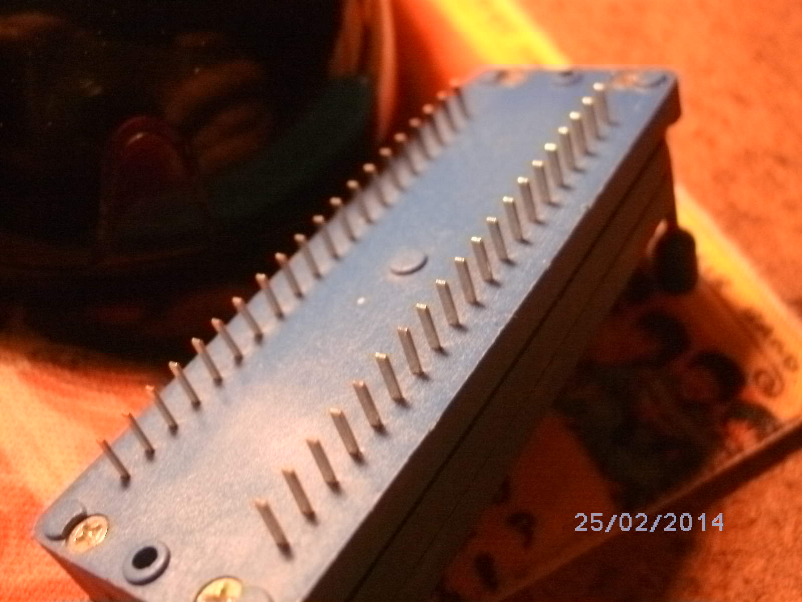

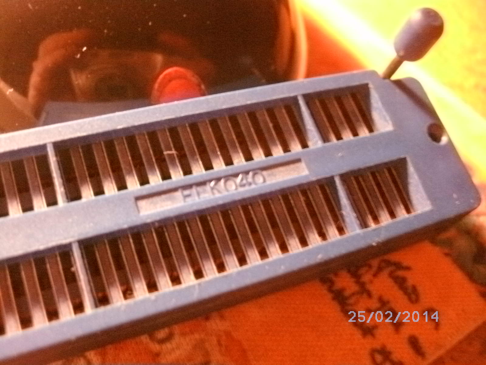

Tell me about coincidences and/or sheer luck. Myself, I was thinking of soldering a small building block for mi breadboard to accomodate 40-pins PIC micros feeling discouraged because all ZIF sockets in my drawers I could recall, were as you described.
Minutes after rereading the whole thread I went to my bench and run across of a 40-pins socket that has been floating around intact, for YEARS. I bought it in the States, more than 25 years ago.
See the pictures.
It fits the breadboard perfectly.
By the ID, I searched and found this. Scroll down to bottom.
Could it be of help? Buena suerte.
Hi Agustin,
that is the exact same ZIF that I have, but the problem MrAl has is that the 'pins' using the term loosely, do not fit into a standard DIP socket easily, along with not fitting into a PCB which has holes drilled for standard DIP socket pins.
This particular ZIF will fit into a breadboard quite well, since the metal fold which creates the 'pin' is aligned perfectly with the spring contacts in a breadboard.
Try fitting this ZIF into a double-wide (0.6") IC socket and you will see where MrAl is basing his observations from....
As an example, you could liken it to trying to insert a TO220 transistor/regulator across 3 rows of a breadboard and see the relationship between inserting this type of ZIF into a 0.6" DIP socket.
Regards.

Thanks for explaining that so well. Yes it's the bottom pin sizes that caught me by surprise and that's the strange thing about these sockets. It appears that atferrari's socket is similar.
atferrari:
Thanks for the pictures there. From the second one i can see that the bottom pin sizes are the same as my socket, so it causes a couple problems. Also, what is the row spacing on that socket?

Hola Mickster and Mr Al,
My bad. Now I understand the complaint / problem!
Just checked my ZIF socket in the picture: it accepts 0,3 spaced chips, its own pins are 0,6 spaced AND they fit (albeit snuggly) in the breadboard currently in use.
