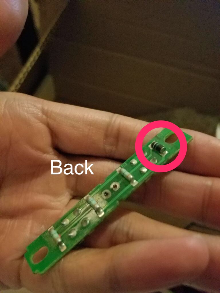

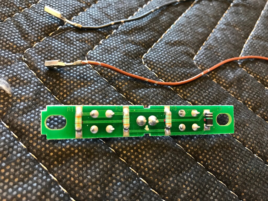

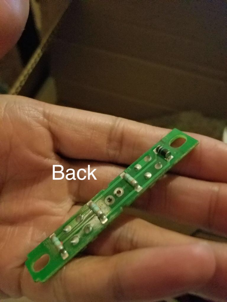

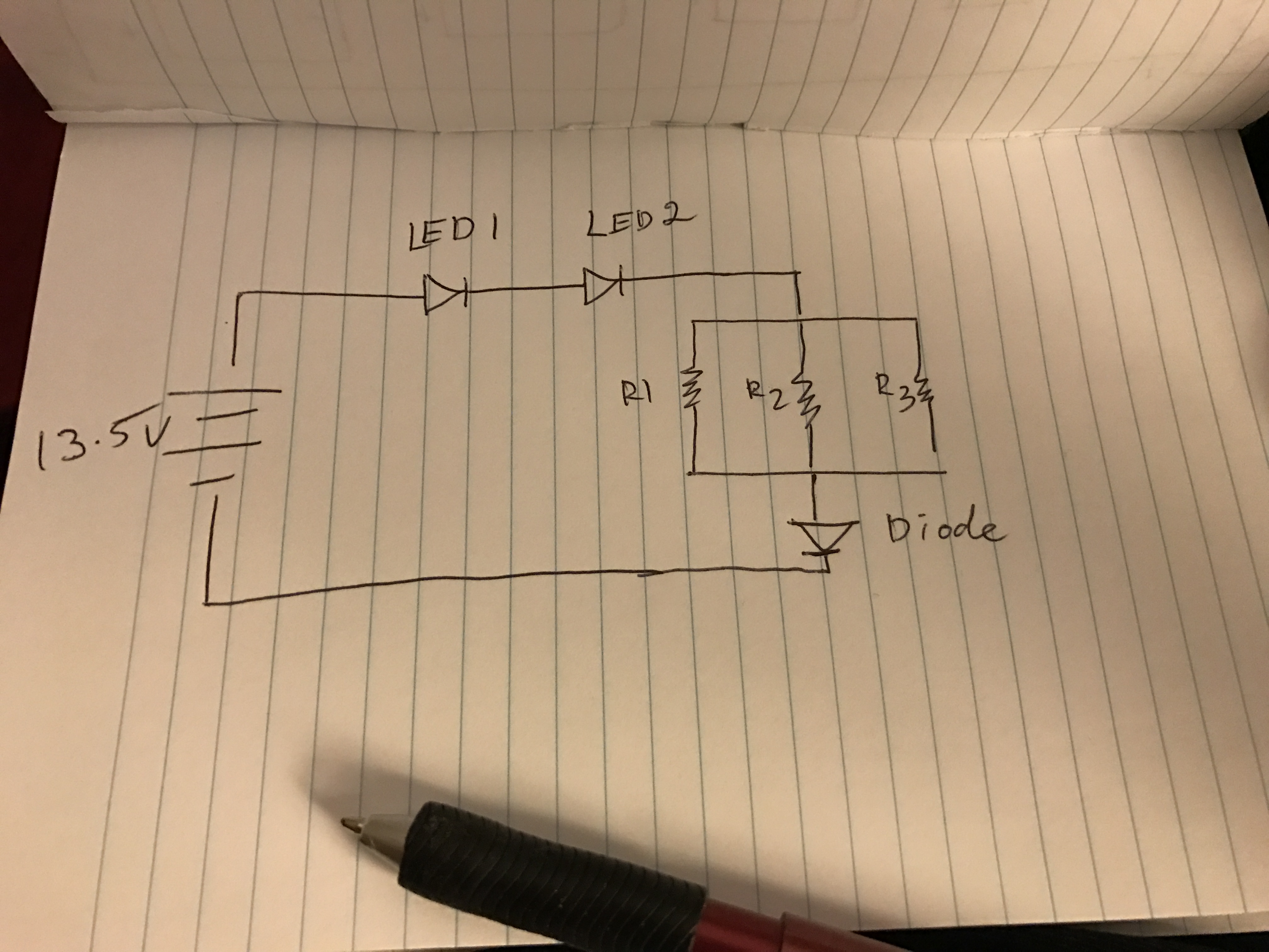

I don't see any diodes, other than the LEDs.
An Melf Diode (Metal electrode leadless face).

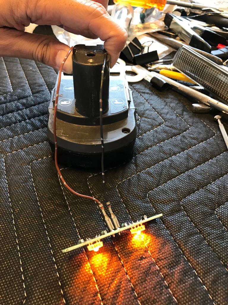

Many types of methods used to do this, multi relays (one cancels out the other on blinking) .
Reasons for the extra info, I think you may be after the LED operation including the blinking ability as well?
