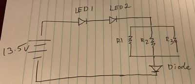

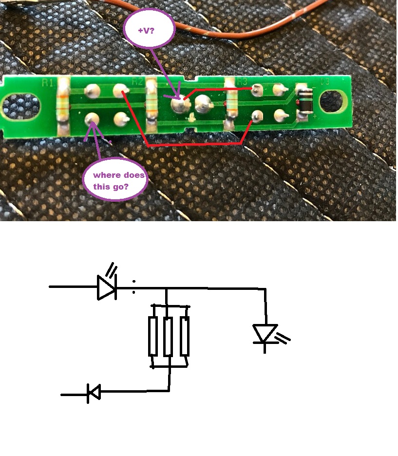

Newbie : Need help to draw schematic based on this circuit !!

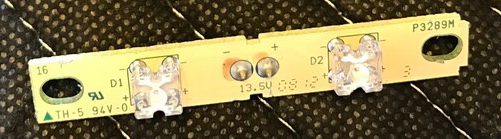

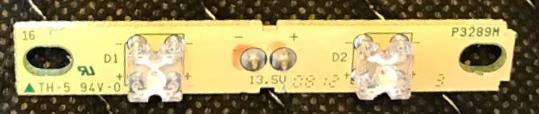

Since you are the only one with an actual module to look at, and you're in a hurry, what can you tell us about the LED that has no external connections? In the photos that are barely one day old (the ones in post #1 don't count) one of the LEDs has two pins connected together and two pins completely disconnected. And yet it lights ...

We see only half of the wiring.
Instead of guessing about which connects to what, I would get out my multimeter and measure continuity. Can't you doo dat?

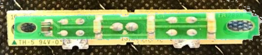

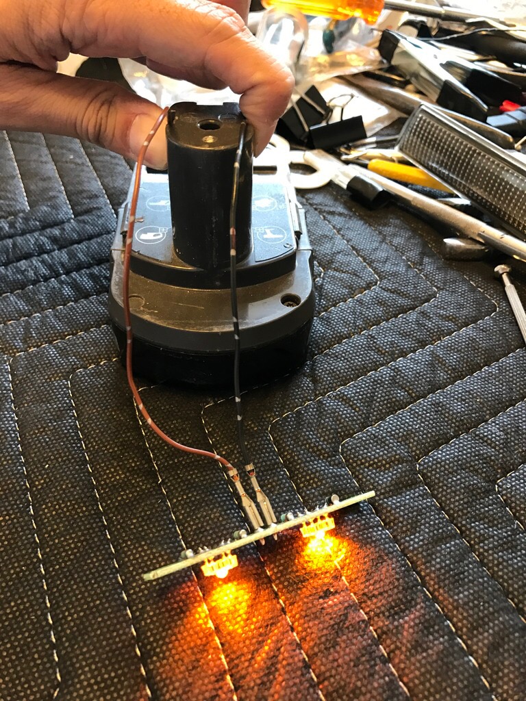

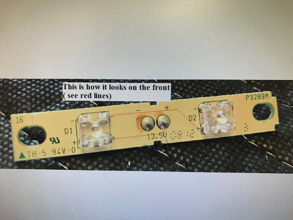

I have uploaded the front side of the circuit ..if you look at it ..the middle connections are the source ( 13.5 v ) and I don't have power supply so I decided to use my drill battery to power them up .

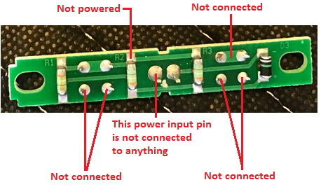

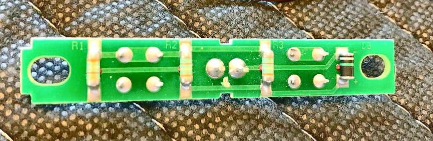

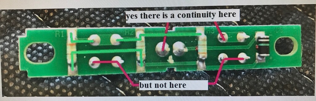

This is a guess at that only..... At best, you have the physical board their.
That board has a top layer PCB track set and a Bottom.
The top has a coating that can hide as a silk screen process making the tracks hard or just plane impossible to see.
:Theories below:

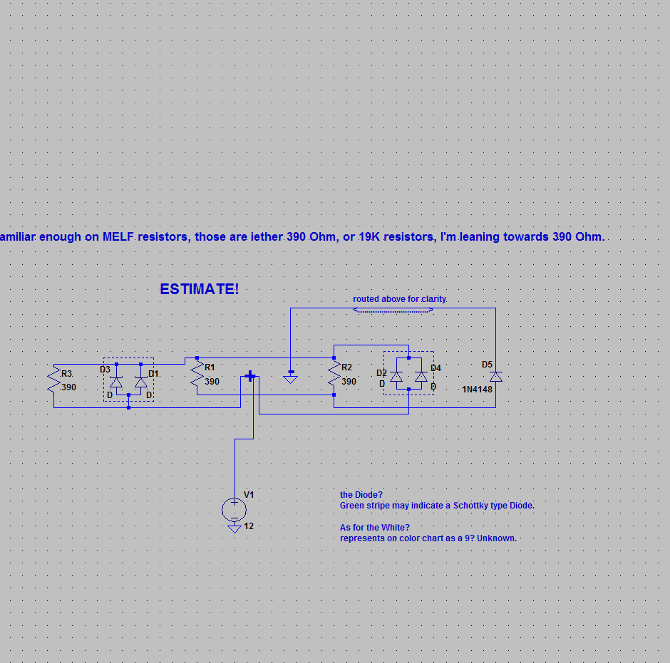

The image clipped out some text, that statement says at the left of the schematic that I am not too familiar with MELF Diodes even tho I have seen them on boards.

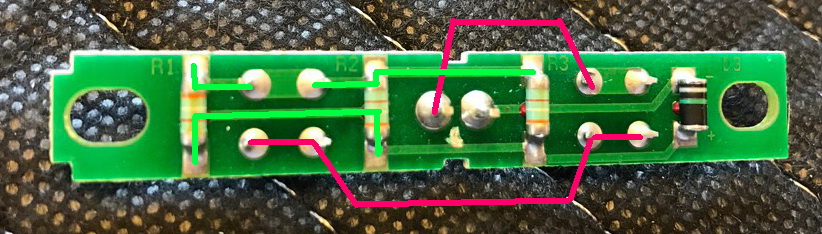

I think the OP might be correct. He thought the 3 resistors are in parallel 390//390//390=130 Ω. Then the 2 LED (actually 4 LEDs) are in series. Something like what he drew...
and this is what I saw
Green lines on component side and red lines on the LED side. (assuming double sided PCB)
Allen
It's easy to confirm. Just use an ohm meter and measure the parts linked by red line and see if there's any continuity...
Allen
I agree with the others, there do appear to be some hidden connections. It does not appear to be a 2-sided board, so I don't expect there are connections on the LED side, but there must be another layer somewhere (internal) that make the other connections. Based on the photos it is impossible to know for certain. You really need to buzz out the connections to see what is connected to what. Whoever laid out this board certainly didn't do it the way I would have done it....
My guess is that there is an internal V+ plane that connects the + side of the resistors in parallel. That doesn't explain why there aren't any visible connections to the top leads of the LED near R3. I would expect those to be connected to the top sides of the resistors, much like the LED between R1 and R2.

If you look closely at the + and - 13.5V terminals and the LED terminals. You can see that it is a double sided PCB with plate-through holes.
Allen
Allen
I don't deny that there are plated through-holes but I don't see any indication of copper connections on the LED side. Normally you would see the slight protrusion of tracks, but I don't see that at all.

Ok here are the video .. it is a double sided pcb . You can actually see the lines going across from the led1 to led 2 .
Did you notice that for diodes or LEDs to be connected in series then the (-) of one connects to the (+) of the other one?

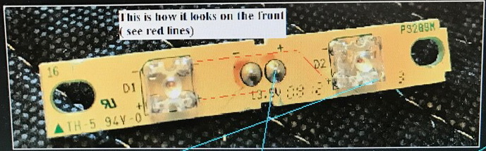

Allen

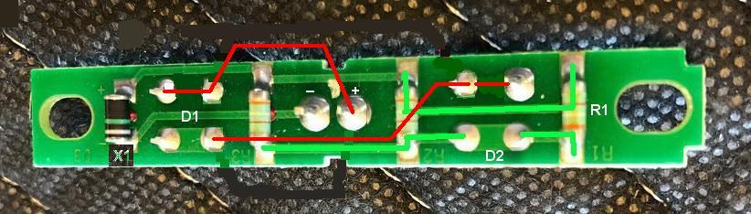

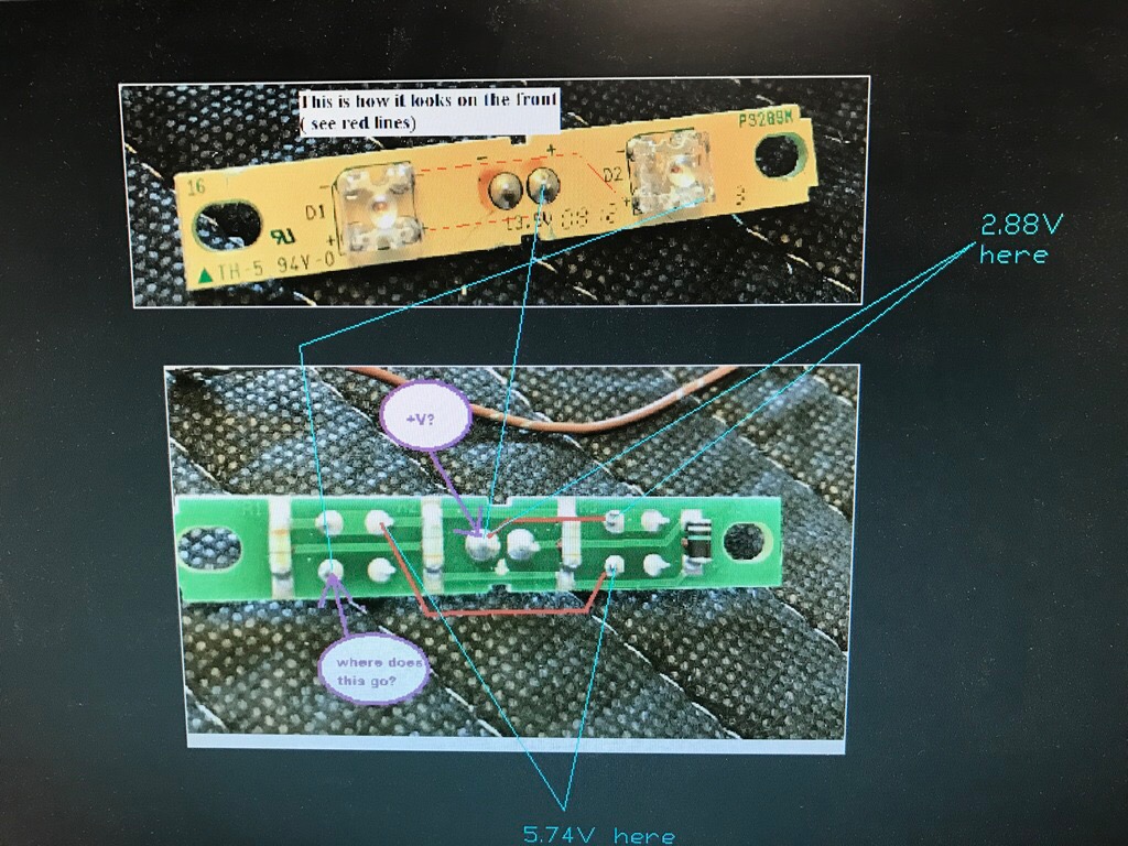

See attached
Can you confirm the red traces I've drawn on, taken from your continuity checks. Also when you say there is continuity please check its not a high impedance continuity and is ~0.1Ohm (some meters consider a 1K resistance as a connection)
Also please confirm which pin on the back in +V and answer the other point about the non-connected pins, do they go back to 0V?

The resistors do not connect to both LEDs in between them, instead the other ends of the LEDs are connected in series.
Mr. absf, if you look at the datasheet for a Luxeon Superflux LED then you will see that it has one fairly high power single LED in a package that has 4 pins to disperse the heat.
See photos
I flipped the bottom image 180° horizontally. Now the R1 + 1 and X1 all alligned with the top picture properly.
It should be correct this time.
