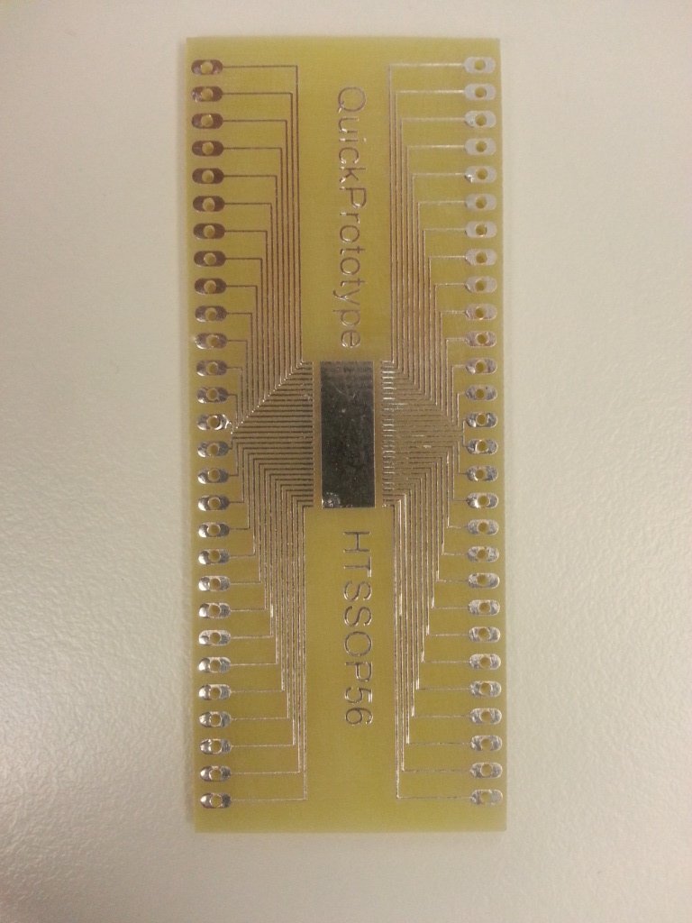

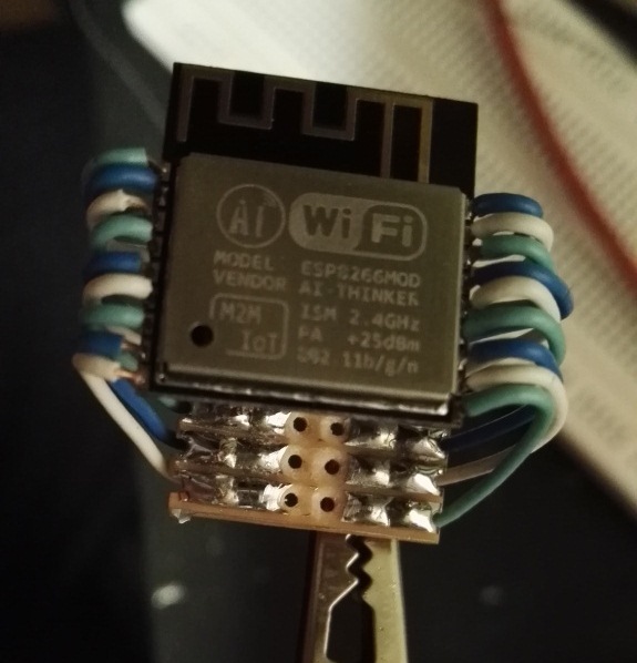

Yip, ICs are tending to invisible. As a hobbyist I have found that breakout boards and "precision" soldering are now part of life (I'm convinced I could be a surgeon)
Here's two of my recent examples:

What kind of wire did you use for the wi-fi device? I always have problems when I try this method!
Individual strands from finely stranded wire.

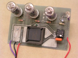

You can get through-hole sockets similar to those. I used a through hole socket for a 44 pin PLCC high voltage driver IC on my Nixie frequency counter board:
