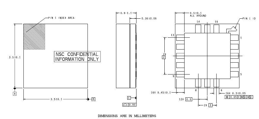

i had CSP package for National semi LMX2322. I could never use them as soldering was just impossible at home, as the pins are View attachment 98075 underneath the chip and inaccessible.
CSPs absolutely require solder paste and a reflow oven. They are physically impossible to solder by hand.

I had bought few LMX2322 that has a special package
i was never able to manage to solder them.here is the package details
Whilst I was looking for the instructable on drag soldering, I found one showing how you can solder those chips using a hot-plate:
https://www.instructables.com/id/Extreme-Surface-Mount-Soldering/
