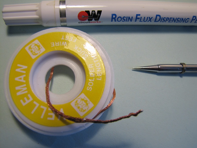

Another technique is similar, where you drag the iron across all the pins but letting the gaps between pins fill up with solder too so you end up with a solder bridge between all the pins on that side. Then, using solder wick, run the wick over the pins with the solder iron tip keeping the wick hot and that picks up all the excess solder thus removing the bridges. I have not tried this technique yet though, but have seen videos on the web. The wick has to be kept hot so it can absorb the extra solder.

I find the 63/37 solder to work very well, and if you get a bridge, just press the small iron tip between the two pins and drag it away, in a direction parallel to the pins (which means away from the chip itself). That drags the excess solder away. I saw that on the web and it worked.

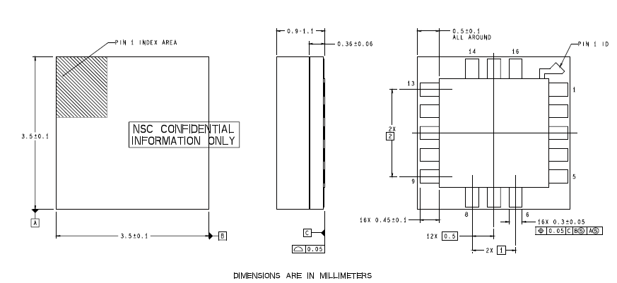

i had CSP package for National semi LMX2322. I could never use them as soldering was just impossible at home, as the pins are
underneath the chip and inaccessible.
