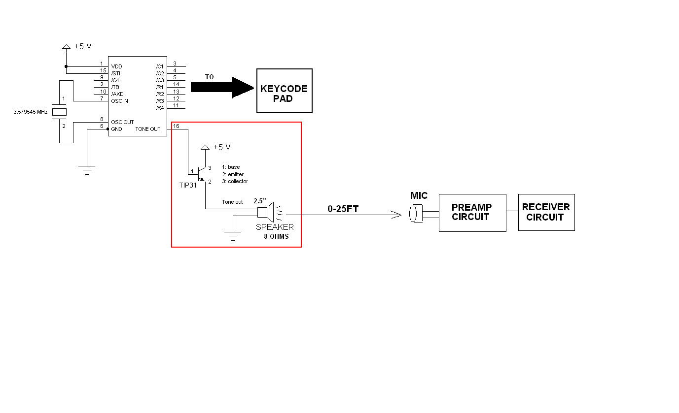

Enclosed is a diagram to a circuit I'm testing.
The red square is the part of that curcuit I need help on.
I need a amp or preamp that will in increase the out put tone comimg out on pin 16 to the TIP31 out the speaker.But the single is to waek for the mic to pick it up between 0-25ft away. I need a amp or preamp where i could control the gain ,if i need to. Maybe a circuit base on a 386 op amp or a 741 op amp might work.I need someone to help me who knows what will work for increasing the single out the speaker for the mic to pick it up a the distance i stated.The mic is either a electret mic or a magnetic mic they sell them in Radio shack .
PS Don't have experience in amplifier ciruits.

The TIP31 has an input of about 4.5V peak and has an output of about 3.7V peak.
The 2.5" speaker has a power output of about 0.86W. If it is in a proper enclosure and is fed a frequency that is high enough for it to produce loudly then a microphone can easily hear it only 25 feet away. Do not expect the tiny speaker to produce low frequency sounds.
Maybe your microphone preamp is not designed correctly.
What is the "receiver"?
EDIT:
Are the tones DTMF telephone touch-tones? They are not a crude powerful square-wave, they are a sine-wave at a fairly low output level so the single transistor is no good.
If you post the part number of the IC then we can see its output level and how much current it has.

If the supply voltage is 10V and the TIP31 feeds an 8 ohm speaker then its typical input resistance is far too low to be driven from a TP5089 IC and it will not be properly biased. The output now is nothing but low volume distortion. You need to use a power amplifier IC. With a 10V supply the max amplifier output into an 8 ohm speaker is only 0.6W so your tiny speaker will be overloaded and will not be loud.
There are hundreds of preamps for electret mics on the internet and most are the same. Post your preamp circuit and the receiver circuit.

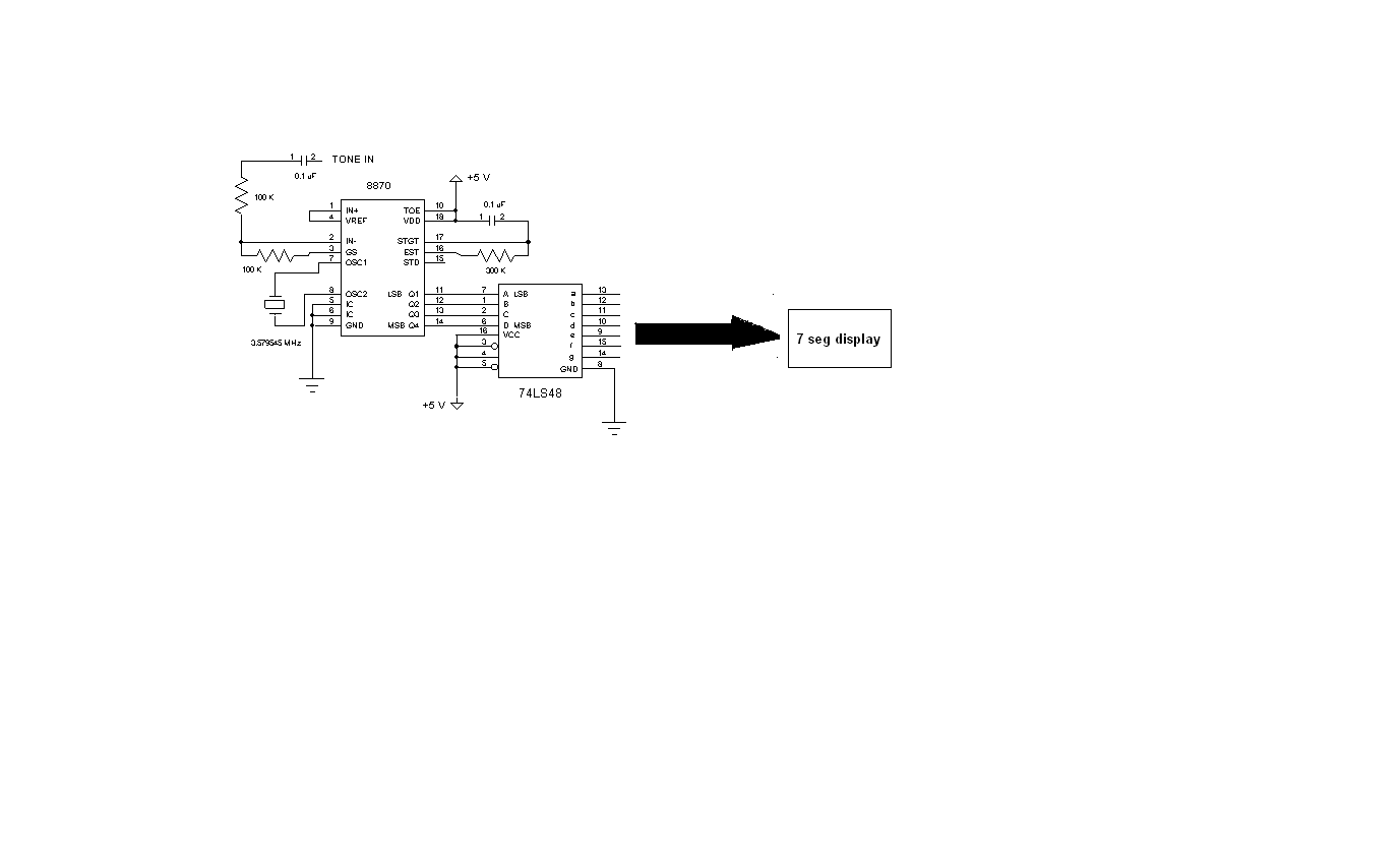

The receiver and decoder were tie together.
I want to made them independent units using a 9V battery for each unit and by using a voltage regulator to drop the voltage for the 5V for each uint that powers the circuits ICs.
I don't have a Power amp for the speaker or a Preamp for the mic I just show a Block diagram for mic. This is why i came to this forum to get help with a workable schematic for the mic side on the receiver uint. And for the power amp for speaker on the generator uint.
enclosed is the receiver side.
I don't understand what you stated in your last post about the TIP31 Feeding into the speaker.
can you supply me with a circuit for the mic on the receiver side and a power amp for the generator side this is what i need i would appreciate this.
Like i said I don't have alot experience in these amps. PLease help.
This is all the info I have on these two uints the two diagrams.

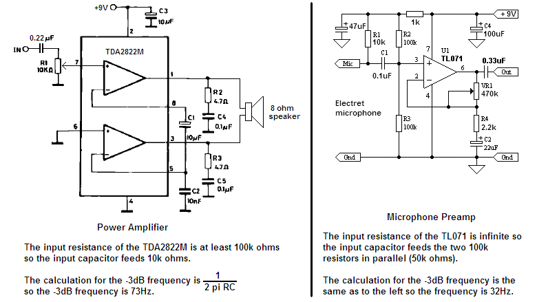

The speaker needs a power amplifier IC, not a TIP31 transistor.

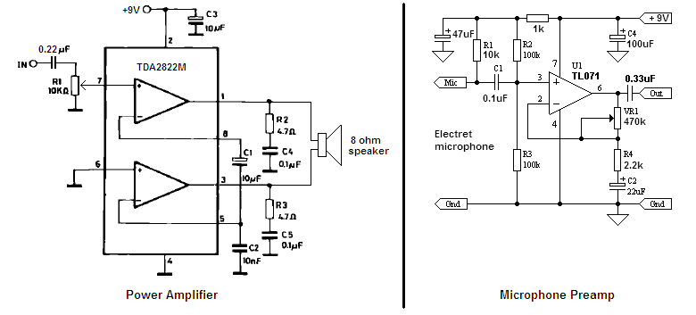

Here is a power amplifier and a mic preamp:
I have some questions about the two Amplifiers.
1.Why use the TDA2822M dual Power amp are you using one of the amps for feedback Please Explain! If you may. So i could understand this circuit.
Power amp.
2. Is this a workable circuit "meaning"' will it function (as is) if I connect the ouput of the DTMF Generator circuit to the input of the Power Amp. Not alot of experience in audio circuits so i wouldn't beable to modify the circuit.
3. I assume the gain is variable controlled throught the POT at pin 7, what is the total gain for this circuit.
4.What is the output wattage throught the speaker when the Pot is at zero gain and at maximum gain by turning the pot.
5>Do I need to use a 10k rotary POT or can i use a 15 turn 10k trimmer POT.
6. Do I use 5% carbon or 1% metal film resistors in Audio circuits.
7.Capacitors C3,C1 are electrolytic, what are the rest of them mylar, ceramic, or other. What kind are best to use in audio circuits.
8. Do I need to add any parts if so what parts would i need to add and there values before I conect the Power amp to the output on pin 16 on the Generator circuit, Or is it ready to be connected to the generators Output just the way you have it.
(I do know not to ADD TIP31 back into the circuit. This will not be used.)
1. Why use the TDA2822M dual Power amp are you using one of the amps for feedback Please Explain! If you may. So i could understand this circuit.
Power amp.
The TDA2022M amplifier I show is a working power amplifier with an output power almost 5 times the power of an LM386 amplifier because it uses two amplifiers in a bridge so the voltage swing across the speaker is doubled.
The pot is a volume control. The datasheet for the TDA2822M shows that the gain is 95.
4. What is the output wattage throught the speaker when the Pot is at zero gain and at maximum gain by turning the pot.
The output power depends on the supply voltage. With a 6V supply the minimum power is zero and the max power barely clipping is 0.9W into 8 ohms.
5. Do I need to use a 10k rotary POT or can i use a 15 turn 10k trimmer POT.
Use a single turn logarithmic (audio taper) volume control or a single turn trim pot.
5% carbon film resistors are fine.
The input coupling capacitor should be 220nF/5%/63V film type. Film capacitors are good for coupling low power audio.
C2, C4 and C5 can be ceramic type.
it is ready to be connected.
A few questions on the Mics Preamp circuit.
1. The Preamplifiers Output will be connected to the decoders Input do I need to take out any of the parts I have connected to the decodes Input. If not. I just connect the Preamps output to the decodes Input. As is. correct!
Simply connect them together.
2.What is the gain for the Preamp 20, 100, 200, or above that?
The max gain of the opamp is 1+ (470k/2.2k)= 215. The 470k pot is the gain control.
3. Why did you use the TL071 instead of say 386 0r 741, and is there a big difference in functions.
The TL071 is a low noise audio opamp. It is available everywhere, is inexpensive and works very well as a preamp.
The LM386 is a noisy power amp.
The 741 is 42 years old and has very poor audio performance because it is noisy and has poor high frequency response.

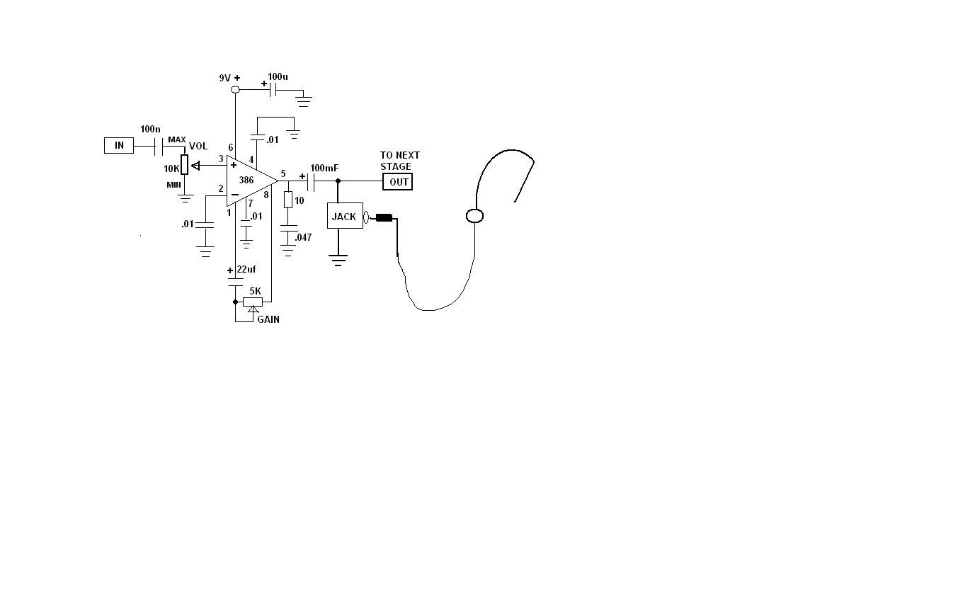

Can i add an audio plug with lead wires connected to the TLO71 Preamps Mic input that you post.
I want to test the sound coming from a handheld portable radio headphones jack, would I just take a mono or stereo plug add a wire to the plug then on the other end of the wire connect one lead to the Mics input and the other lead wire to ground,but in-keeping the Mic connected to the preamps input,but switching the Mic off when the inputs Plug is connected to the portable radios earjack.
Also I enclosed a circuit I designed. try to anyway, for post 13. Let me know if this will work for what i posted in post 12,and as you suggested i do in post 13. This is the first audio circuit i designed. Will it work for mono or stereo I might need another stage for stereo headphone. Please let me know or advise if you suggest if the vulues need to be changeD or what needs to be add to the circuit.
cyberquest
Your mono LM386 earphones amplifier will not work because its ground pin4 is not connected to ground. You might as well connect pin2 also to ground. Use two amplifiers for stereo.
The 100nF input capacitor causes a low frequency cutoff at 193Hz so there will be no bass frequencies.
If your earphones are 8 ohms then the 100uf output capacitor causes a low frequency cutoff at 200Hz so bass frequencies will again be reduced.
There is no "next stage". The preamp drives both the earphones amplifier and the decoder.
The output of a radio is about 27 times to 100 times too loud to feed the mic preamp. Use a switch to feed either the mic preamp to the volume control of the LM386 or the radio.

Ok. What size capacitor can i use and what capacitor size do you think will get those lower bass frequecies for the input capacitor, and not have to change the 10k pot.
And what size capacitor can i use to replace the 1OOuf, if my earphone are 8,16 ohms and still rececive those lower bass frequencies.
Right! there is no next stage, but there is the decoder and the driver for the 7-segment display. I just stated next stage as a reference.But thanks for pointing that out.
As for pin2 and pin4 the ground sign indicates there at ground. correct! don't i need the .01 coupling capacitors for noise. But please correct me if I'm wrong on that. but I do see your point that they should be directly to its ground state. would i still need to install those caps yes or no and where. Please advise.
I'm not understanding the last paragragh in your post how do i feed the plug coming out of the radio's earjack into the preamp by using a switch then to either the preamp to the volume control of the 386 or the radio. Can you show me this in a simple diagram so i can visualize what you mean so i can understand this better.
Think of a cutoff frequency (half-power) then use a simple calculation, don't guess wrongly.
Same as above.
Since you have two RC cutoffs then double the calculated values of both capacitors so that when combined, their total cutoff frequency is what you want.
With pin2 and pin4 connected directly to ground then the two capacitors do nothing because they are shorted.
The toggle of the two-way switch is at the volume control. the switch selects either the output of the mic preamp or the jack for the radio.

The calculation for the cutoff frequencies is simple as I show here.
The switch does not switch the microphone. It switches either the output of the mic preamp or the jack from the radio to the volume control at the input of the amplifier IC.
