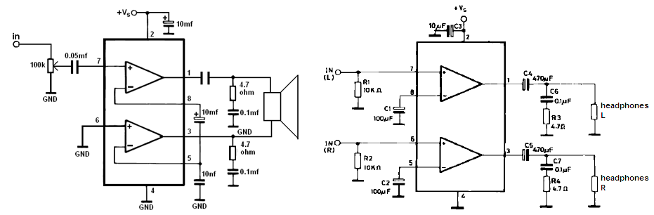

You can use one TDA2822M IC and connect it bridged to one speaker for an output of 1.1W.
Then you can use a multi-pole switch to change it to stereo for headphones.
It is easier to use a second TDA2822M and use one channel for one channel for headphones and an output coupling capacitor on the output of the bridged TDA2822M for the other channel for headphones.
Enclosed circuit
If i have the circuit setup for the one Speaker which can only be mono with one speaker. correct!
Now...How do I use the multi-pole switch, and a Headphone switch jack to made the headphnoes in stereo. Please advise.
How do i setup set for two tda2822 chip as stated in the last paragraph. Don't understand.
I'm choosing on which way i want to use either the one chip or two. So i need help with both.
It is your project, not mine so you need to think about how many things need to be switched to convert a mono bridged TDA2822M into a stereo one.

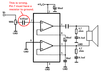

I noticed that you posted a bridged amplifier that has its input pin 7 floating without being connected to ground.

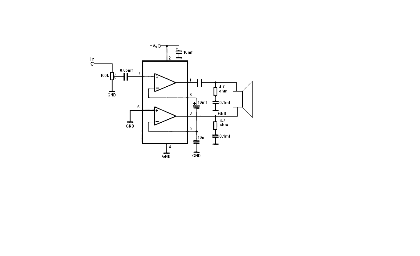

Enclosed is edit bridge circuit. kept 100k vol control pot but now resistor is directly tied to ground. Is this right!
What i think the differences are between the two circuits in post #42.
In the bridge circuit.
1. The two inverting inputs pin 8 and 5 are tie together with two 10uf caps to ground.
2. Pin 6 is tie to gound.
3. speaker added to its outputs to pins 1 and 3 . With cap on pin 1.
In the headphone circuit.
1. The to inverting inputs pin 8 is ground with 100mf cap and tie to ground the same for pin 5, But they are not tie together.
2. Pin 6 and pin 7 are your inputs. with 10k resistors.
3. pins 1 and 3 are your output this the headphones get connect to.with two 470mf caps.
I might be wrong on the differences away. but i tryed.
No.
It is wrong because you added a capacitor at the output to the speaker that you added before (and I copied without seeing the error).
No.
Pin 8 is not tied to pin 5. It has a 10uF capacitor to pin 5.
Pin 5 does not have a 10uF capacitor to ground, it is 10nF.
Yes.
No.
You made a mistake before when you added the capacitor that is not shown on the datasheet.
1. The two inverting inputs pin 8 is ground with 100mf cap and tie to ground the same for pin 5, But they are not tie together.
No.
They have 100uF to ground, not 100mF.
No.
Pins 7 and 6 are the inputs.
Yes.

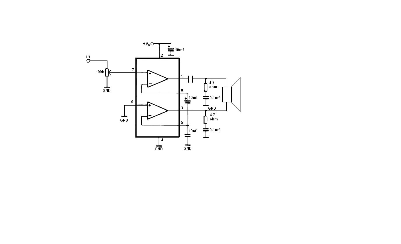

audioguru.
I Revised circuits enclosed.
Will the two circuits work now, as is.
All I did was delete the two caps on the input and output on the amp, so pretty much, its the same circuit as in the datasheet in figure 2.
As for the Headphone amp I just add the 100k volume pot and headphone Jack.

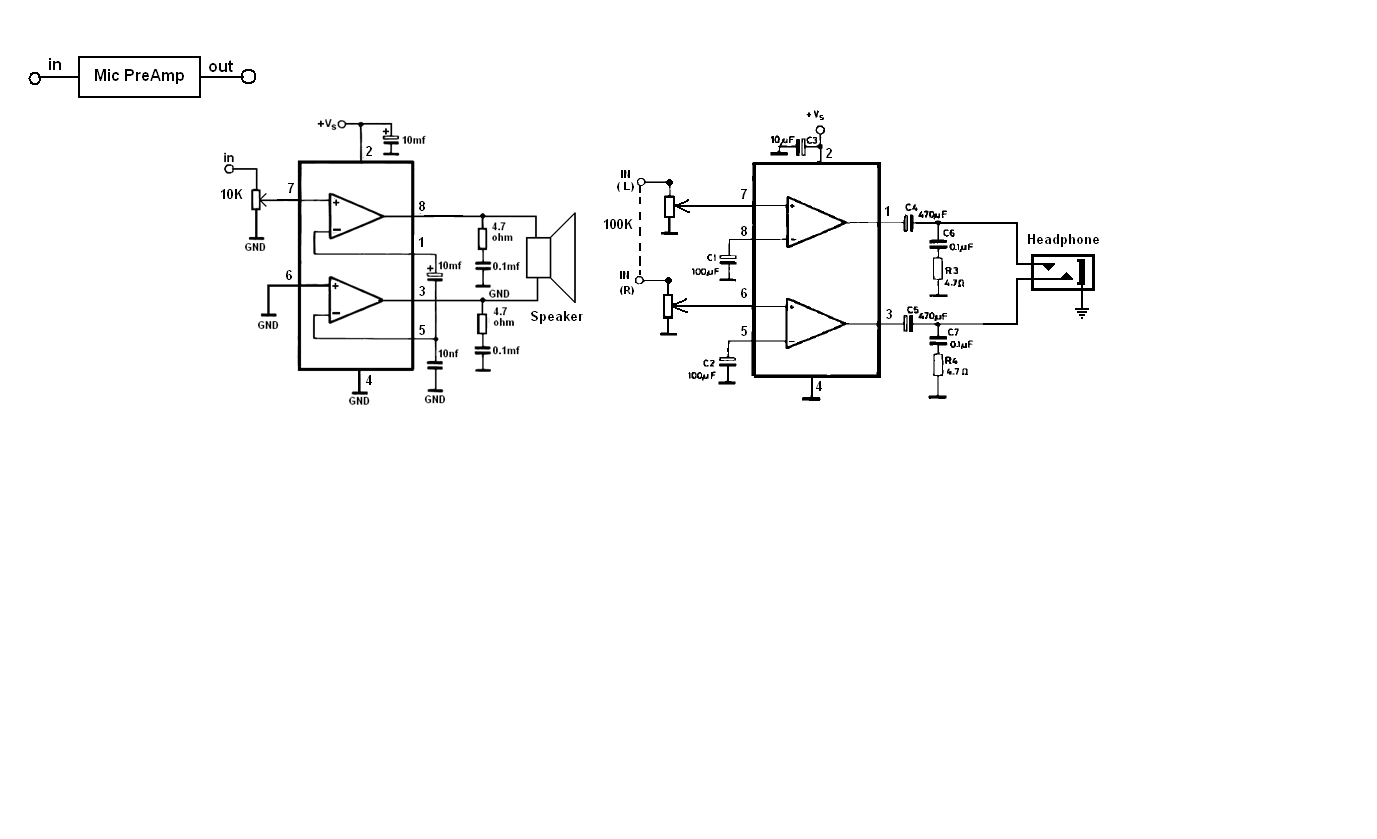

I think I figured out how to connect both circuits with the preamp by using a multi-switch.
Now.As for the multi-switch you mention i think i would need a 4PDT type I may not find one as you stated, but some places do have them. But I must Order a minmum of 100 like at digikey. So I'll use two DPDT switches. I may need to use one SPDT switch for the Plug to switch back & fourth between the radios ear jack output and the preamps output.

In post #49.
4.Also. Where would be the apporpriate placement to connect the plug to the switch back and fourth between the mics preamp output and to the radios output jack... Between the PreAmp and the headphone input then to the input of the speaker amp. OR between the PreAmp and the speakers amps input, then to the input of the headphones. Or dose it matter how its connected either way.
1. The vol control pots for both circuits that I have are rated at 1/4W,will they be enough wattage in both circuits?
Simply calculate the power in the pots. The TDA2822m has a max output of 1.4V RMS and a gain of 95. Then its max input is 1.4V/95= 15mV. The dissipation in each pot is 15mV squared/10k or 100k= almost nothing.
2. Will the headpone amplifier circuit drive my 8ohm pair headphones with decent sound or will the sound be low at maximum volume.
It will be very clear and very loud at max volume.
3. I couldn't fine where it states the temperture in a bridge circuit at 8ohm load how hot the IC would get, do you know the page number where its at?
The "Total Power Dissipation versus Output Power (Bridge)" graph on page 6 of the datasheet shows a dissipation of almost 1W when the supply is 6V and the output power is 1.1W into 8 ohms.
The second page says that the max allowed dissipation is 1.4W when the case is 50 degrees C. The thermal resistance is shown so you can calculate the exact chip temperature.
4. Where would be the apporpriate placement to connect the plug to the switch back and fourth between the mics preamp output and to the radios output jack... Between the PreAmp and the headphone input then to the input of the speaker amp. OR between the PreAmp and the speakers amps input, then to the input of the headphones. Or dose it matter how its connected either way.
The toggle of the switch connects to the input of the volume control.
The switch is a On-off-On. So your saying the toggle is the off position the center lug the volume control input gets connect to that center lug so i could switch to On for premp circuit and in the opposite On position would be connected to the speaker circuit. Is this Right!
Because if I was to connect to one Of the On lugs it would always be in the On position. correct!
I think the connections will be confusing abit but I'll work on it.
The switch should have only two positions and not have a 3rd position in the middle when it is off.
1.Why can't I use a On-Off -On position type of switch, to switch between the two circuits and between the preamp and the radio plug.
2.So your saying, all's i need is a On-On position type of switch. I don't need center off position on the switch to switch back and fourth between the circuits
3.Only the power switch will have two positions On/Off
4.Also> I forgot to mention.
In the two circuits the TDa2822M bridge circuit and the headphone circuit what is the total current draw for both circuits. operating current drawn from the battery.100mA,200mA or more.
Only two positions: 1) The radio or MP3 player. 2) The microphone preamp.

The circuits in post #42 have two capacitors that you added by mistake. The circuits in post #49 are correct and have good low frequency response.
