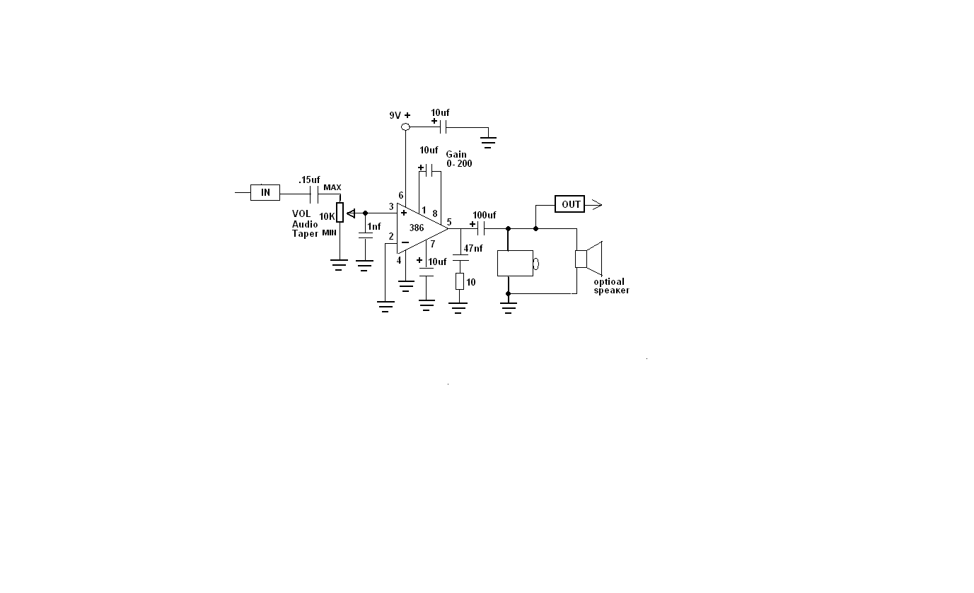

Will this diagram work for my project.
Enclosed is a revised diagram that i inposted in post 14 the cut-frequency now is 106hz with the input cap and 10k pot for the input.
Will output have the same cut-off frequency. or not. I tryed to calculate for the output but couldn't get the right capacitor can i use the same cap for the output or will it need to be half the vulue then the input capacitor. Any suggestions.

You don't need the capacitor between pin1 and pin8 of the LM386 because a gain of 200 is way too much.
The 100uF capacitor will cause a cutoff frequency of 200Hz at the output of the amplifier and the 107Hz cutoff at the input will cause the total cutoff frequency to be higher. The result will be squeaky sound and no bass. Are your speakers tiny? Why? Don't you like good sound?
OK . Then how much gain would I need if 200 is way to much. 20,30 50 0r 100. because a gain of 20 or 26dB might be to low. I need some adjustment if the sound is to low.
The .15uf capacitor with the 10k dose give a cut-frequency of 106.1hz. thats what it calculator out too.Did you round it out to 107hz, And yes I do like good sound?
Idid get a cut-off frequency of 99.47hz on the output by calculating with a .16uf with the 10k pot.
So what capacitor do i use on the output. for a 100hz cut-off fq as you suggested in post #23. Or like I said,would the capacitor I use be half its vulue of its input capacitor to get me the same output cut-off Fq as the input.
If i keep the .15uf for the input and the same capacitor on the output would it give me the same cut-off frequency on the output. Or would i need to take the
.15uf and divde that in half which will make the two caps .075 for the input and for the output. Because I having trouble calculating for the out put cut-off fq to match the input.

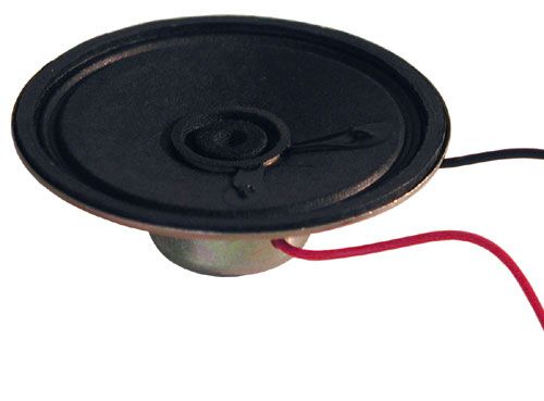

Yes my speaker are tiny( to keep the project small ) its only 2-1/4'' round speaker for the generator side for my project as posted in post #1.The LM386 will use the same speaker for sound that will come from a portable radio or from the Dtmf generator 25ft or more away from the Mic preamp. I'm not biulding a Hi Fi expensive stereo system.But I would like desent clear sound.
Enclosed photo. This is the size speaker Im using its 2 1/4'' round 8 ohms 86dB .5Ws
The reason for the size is keep the project small.
Dose it matter the size of the speaker.
It the size of a portable FM/AM radio speaker.
And some do have good sound. What would be a reasonable size to use. and i don't think the size is going to matter for a portable radio sound quality.
There is a speaker I seen at digikey 71mmX40.10mmX25mm which puts out 3W max rated 5W 8 ohms 86dB 100hz-20khz would that speaker make a big diffrence in sound quality. And have the low bass frequencies.

It would sure help with volume, but the enclosure itself is going to play a huge part of how good the audio sounds. If you're limiting yourself to a tiny enclosure just big enough to fit the speaker all yer gonna get out of it is tiny sound. To get any kind of half decent bass or even decent mids you need a relatively large cavity with bass ports.
Use a 10k trimpot in series with the capacitor across pins 1 and 8 of the LM386 for adjustable gain.
Your cheap little speaker will just make squeaking sounds with no bass frequencies.

Your cheap tiny speaker will not have decent sound. It will not have any bass frequencies below about 300Hz. This little speaker will not sound too bad: https://www.fostexinternational.com/docs/speaker_comp/pdf/ff85k.pdf
