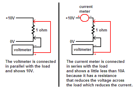

Way back in post #2 I provided the OP a little cartoon. I clearly show the load voltage measured across the load. I subsequently mentioned the voltage measured at the source and across the load will not be the same. This is because of the burden voltage drop of the ammeter. The object of this exercise in futility ( :) ) is to get the OP to understand what is going on.
Since the OP is using DMMs I did this little science experiment using some DMMs. I used a pair of identical Fluke 87 DMMs. The power source was a Lambda Model LP-532-FM 0 to 40 volt and 0 to 3 amp supply. Now as to the 100 Ohm resistor I took that seriously and coincidentally inline with what KISS mentions:

the problem got corrected by measuring the voltage across the resistor... exactly as
it mentioned above and not at the power supply, now the results from most multimeters
match the result from my calculations.
it was so simple...
This is fun stuff huh? </EDIT>

sorry, but i can't understand that. What do u mean with i should measure the current in series? Please explain
Note the drawing in post #2 of this thread. It shows the current meter in series and the voltmeter in parallel with the load.
Ron

Here is another sketch of a voltmeter and a current meter:
