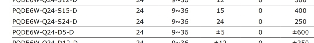

PQDE6W-Q110-S24
...thanks, but this one cant do our 12vin.
Oops. Sorry, wrong part number.
