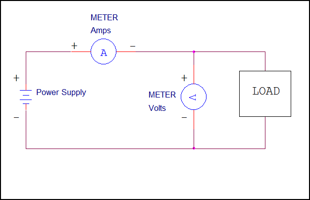

You are measuring the current placing the meter in series with and not across the load correct?
<EDIT> Like the attached image? </EDIT>

To recheck what others have asked, and to which your answers haven't really been clear enough, you do have TWO meters connected at all times? - an ammeter in series with the load, and a voltage directly across the load (and only the load).
Incidently, this check is how you would accurately measure the resistance of the load.
My fairly expensive Fluke digital multimeter calls the voltage loss caused by its current-sensing resistors its "burden voltage". It is 11mV/mA for low currents up to 40mA and is 30mV/A for high currents up to 10A. It can measure up to 20A for 30 seconds max.
EDIT: I forgot to say that the test leads and probes add additional resistance that reduces the current.
**** Ron raises his hand with another question****
When you measure the voltage exactly where are you measuring it? Upstream of the current meter at the actual source or downstream of the current meter as in right across the load? Try measuring the voltage both ways, across the source and across the load, let's see if there is a difference? :)

No what I asked you to try (think experiment here) is measure the voltage both at the source and at the load. Think about what AG mentioned about the burden resistance of the ammeter, also if you look back at the image I posted the voltage is measured downstream of the ammeter. There is actually a lesson in this and the numbers will work out correctly. Measure the voltage across the supply and then the load and note the difference. :)

the problem got corrected by measuring the voltage across the resistor... exactly as
it mentioned above and not at the power supply, now the results from most multimeters
match the result from my calculations.
it was so simple...
thanks!
