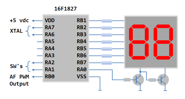

Here is what I need it to do. I have a 6 position dip switch and want to be able to cycle through all the available combinations from all off to all on using just 2 push buttons (one to move forward and one to move backwards).

If I have to program, I would add an LCD display, so I would need a larger chip.
Unless you have used LCD GLASS (they lack controllers) it is much easier to use a run of the mill LCD display and have the PIC talk to it.
EDIT: If you plan on making enough of these where there would be a cost savings using the LCD glass. For one or two units it is not worth the work.
I want you to know that I am not pushing you in the direction of using a PIC. Unless you are setup for and know how to program them the effort will be considerably more then the other solution.
Yes, I realize that. I am somewhat familiar with C. I have a pic programmer. I modified a couple of basic pic programs in the past, but nothing to this extent. It would be an educational project, but would take me far (or should I say far far!) longer to do that soldering a few components to a board. I am likely going to do both. I'll probably do the logic version first as I am attempting to write the pic version.
Actually you wouldn't need a larger chip. It takes 8 pins to drive a 2-digit 7-segment display and it takes 6 pins to drive a standard HD44780 LCD display.
Thanks. I hadn't made it to the point of figuring out chip size and just assumed I would need larger from other projects I saw using LCD and PIC. It will take me a while to write anything like this.
