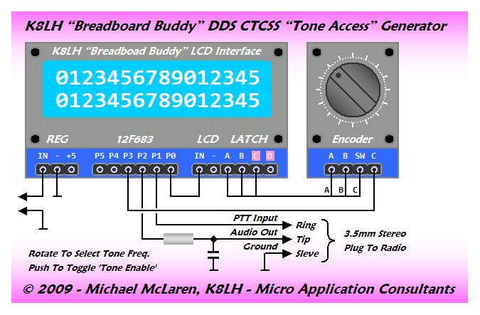

If you know how to program PICs, why not generate the state counter and even the CTCSS tones inside the PIC? That way you could use a rotary encoder like the frequency knob on your radio to cause the PIC to select which tone.

Can you pass along a link for that PIC solution, please? I have a PIC solution of my own design so I'm interested to see what someone else has come up with...
Regards, Mike
Regards, Mike
