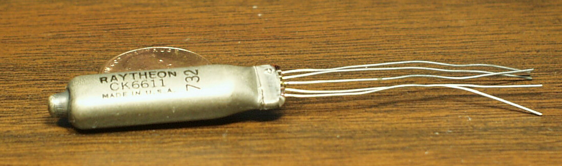

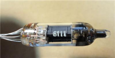

What is actually 6 and 10 mm long? Diameter seems to be 10.
If no sockets, how were they assembled? Soldered straight to the PCB?
Hy atferrari,
Here is a data sheet with the dimensions for a similar valve (tube). The envelope cross section is not round but oval.
http://frank.pocnet.net/sheets/201/5/512AX.pdf
The cross section of some sub miniature valves with glass envelopes were round though.

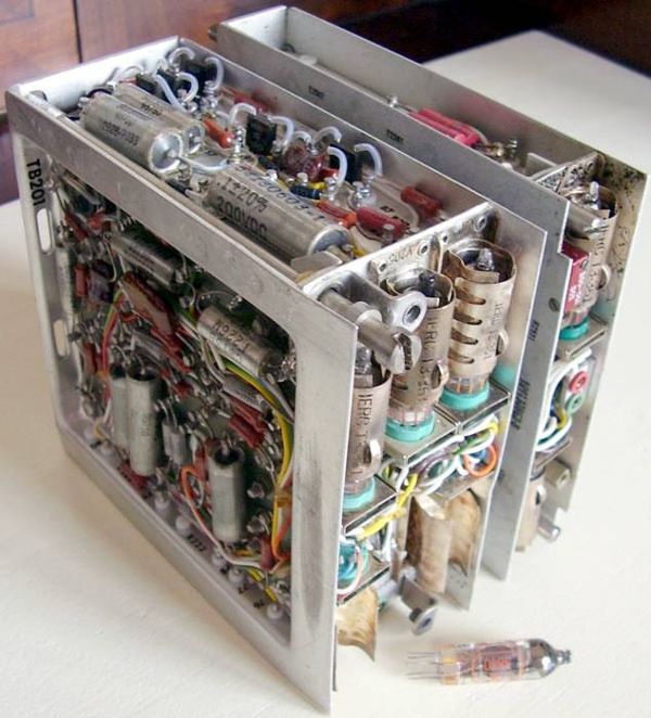

Yes, the leads were soldered to tag strips- what are PCBs :joyful:
For airborne equipment, the body of the valves were either secured by a metal clip or for glass enveloped valves by s metal sheath that covered the length of the valve, presumably for screening and heat sinking. Not sub miniature valves but showing the type of valve sheath/clips and the type on construction before PCBs:

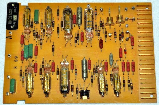

Vacuum tube were used in some digital devices designed in the 50's until the 1990's. One type of device was the KW(RT)-37. The decoding unit used 500 subminiature vacuum tubes (three for each flip-flop.) in its digital logic circuits. I actually repaired a few Navy operational units in the early 80's. It was pretty amazing seeing a digital fibonacci series generator made from 1950's tube circuits.

Very interesting post nsaspook. A lot of the Royal Air Force airborne equipment of the 1950s to 1980s used sub miniature valves, especially if it was US sourced. The techies were not too keen on soldered in valves because it made servicing difficult.

This is a KWR-37 unclassified
VV card.
tubes
3 JAN6088
6 JAN6418
To the best of my knowledge the internals and schematics of this device are still classified so what little details I still remember about it have to stay under wraps but it was in service for so long simply because it worked under the most adverse conditions possible and was effectively nuclear EMP hardened because launch code EAM messages were sent on this channel.

Most problems could be fixed with a good old fashioned rubber mallet tap to the case.
It's been a very long time since I saw a top hat style diode....... Thanks nsaspook.
Looks like three transistors snuck on to the board.....
When PCBs first came out the quality was awful. Ten-to-one, if you removed a component the trace would lift. On the tag strip layouts changing a component was a dream especially valves which just plugged in. But one problem was that if you removed any wires you could forget where they came from. Also there was no unified layout scheme so accessibility was a nightmare. The first rationalised equipment I saw was American TACAN. It was streets ahead of anything else and that applied to the manuals too.
