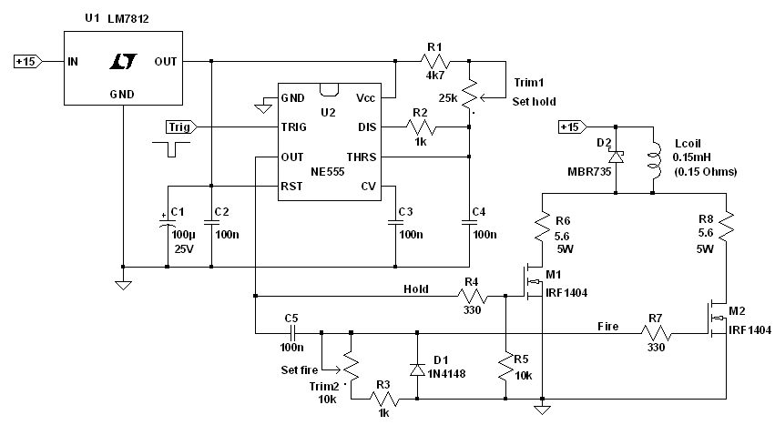

Following up earlier suggestions to use a 555 timer rather than CMOS, here's how I'd do it:
This uses a single 555 monostable to define the hold period (adjustable), and an R-C differentiator to define the fire period (adjustable).

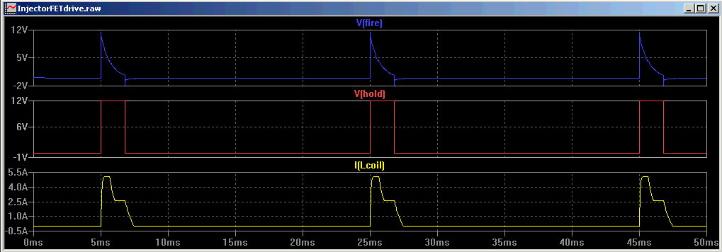

The relevant waveforms are:
Note that the Fire and Hold pulses are shown as 12V because an ideal 555 was modelled in the sim. In practice the voltage out from a 555 would be closer to 10V than 12V.
Edit: A 5.6Ω resistor in series with Schottky diode D2 will reduce the switch-off time of the injector pulse.

§42. the 555 circuit.
Thank you. Most interesting
You say: Note that the Fire and Hold pulses are shown as 12V because an ideal 555 was modelled in the sim. In practice the voltage out from a 555 would be closer to 10V than 12V.
1) would this reduction in V mean a lower current would go thro' the FETs? Should it be remodelled slightly? We need about 4.5 A for Fire, half that for Hold.
2) The sim looks very impressive. Presumably the Fire period could be reduced if C5 was smaller.
3) Presumably the timed "Hold" pulse from the 555 can be shortened to go to Fire (near bottom of scheme) because of the C5 and smaller Trim2.
4) The different currents for Fire and Hold in the 15 v circuit are because the Vgs is different because of the voltage divider for Hold?
The datasheet for an LM555 shows that with a 12V supply its typical output is +10.7V into the 330 and 10k series resistors. Then the gate of the Mosfet gets +10.3V.
The datasheet of the modern IRF1404 Mosfet shows that with Vgs at 10V its on resistance is typically only 0.0035 ohms which is less than a piece of thick copper wire.
Since an injector is 0.15 ohms the single 5.6 ohm resistor in series provides a current of 15V/(0.0035 ohms + 0.15 ohms = 5.6 ohms)= 2.6A for hold and two Mosfets and 5.6 ohm resistors provide 5.6A for fire.
correct.
C5 with trim2 and R3 shorten the pulse from the 555.
No.
Hold uses a single Mosfet and 5.6 ohm resistor. Fire has both Mosfets and 5.6 ohm resistors for twice the current.
The trimmers T1 and T2 are adjustable to allow both the Fire and Hold periods to be shortened (or lengthened) independently as required.
Edit: The minimum effective Fire period is limited not by the Trimmer/capacitor but by the rate of rise of current in the inductor (coil). That rate can be increased only by reducing the inductance (not possible without using a different injector) or increasing the supply voltage above 15V.
Edit2: With both trimmers set to minimise pulse width here is what should be attainable with C5 as is.

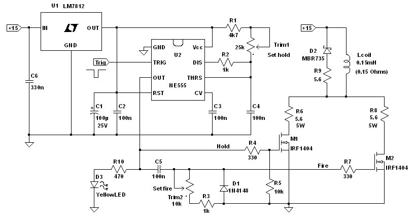

On the circuit, post 42, could I put an LED between R4 and R5 ?
On the original circuit, a flashing LED is very useful.
Not the best place to put one. Here's a revised circuit with the LED (D3, your colour choice) connected to the 555 output via a current-limiting resistor R10. Note also added components C6 and R9. C6 and C2 should be connected close to the in and out pins, respectively, of the 7812 regulator. R9 helps to shorten the tails of the Fire and Hold pulses while keeping the FET drain voltage below its rated maximum.
Edit: The circuit shows the FETs as IRF1404, but many other suitable (Rds_on <50mV, Vds >=40V) FETs are available.

The switching time of the FETS can be improved by using a low side driver chip to amplify the gate current as the 555 drive current is limited. This might improve the time by 50 to a 100 nanoseconds depending on the total gate charge of the MOSFETs used.
Charge Q= As (amp seconds), thus s= Q/A; Total Gate Charge over avg Current. More current = less time.
An MCP1407 driver chip comes to mind.

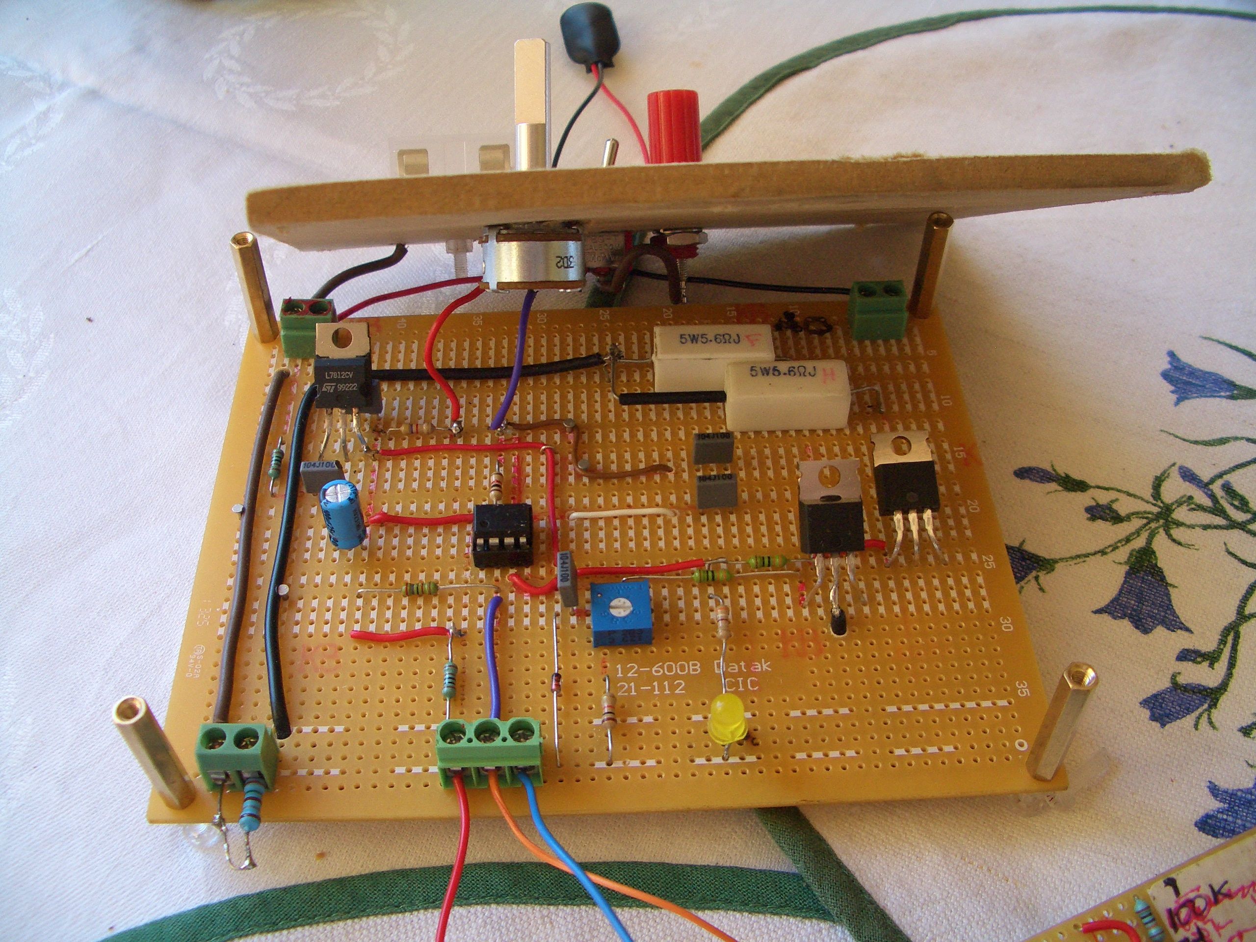

I take it you built the same circuit in the schematic?
1) You can trace backwards. Verify that the 555 isn't putting out the pulse. 2) Then verify if the Capacitor C4 isn't doing a charge/discharge cycle.
If (1) is good then the prob is in the area of the gate drive of the MOSFET or the MOST fet connections (Drain /source switched)
If 1 is bad and 2 is good then check the other 555 connections and then swap the capacitor and then the 555 if the cap swap doesn't fix it.. However, I have never seen a bad 555 yet.
1) Yes
2) I think it'll be OK. Don't have quite the same "feel" for the 555 as I developed for the 4013 and 4093 but I'll report.
Thanx for interest tho'
Hello:
The 555 circuit is beautiful. I've delayed replying because I've been "shut out" of the Mech Eng workshop while they deal with real customers. So I bought a finicky Salea device and confirmed Alec_t's timing (if not voltage). I made a little 555 oscillator (circuit found on the Web) to run at "1500 rpm". The Yellow LED flickers.
I show the picture.
But the reason I write is:
On the schematic, the RST is linked to the 12 V input, but not to the timer circuit. Is that how it works???? The timed output ENDS and the RST just comes back into play?
