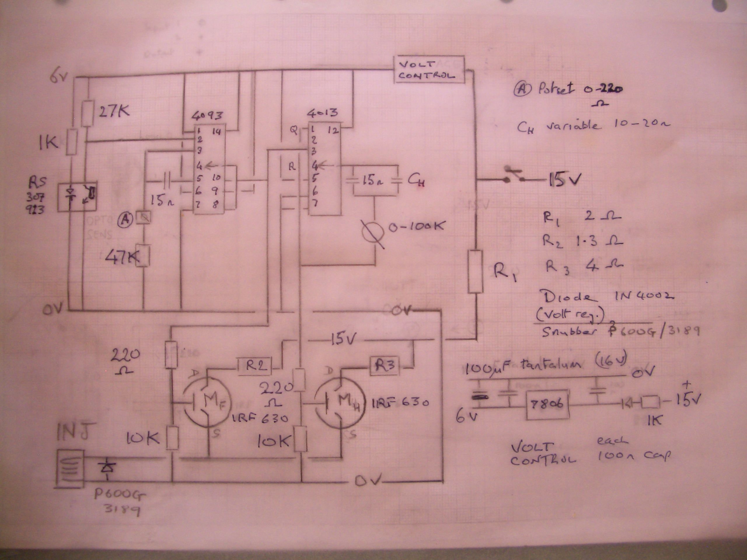

Is this good enough? I can't do the nice diagrams that appear here.
From Left to Right, the Optosensor is an RS 307913. The SetPot (A) can be regarded as Zero R, the little Cap 15 n.
The 4093 Pins 1, 6, 9, 14 get ~6 v. Pin 2 gets the ragged Low signal from the Optosensor, Pin 3 > Pin 5 via RC. Pin 4 feeds to Pin 8.
Pin 10 is the timed sq wave output, to both FETs (fire and hold) and then to the 4013 (Pin 3, clk).
The 4013 Pins 5, 12 get ~ 6 v.
Pin 1 (Q) goes to FET (hold) only. It is linked to Pin 4 (R) via two caps in parallel (use 15 + 10 n), via a potentiometer (0-100k) which is the "accelerator." Pins 6, 7 go to O v.
The Power resistors for the 15 V circuit are 2R0 in common to the FETs, then 1R3 to FET (fire) and 4R0 to FET (hold); eg 1R3 means 1.3 ohm.
The coil has an Inductance 0.15 mH, impedance 0.15 ohm.
The little diode to the voltage regulator 7806 is an IN4002 after a 1K resistor. The ordinary caps either side of the 7806 are 100n, and the Tantalum cap is 100 microfarads (16 V). (I have no idea what this is for!).
It appears that your opto input and output share a common ground and that it is fed by the common 6V supply, which means it is always 'on' and serves no purpose.
It does seem to me that a oneshot 555 timer pulse driving both MOSFETS with an RC on the 'Fire' FET for shorter response might be simpler.

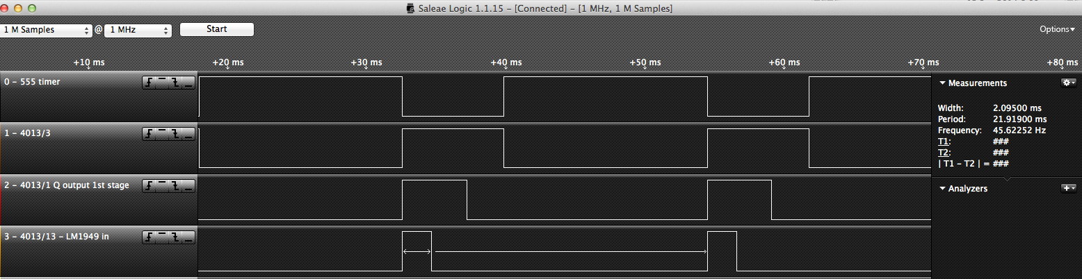

Here is what we got using a 555 pulse generator. It was a different set-up but we fed in Low pulses at about 2700 rpm.

Your Mosfets are source-followers instead of switches. For the source to be near +15V then the gate must be +25V which is not going to happen with your +6V logic supply.
I don't think this design is worth 'fixing' . 4000 series CMOS don't have voltage clamping on their pins and tend to fail in high transient environments.

The IRF630 is not ideal for this job, since it needs a Vgs of ~10V to get its Rds(on) down to 0.4V. It is likely to run hot with Vgs = 6V and Ids = 5A.

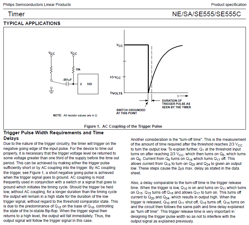

(Looking at the 555 page, I have no idea what units they talk about with frequency - I presume Hz - but its just numbers - where the 1.44 comes from is unclear - and it doesn't tell where to Put In my low signal from the RS optosensor. Is it Pin 7?)
The datasheet for a 555 shows the formula for its resistor A and its timing capacitor to be 1.1 x R x C= t (in seconds), for the 555 to be a monostable that you want. The 1.44 number in a formula is used with two resistors and a timing capacitor when it is an oscillator (in Hz) that you do not want.
The monostable will not time out when its trigger input pin 2 is held low too long so a coupling capacitor is in series with pin 2 to apply a short duration trigger then pin 2 goes high and allows a time out.
Here is a description of a coupling capacitor feeding the trigger input pin 2:

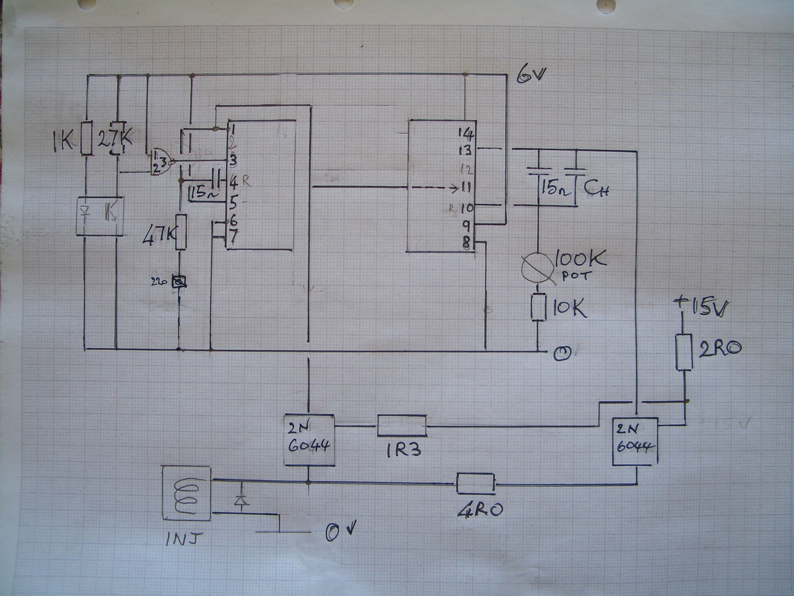

§31, MOSAIC can you see if this works in your simulation? You'd have to ignore the RS307913 and just feed in a Low pulse (logic 0) at some frequency eg 40 Hz..
This timer control works on the Original Circuit (vintage 2004).
The 4039 is shown as a single Gate (on the LHS) and the 4013 is used for each Power pulse (one fixed, the other variable). As before, use 10 n for the variable cap, Ch.
On the Original Circuit, there's a damper with a link to ground via a BDA33, base to Pin 12 (Q bar) via 10k resistor. But I haven't drawn that in.
I apologise for not using the 555 but I know the timer is OK, so am more comfortable with it.

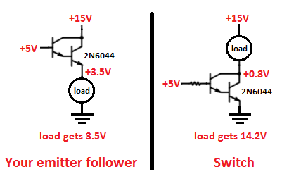

Your new schematic (?) has two rectangles (ICs?) with no part numbers. Another problem is that the base, emitter and collector pins are not shown on the 2N6044 NPN darlington transistors.
Maybe you are using the 2n6044 darlington transistors as emitter followers, instead of as switches. Then when the base is driven up to maybe +5V the emitter is only about +3.5V or a little less.

With the original set up, the "return" from the inj (the coil works a ferrite plate, so is polarised) goes to the current source O v (as if to engine block, hence to battery, but in our case, not involving engine at all). (In the LM1949 circuit, considered but not used, the coil is "at the beginning of the line" with the power control to ground coming after, ie "downstream" ).
That is true here (except its not built).
We would always keep the circuit in its own discreet loop, away from anything else, electric power source included. So the appropriate terminal is permanently O v but not randomly to "earth".
Of course, the diode is attached (but we found only 6 v kickback and MOSAIC estimated 4 v).
§35 Sorry: the rectangles are each side of a 4013, which worked well in our original circuit.
The little gate to the left is a 4093.
As for the Darlingtons, the 15 V source coming in at the RHS in each case (via a power resistor), is to the main Collector. The 6 v source coming in at the top, in each case, is to the Base of the controlling BJT.
In haste I have drawn the Darlingtons the wrong side. It should be as you show in your RH drawing. Thank you!
(In the LM1949 circuit, considered but not used, the coil is "at the beginning of the line" with the power control to ground coming after, ie "downstream" ). That is true here (except its not built).
That is the preferred arrangement (for simpler switching) and is why I asked the question in post #36. However, it's not what your schematic shows. You show the injector downstream of the Darlington.
