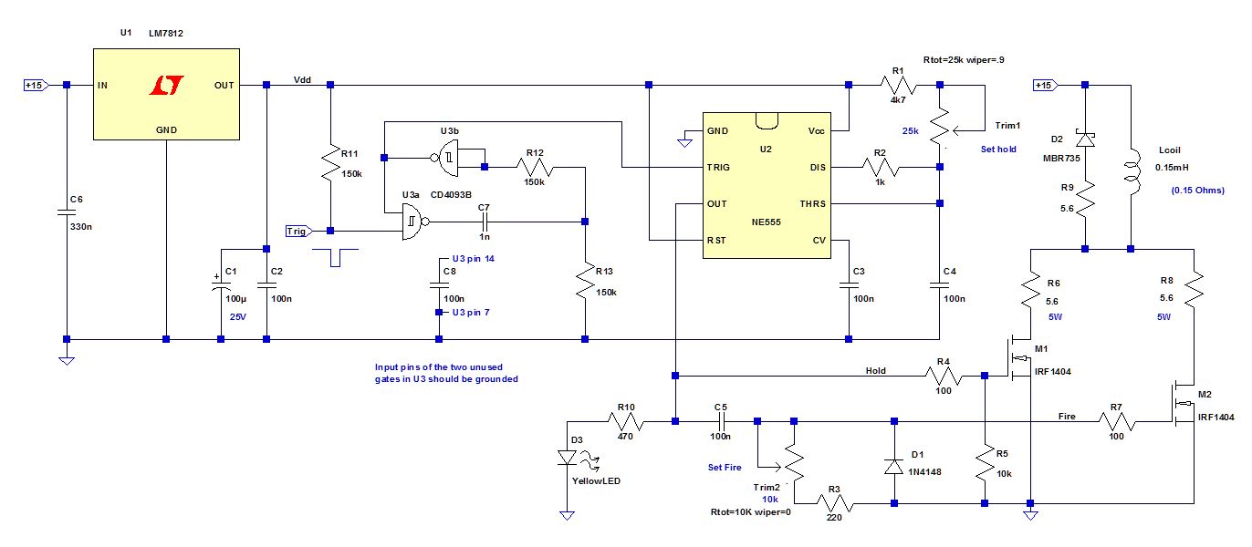

From the datasheet for the optosensor, I see its transistor current may be anywhere from 0.2mA to 2.5mA (albeit for Vce=5V). A current as low as that would account for the 555 not triggering, because the 555's pin 2 doesn't get pulled low enough. Increasing R11 and R12 to 150k each, and reducing C7 to 1nF should fix it.

C7 and R12 define the pin 2 input pulse duration, but require a sharp-edged input from the optosensor. So, it looks as though your sensor transistor isn't switching fast enough. A pulse-sharpening circuit can overcome that. Do you have space on your pcb to accomodate, say, a CD40106 chip (it's a 14-pin DIP chip), or a second 555, or a transistor and the odd resistor or two?

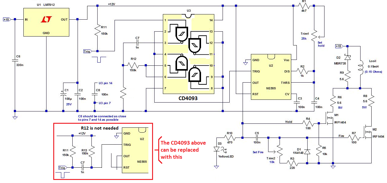

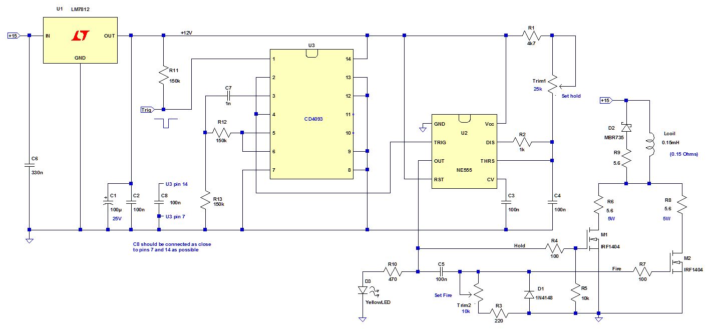

Here's the suggested modified circuit, using two (which two is arbitrary) Schmitt trigger gates of a CD4093 quad gate 14-pin IC to make a monostable which generates a brief trigger pulse for the 555 even if the optosensor output varies slowly. Bear in mind that a CD4093 is static-sensitive, so take due precautions when handling/wiring it.
Malc, yes each gate is an inverter, but use of two gates overcomes that.
I'd forgotten we had a 4013 circuit originally. As for reliability, I used to own an automatic transmission car where the engine speed was sensed using an IC from the CD4000 series. The IC never failed in the ten years I owned the car!

For an ignoramus, can you choose a layout (pins 1 - 14) and draw where they go? I presume 3a and 3b are pin 3 and pin 4 but not sure about other connexions.
You have shown various pins, but not all.
Ok. Here's the circuit with the pin numbers shown.
I simplified and cropped the schematic:
