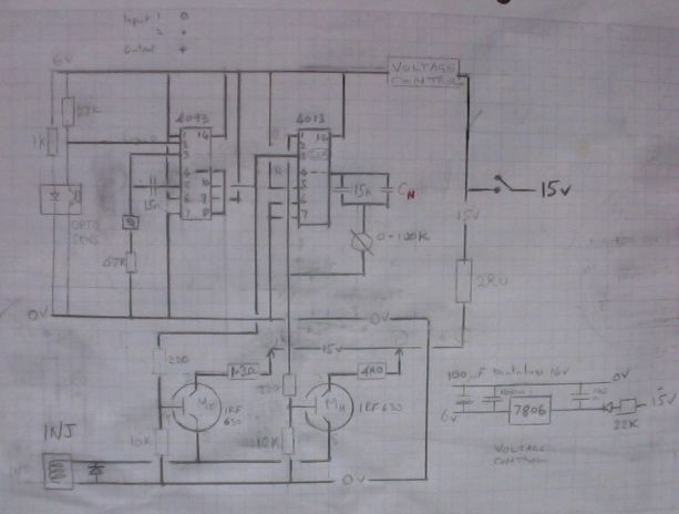

broken link removed Here is the part of the circuit in question. (Of course, it doesn't upload. Why not?)
As you can tell, I am not an electronic engineer (I'm having to act as if !).
I get told to "look at the Data Sheet" (1c4093) and the Truth Table. This is what I suggest, in order to get a positive square wave output of specific time (RC x ln V-v /V @ 25 deg C etc) from Pin 4.
The table suggests that if 5 and 6 are opposite, 4 will be positive.
The ic4093 is set with +5v at pin 14, O v at pin 7.
Below, please imagine B gets a dropped voltage from 5 v to zero, as a sensor (to the left of A) closes a circuit to ground. A is fixed at 5 v. Then, there should be a + ve signal from Q1 (pin 3).
Now, below, this is the second gate (if thats the right word). I'm sorry I am stuck with A and B again, but please imagine its the independent second gate in the 4093.
Q1 (pin 3 on the ic 4093) goes to second B, below, via a 15 nf cap, then thru 47K R to O v.
The second B, pin6 goes to O v. So pin 4, the second Q2 should be a timed + pulse.
Is this correct? Thanks in advance.
Malc
This is the scheme. But the main area was the 4093.
Pins 1, 6, 9, 14 get + 6 v. Pin 7 -> O v.
Pin 4 feeds Pin 8
Pin 10 is the + output.
Thank you for clarifying. If other FAULTS are seen, let me know.
Mosaic, the second set of RC with the potentiometer is the "accelerator". One of the caps can be changed. It works fine.
Malc
With a 6V Vgs and a 220 Ohm Gate resistor the on/off switching of the device is not optimized. Of course this reduces the kickback event as well at the cost of some heating in the FETs. I see a 22K resistor in the voltage regulator. This seems large. It implies that to maintain at most a 7 volt drop to keep the 7806 regulator supplied @ 8V or better the max current draw is (7-0.6)/22000 = 0.28mA. The 100nf decoupling cap near the 7806 Vreg is placed where? Hopefully as near to the 4013 logic chip's pwr terminals as possible.
A quick calc
The 220 ohm Rg => (Vg-Vth)/Rg= (6-4)/220 = 9 mA max Ig. But looking at the 4013 spec sheet, to maintain the Vth of the IRF630 of 4V the 4013 (Vcc=6V) would be sourcing about 3mA max. Given the .28mA supply, the 100uF and the 100nF should be able to maintain a 3mA 'spike' for the switch on cycle, which is < 10% Duty. More than 10% duty will cause the switching time on the FETs to be impacted....
The total gate charge on the IRF630 is 35nC thus the switching time is then 35 nC/ 3mA = 11.7uSec.
A 700uSec fire pulse will then actually occur 11.7 uSec later than the pulse, plus you must consider the inertia of the injector and its response specifications. If the inductance of the connection to the Gate is significant it could add a couple more uSec to the delay.
Since you have a Peak-Hold type of injector supply, it implies that you are using low impedance, hi performance injectors for tunability. The delays introduced by the MOSFET switching will reduce your tunability. Whether that is significant is up to you.
Well spotted. Its a 1K R in the voltage control. My wrong drawing. Is 1 K suitable? Please rework your "quick calcn" if you think it needs it.
I don't see the point of this but copied it off a commercial circuit. I think it was to reduce heating (but I thought the FETs wouldn't heat when they are only active for, say, 3 ms, in a 25 ms cycle ( 25 ms = time per rev at 2400 rpm)).
Well, its right beside it though not actually on the "legs" of the TO-220. Your comment seems very smart! I also don't know why I have the Tantalum cap: all this is copied off the original complex circuit which was designed by an expert.
A 700 uSec fire pulse will then actually occur 11.7 uSec later than the pulse, plus you must consider the inertia of the injector and its response specifications. If the inductance of the connection to the Gate is significant it could add a couple more uSec to the delay.
I value this bit, too. But we are OK with that 1.5% delay. At first, not knowing the inj's characteristics, we sweated over this but it is all OK. In the inj, low-mass parts are moved small distances with large forces (1500 bar is about 5 tons/sq in or something).
Can you look at the RC circuits, please, with regard to their timing? There are 2. One for the initial sq wave, which is also Fire; another for the Hold. In particular, is the common wire from that timer, through the Hold FET with the voltage divider, OK? (I copied that V divider from a professional circuit with that FET).
