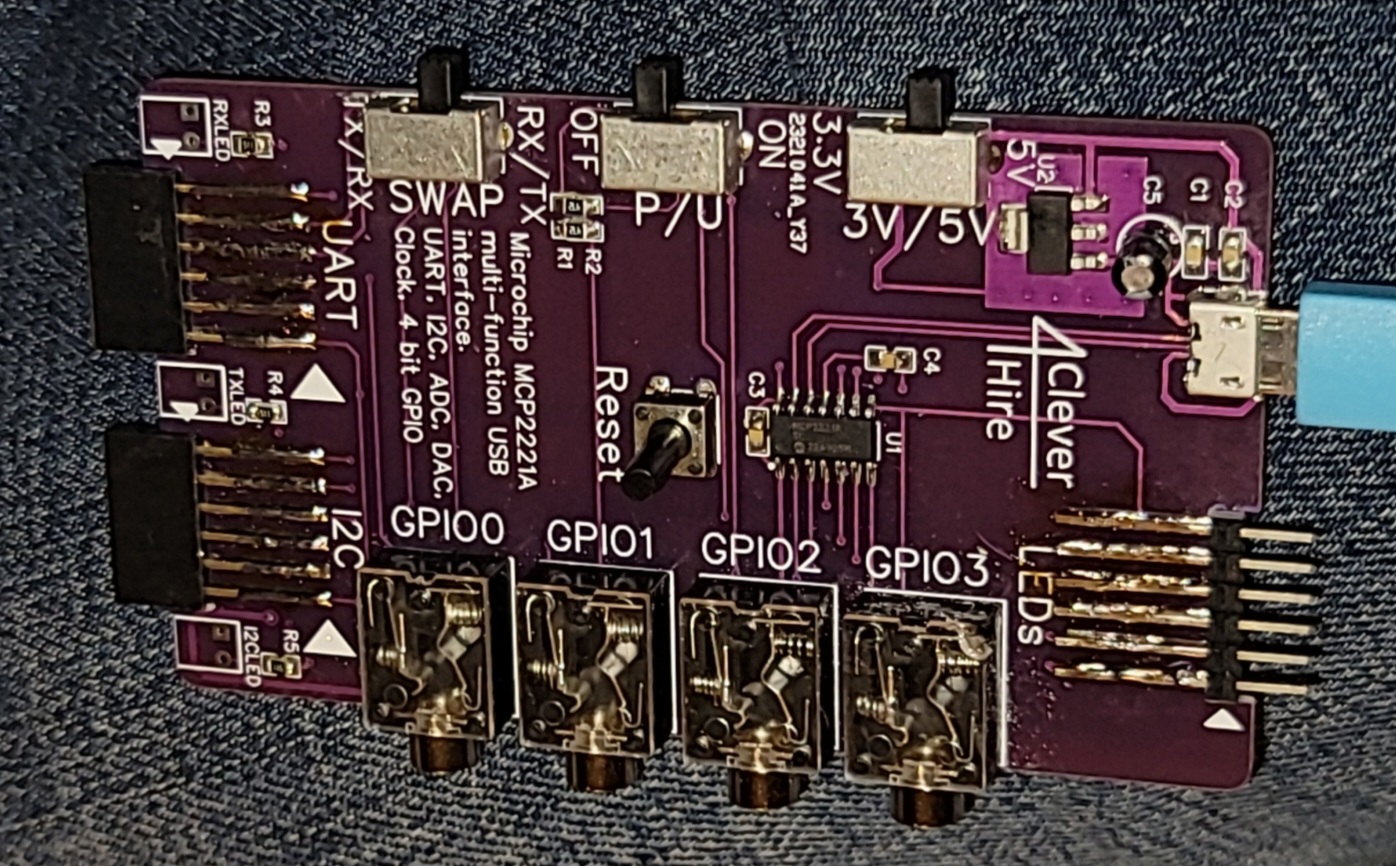

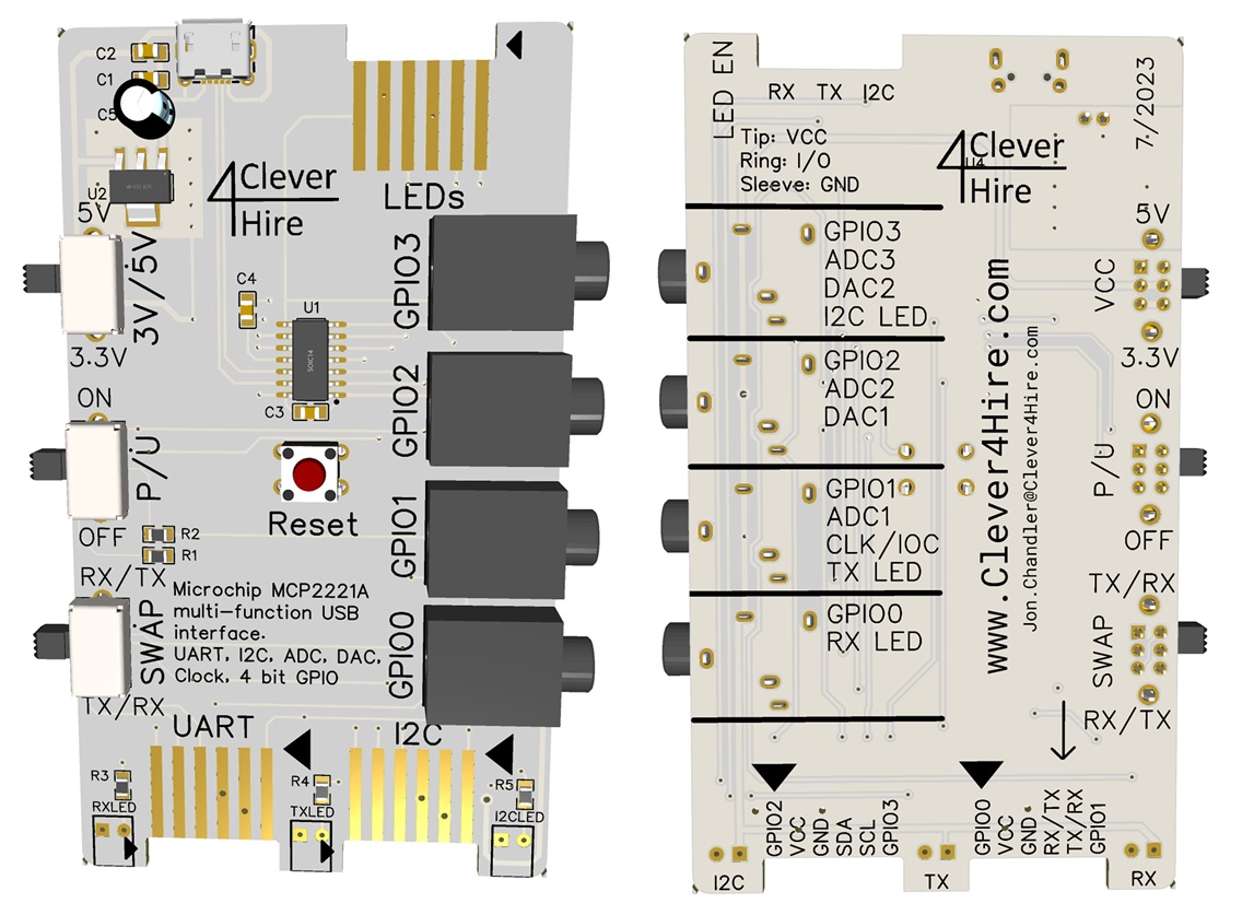

Here's a recent example. Years ago, I laid out a USB–UART/I2C interface board based on the Microchip MCP2221. I recently came across that board that never did work and had another go at it. This time, I decided to use all of the features of chip:
● USB-UART interface
● USB-I2C interface
● Four multipurpose GPIO lines that can be
○ Digital GPIO
○ 10-bit ADC × 3
○ 5-bit DAC
○ UART TX & RX activity LEDs
○ I2C activity LED
○ Interrupt input
○ Adjustable duty cycle clock output
Microchip supplies an I2C terminal app for Windows, Apple, Linux and Android, and it can be controlled directly from a PC using Circuit Python commands (haven't mastered that yet).
I think this will be useful for quick&dirty tasks like testing out I2C commands easily or for simple data collection tasks. But sharing things like this here usually goes over with a resounding THUD, often with a side of unhelpful criticism.
