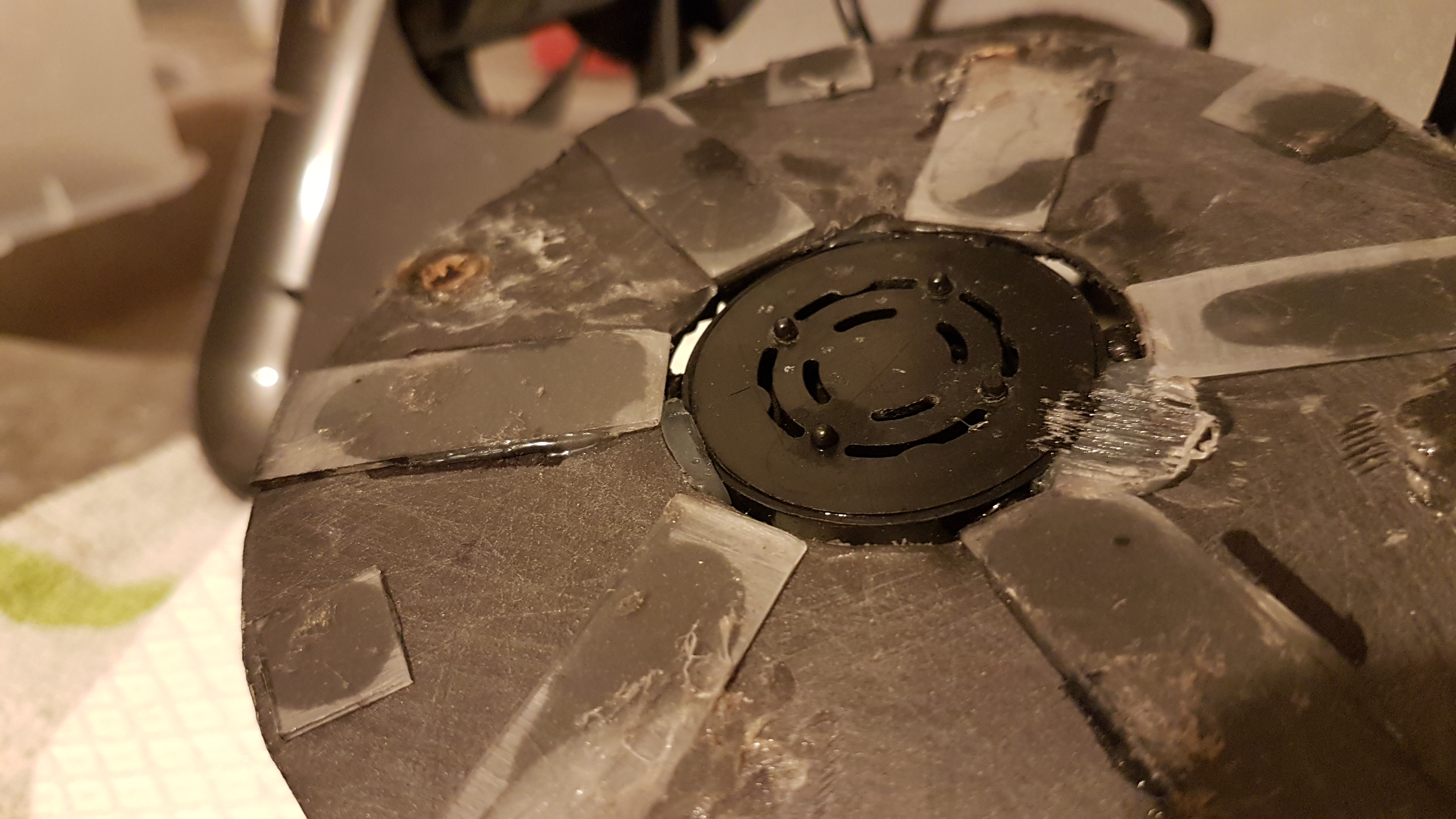

ps: this mist maker has holes at the bottom. What are they for ? Because as far as i know, piezo element on top is the one doing the mist ... water comes on top, it shoots out. What are the holes on the bottom for ?

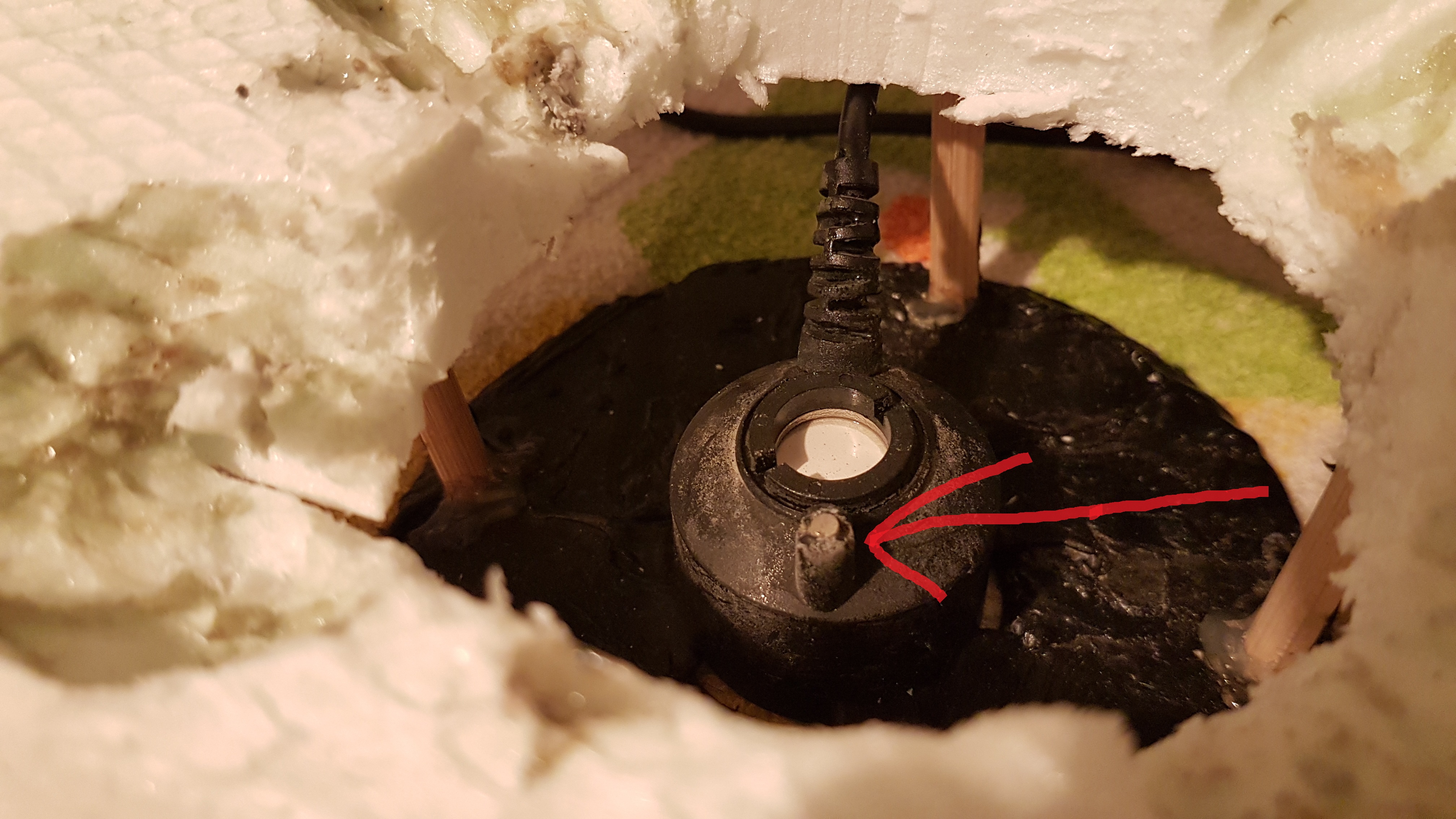

Dr_Doggy Pommie This mist maker has holes on the bottom. What are they for ? I am asking because i made a float so that mist maker is floating in water at the correct depth (this way when i pour more water, mist maker will still work because it rises). Is it possible that the bottom of mist maker has to touch the floor ? It has tiny legs, like 1 mm. I included photo of mist maker from both sides to help you answer.

i think bottom hole is to refill water,
what i really remember is that if it is too deep the evaporated water recondenses.
the part marked in red is the safety sensor and needs to be submerged,
touching the floor is not a requirement

mist goes out the top and replenishes through the bottom, it would prolly still work if you plugged the bottom, but would reduce flow since the water would then need to replinsish through the top
