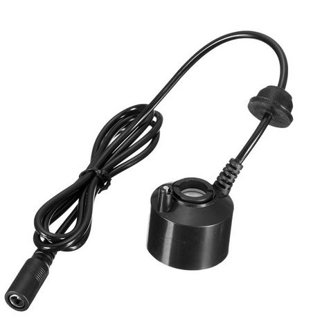

I am using a cheap ultrasonic mist maker for certain thing. My goal is to get as much mist as i can with it. In order for this i need the answer to two questions:
1) What would be the optimal distance between top of the mister and the water level, meaning how far under the water it needs to be to get the max output. If this cannot be answered then how would i go about testing it. I can visualy try to assess it testing different depths but visual inspection of mist is not very accurate.
2) This mist maker has holes in the bottom of it and it has very tiny legs, so that if its on the bottom of water box, there will always be about 1mm of space for water to get in. Does this distance matter ? Because right now i made a system where the mist maker will actualy be floating a few centimeters under the water top. That way no matter how much water i have in the box, it will still be working. But does that negatively affect its performance ?
My goal is to get as much mist i can with given Wattage. This module uses about 12W and with added fan i turn about 0.25L of water per hour into a mist. I would like to increase this amount as much as i can with as electricity usage. I attached an image of the mist maker element.

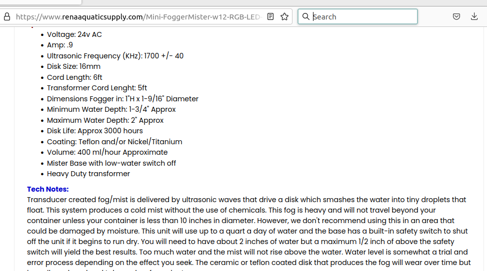

Ohhh, so that would be minimum 4.4cm, maximum 5cm. Thats a lot less difference so it wont really make much difference. I might go for 4.4cm. For some reason i have a feeling that will send more mist out than 5cm, though probably the difference is so small you cant even measure it. Thank you for your help.

This mist detector has self protection, on top there is a small metal ring that i am guessing detects when water level is to low (no voltage on that top part im guessing). So it stops working and prevents overheat. The wierdest thing happened with 1 of the misters though. I am using 1 for 2 years now and its working great. But i made a misting device for a friend, the same way i made it for me. And water level was ok at all times ... it died after a few hours. The mist maker actualy died so badly that it was effectively a short circuit - zero resistance. So i was amazed that a cheap 6 dollar aliexpress power suply detected a short and actualy survived. It could end with a fire so that was a good signal to me that i should always use a fuse.
I am back to height problem. We now know i need to use 4.4 - 5cm depth. But is that measured from bottom part of the mist maker or the top part ?
as far as i remember the top little bit needs to be above the water line, like a cm or an in or sumthing like that, just give it a dip , you will clearly see when it struggles... i floated mine with cut up pool noodle.
I read the spec as water depth above the mister to be between 3/16" and 7/16" but it is a little ambiguous. Is there someone that can measure a working one?
Nope. I just have the unit like i posted in my first post. It is very small and has to be completely submerged in order to work. That top thingy, like a thin plastic pin with iron top, that is to alert the unit when there is not enough water so it shuts down the mist unit to prevent overheat and damage
