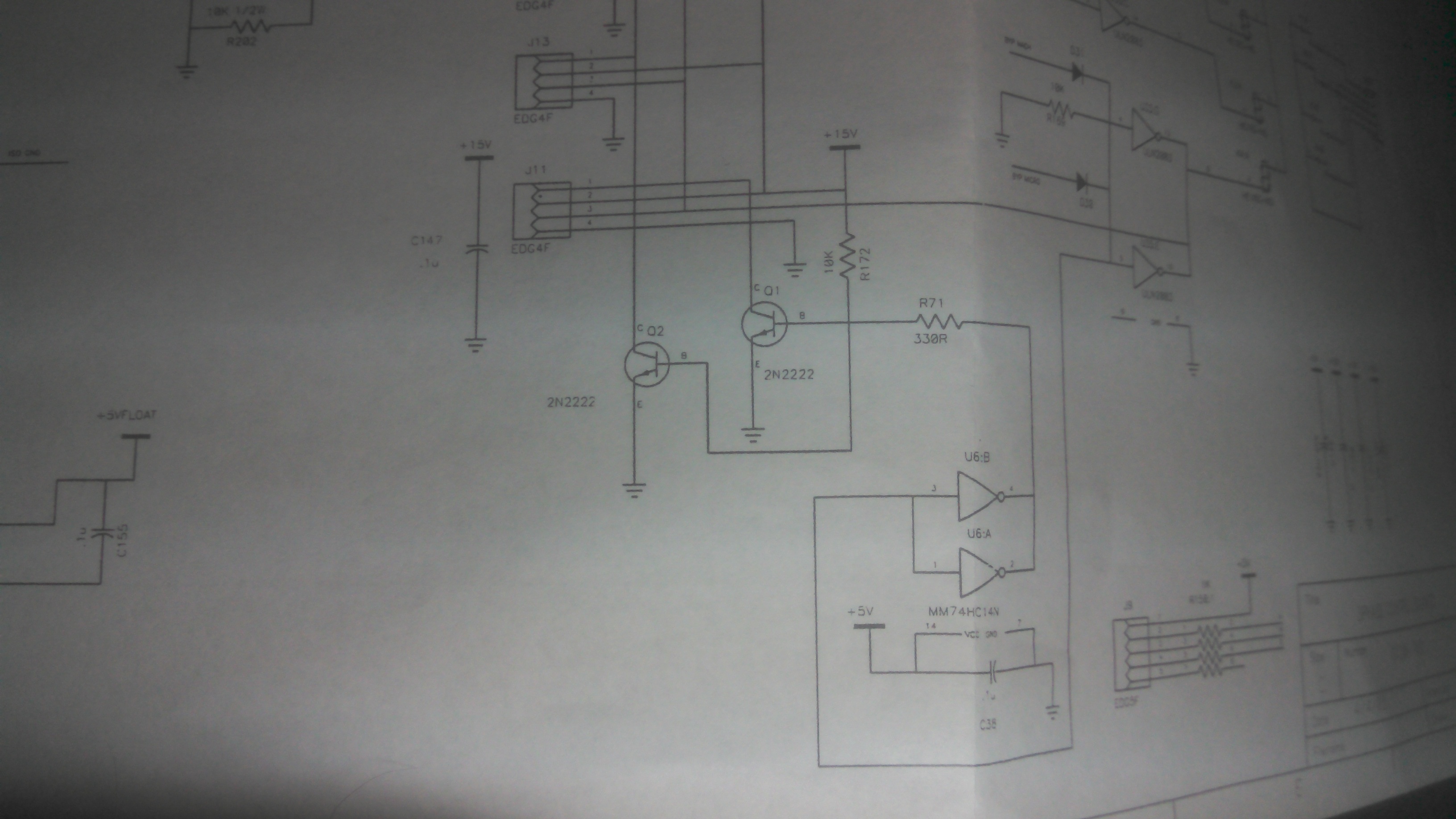

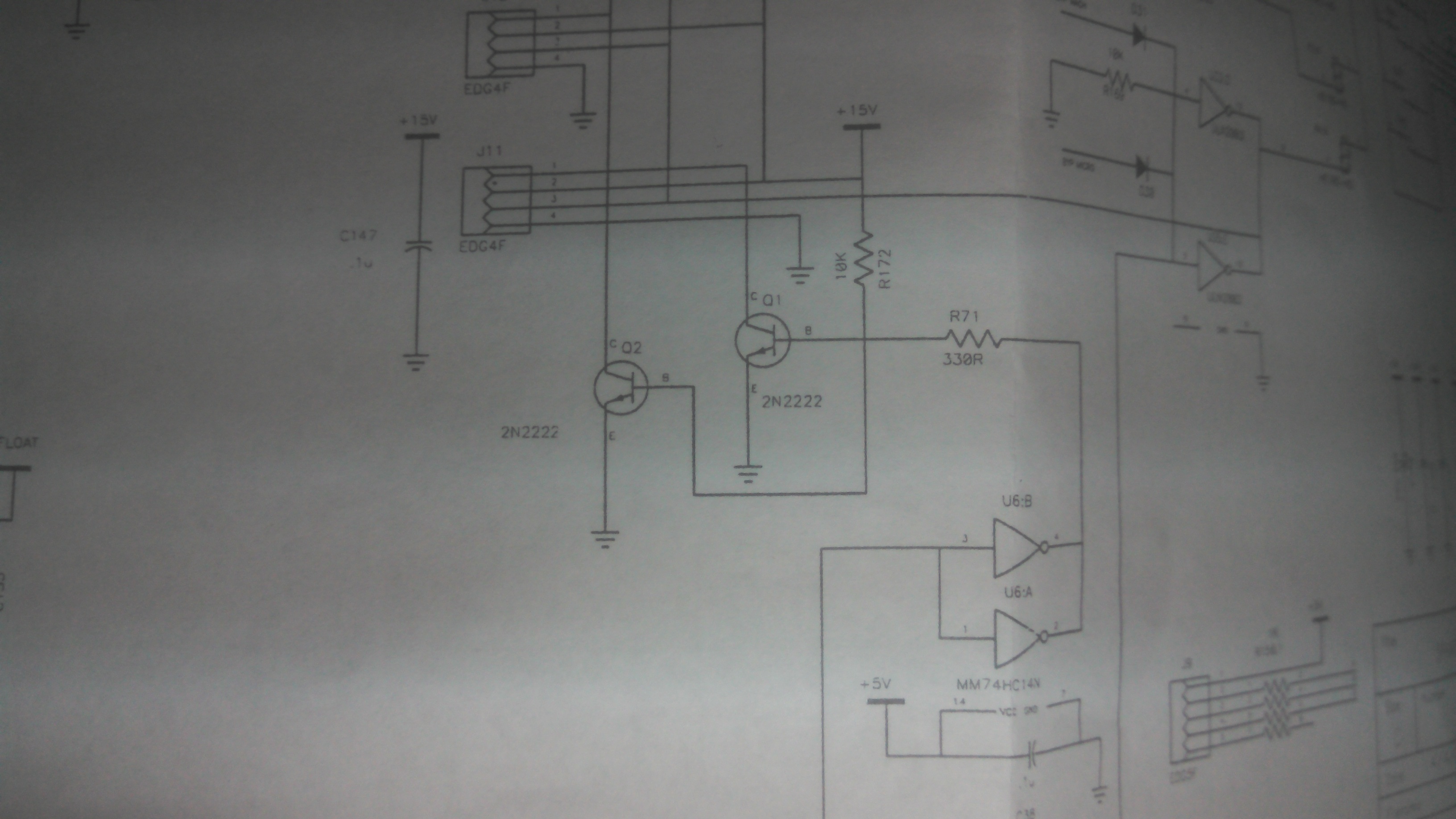

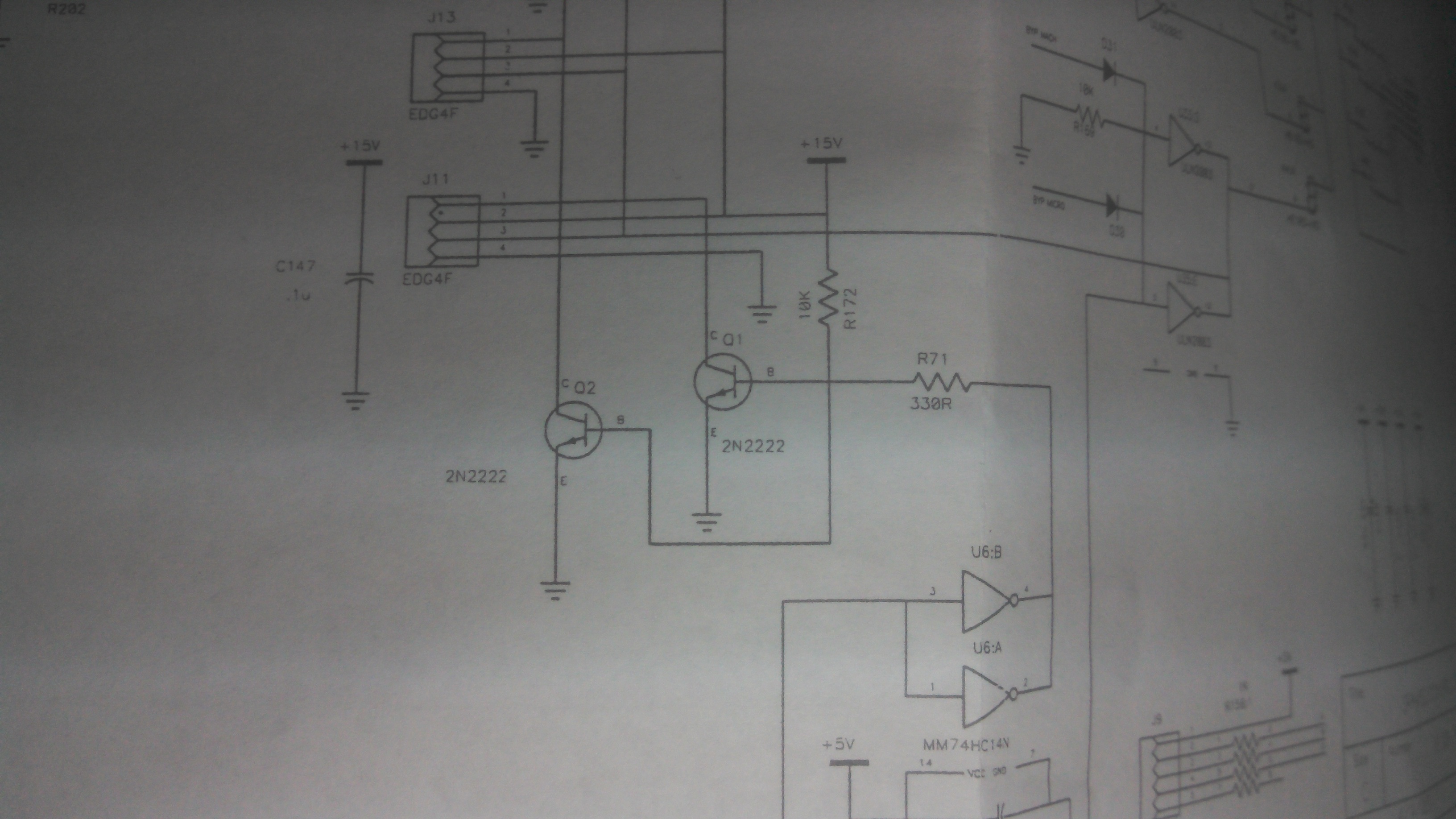

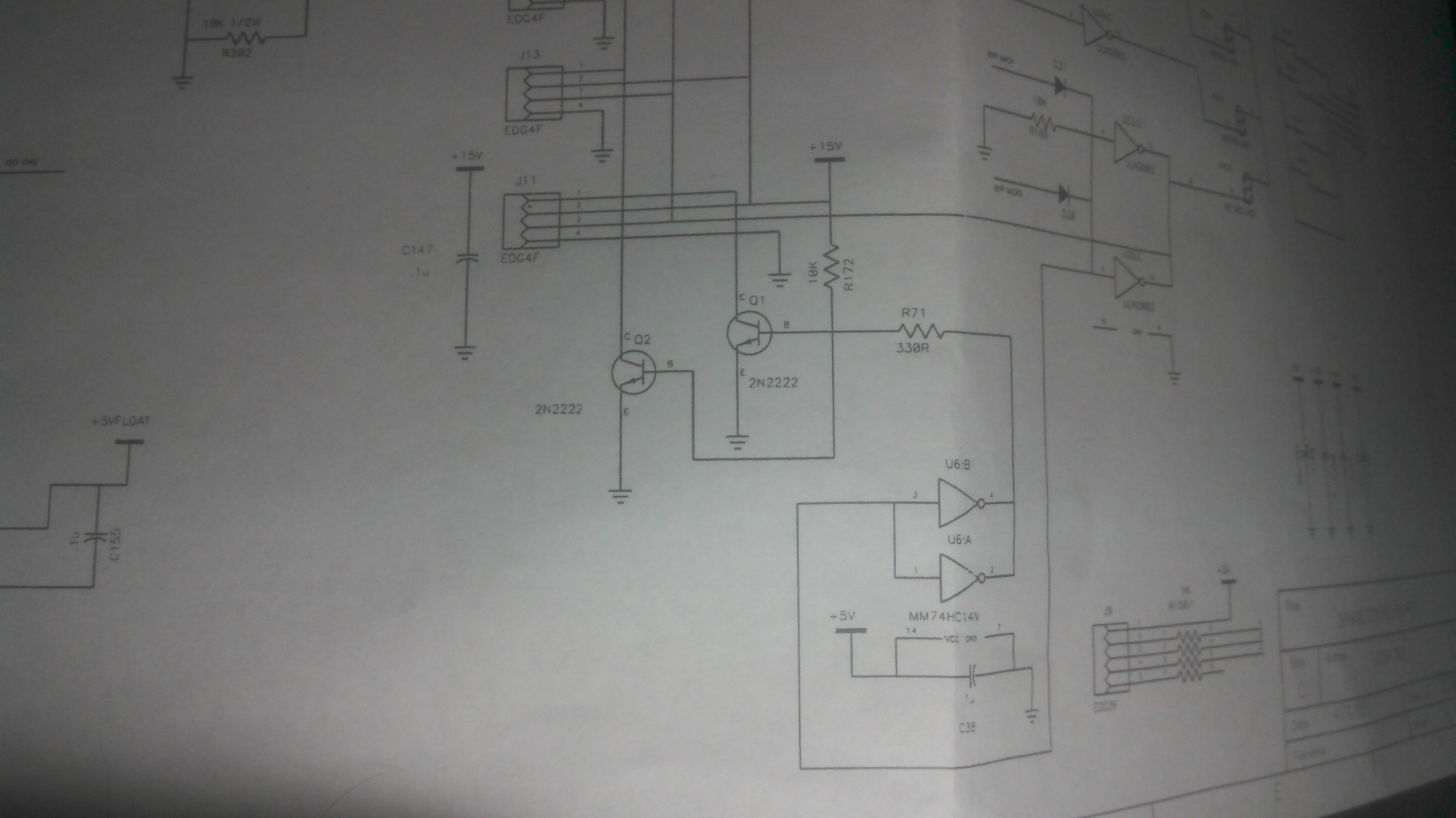

Are these transistor switches? how do they work in this circuit?
Q1 is definitely a switch of some sorts, Q2 is probably an indication that +15V is on.
I'm confused on how the transistors switch works
How does the transistor switch turn on? its from the collector
Mostly I have seen transistor switch turn on from the base
I dont really get what youre asking. The transistor needs current flowing into the base to get it on, that is what R172 and R71 achieve.
So the transistor switches are Always Turned ON than? the collector will turn the transistors OFF?
I'm confused on how the transistors Switch ON and OFF, what turns them on and what turns them off
the input to U6A and U6b turns Q1 on. The +15V rail turns Q2 on.
