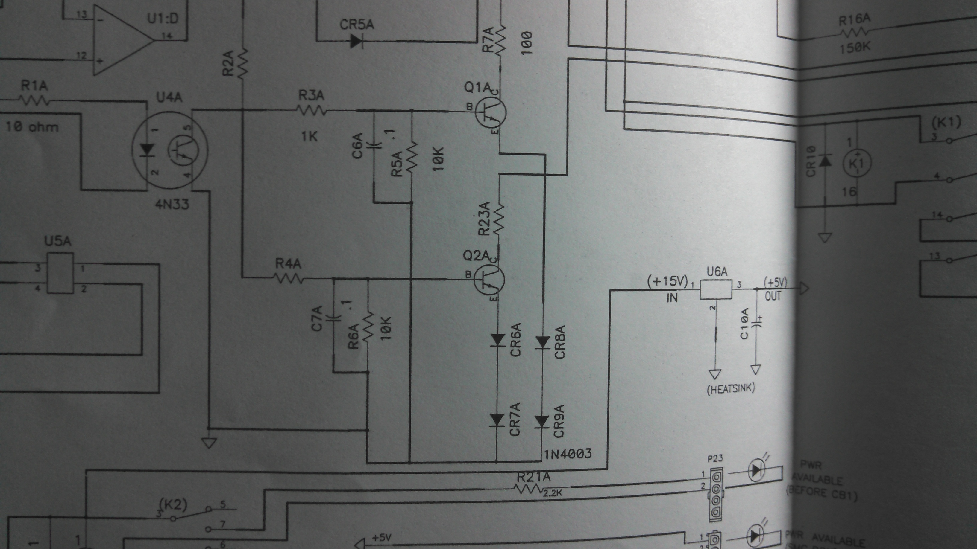

I'm not sure why the transistor switch doesn't go to Zero voltage because of the 2 diodes on the emitter
Any reason why the designer didn't want the Turn OFF position of the transistor to not go to zero voltage but to 1.4 volts?

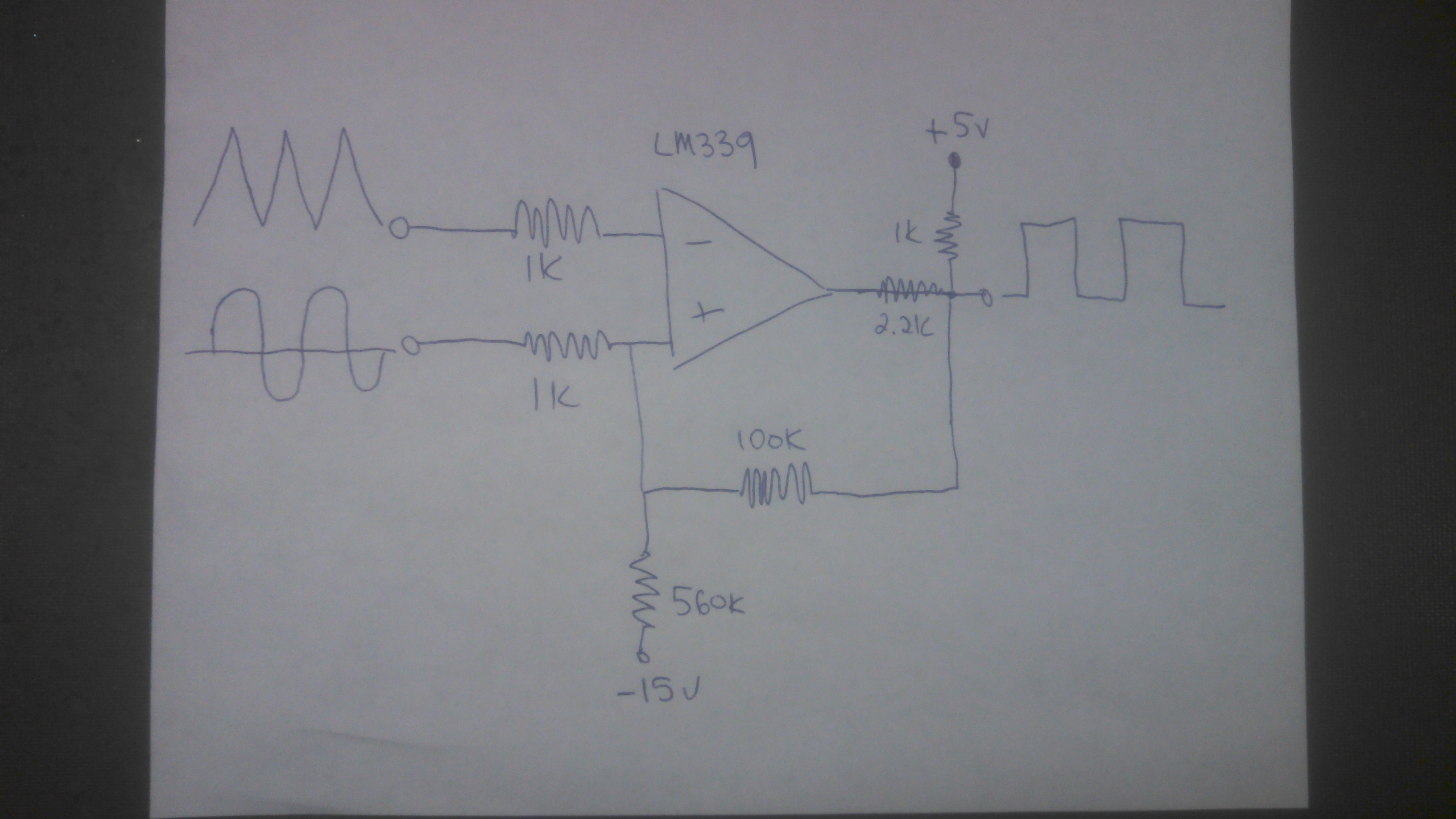

My work using a triangle waveform and a sine waveform to create a PWM modulation output
Take a look:
What I don't understand is
1.) How does a triangle waveform and a sine waveform , the difference between the two will create a pulse width modulation waveform?
2.) I can't tell on my oscilloscope the difference between a square waveform VS a pulse width modulation waveform, they both look the same to me, so how do I tell the difference between the two?

It's not the difference, but rather a comparison of a sine wave and a triangle wave that creates the pulse width modulation.

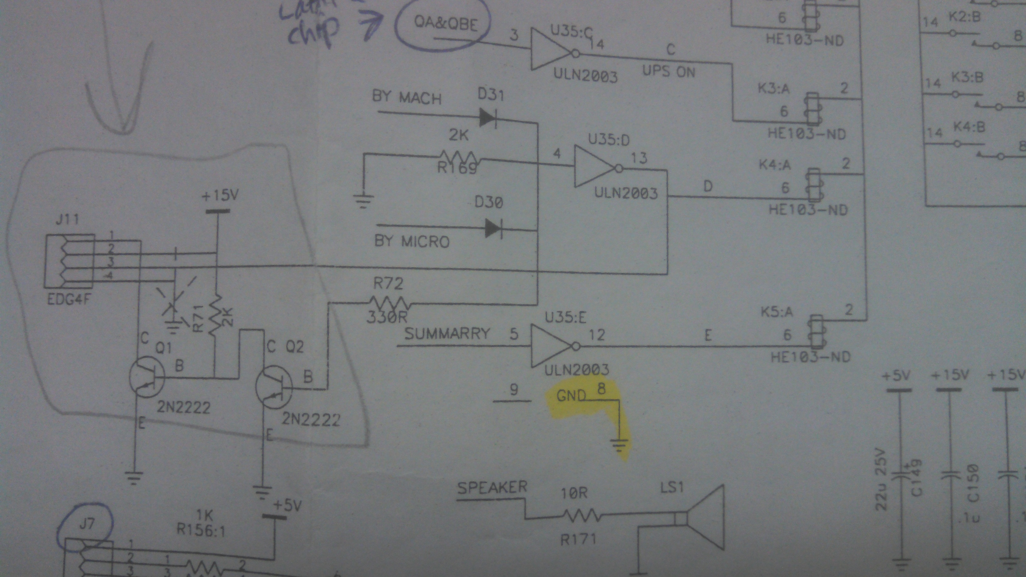

How is that in series? That is clearly a buffer with open collector output.
Wonder how and how did that schematic, without points denoting junctions it is really confusing and ambiguous.

A square wave has 50% duty cycle, pwm has variable duty cycle.

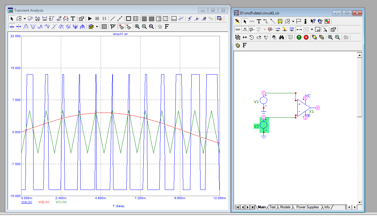

The triangle is much faster than the sine wave, so the output is high whenever the triangle is lower then the sine. So for a voltage on the sine input just a bit lower then the peak of the triangle you get a narrow pulse on the output, and you get a wide pulse when the sine is just a bit above the bottom of the triangle.

This should hopefully give you a better idea how is the pwm achieved.
Thanks for that kubeek

No, the pwm output is on when the triangle is higher than the sine, and vice versa.
The output has a bit slow rise and fall times, so the transition doesn´t look exact, but they occur at the point where the sine and triangle cross.
