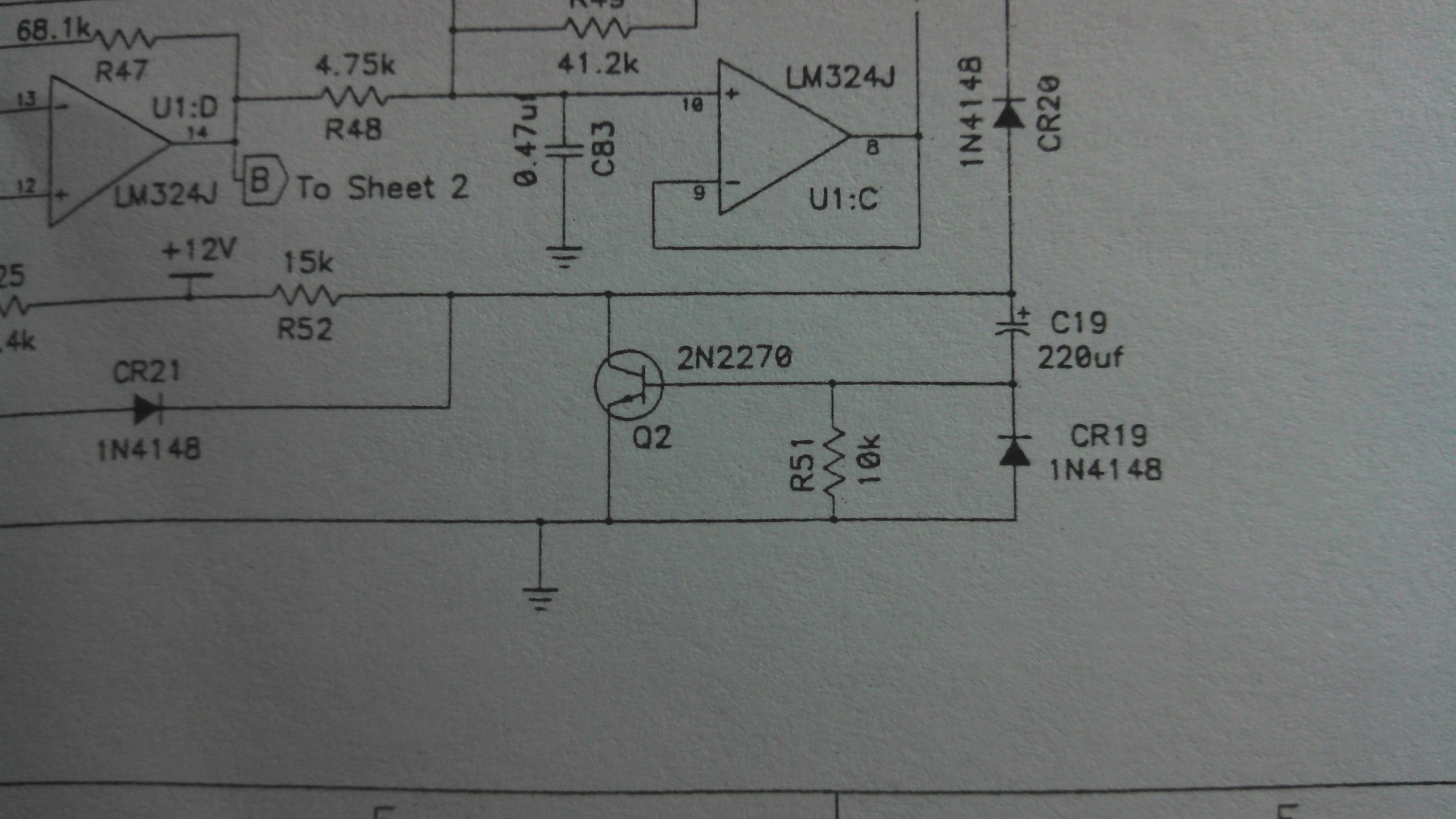

Transistor controlling the current?

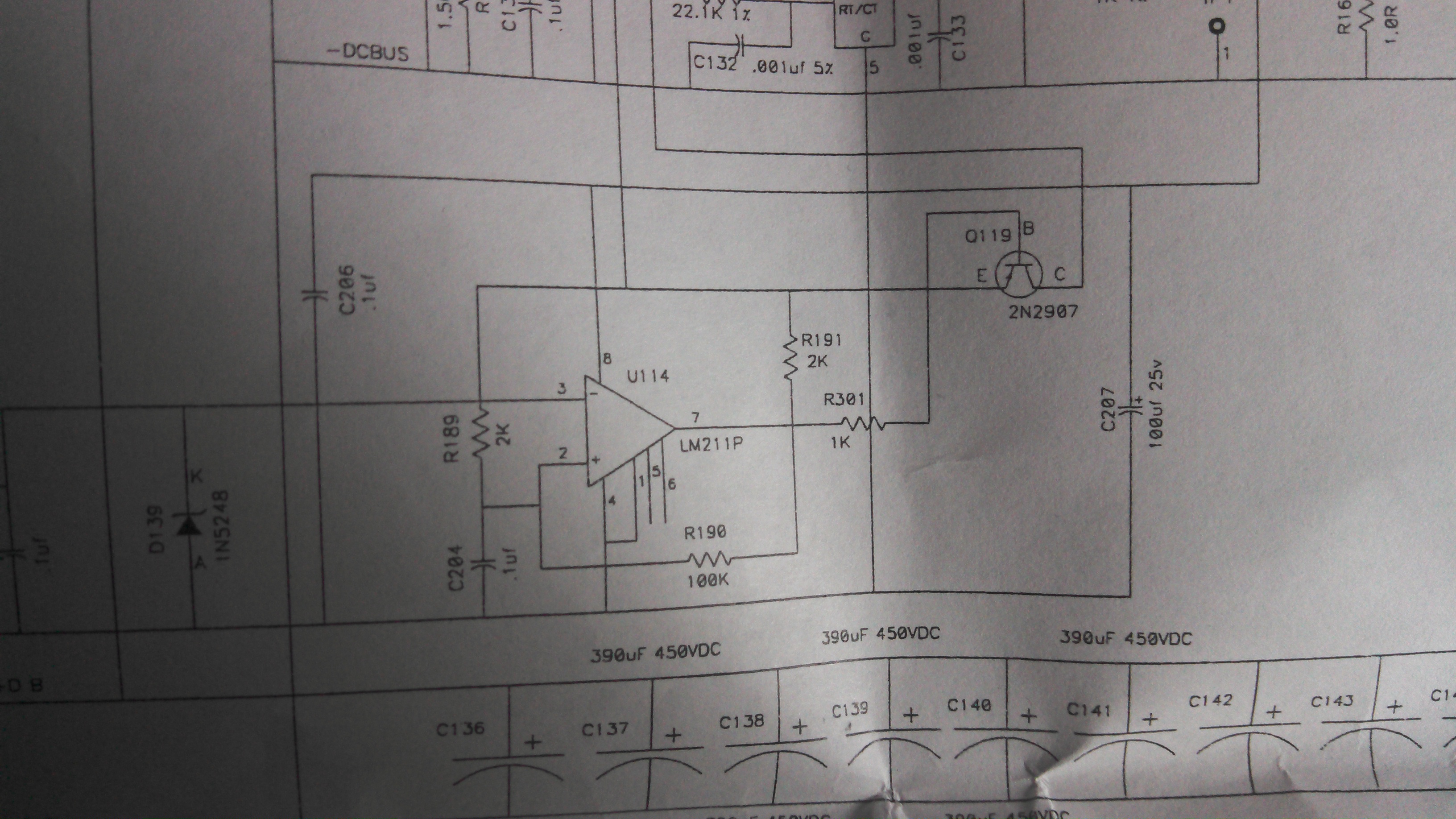

Transistor as a comparator? or a switch

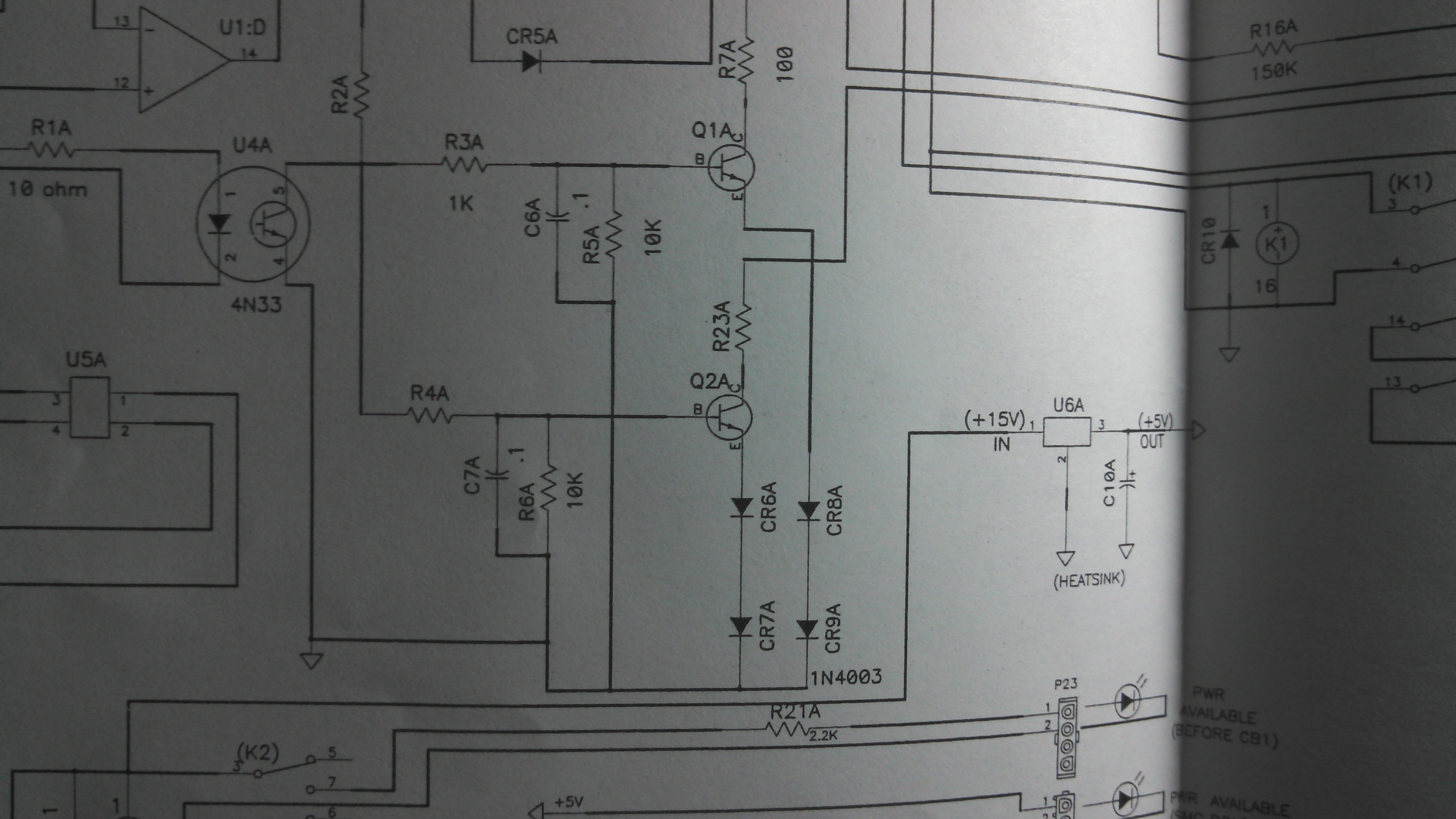

Why did the designer use transistors instead of a FET?
Using a transistor as a switch is different than using a FET as a switch? what is the difference?
I also see Diodes from the base of a transistor , going to ground
The Diodes on the base going to ground protects it from negative voltage? what does that mean, because a diode is only 0.5 volts so it any negative voltage will be much more than 0.5 volts but it will conductor the transistor if the diode wasn't there.
They put the diodes on the base going to ground , so negative voltage won't turn on the transistor?

If you look on the datasheet of any NPN transistor its base-emitter is turned on when its base is positive about 0.7V from its emitter.
When the base voltage is negative it does not conduct but causes it to break down (it conducts like a zener diode) and be damaged at 5V or more.
Therefore the diode is added so that the base does not get a negative voltage that would damage it.
But the diode only protects the transistor , of how many negative volts? the diode is only 0.5 volts, so is the negative voltage is more than -1 volts it will damage the transistor because the protection diode is only 0.5 volts to turn it on
Any negative voltage more than 0.5 volts will turn on the protection diode?

"A silicon diode normally conducts with about 0.7V. It is 0.5V when it is hot and when its current is very low. It is 1V when it is cold and when its current is very high.
When the diode conducts at -0.7V then it protects the emitter-base from having a higher negative base voltage.
The emitter-base breaks down and is damaged when the base voltage is -5V or more negative."
No it is not dependent on the voltage rating of the diode. The diode is forward biased, so there is some current flowing through it in the forward direction.
How much current depends on the voltage and output impedance of the thing that supplies the current.
With higher current the Vf will rise, but not much above 1V, but with enough current flowing the diode will dissipate a lot of heat and will eventually melt.
If any negative voltage below -0.7 Volts will conduct the diode, if there is -6 volts the diode will be what? How does it protect the transistor from negative voltage on the base?
So how much negative voltage does the diode protect? Only -0.7 Volts?
The diode clamps at -0.7V when its current is medium. It clamps at 1V when its current is high. Then the base of the transistor never gets near -5V so it is protected from damage.
Like I said, if you put -5V without any limiting resistor, the current will be very high and the diode will melt very soon. The supply voltage will divide according to the supply resistance and the V-I curve of the diode.
Edit: no idea how true the model is, but for 1N4001 right across an ideal 5V supply the current is 33A, and the diode has forward drop of 2.5V at 12A.
The circuit the OP posted has a 1N4148 high speed diode, not a 1N4001 slow power rectifier.
The circuit might have been posted on the other website's forum.
I don't get how you can put a - 6volts or -10 volts on the input to the base of the transistor and the protection diode clamps it at -0.7 volts or 1 volt
It doesn't make sense to me
You do not connect -6V or -10V at hundreds of Milli-Amps to the base. You connect -6V or -10V through a current-limiting resistor so the current is 5mA to 10mA. Then the diode clamps the voltage to about -0.7V.
