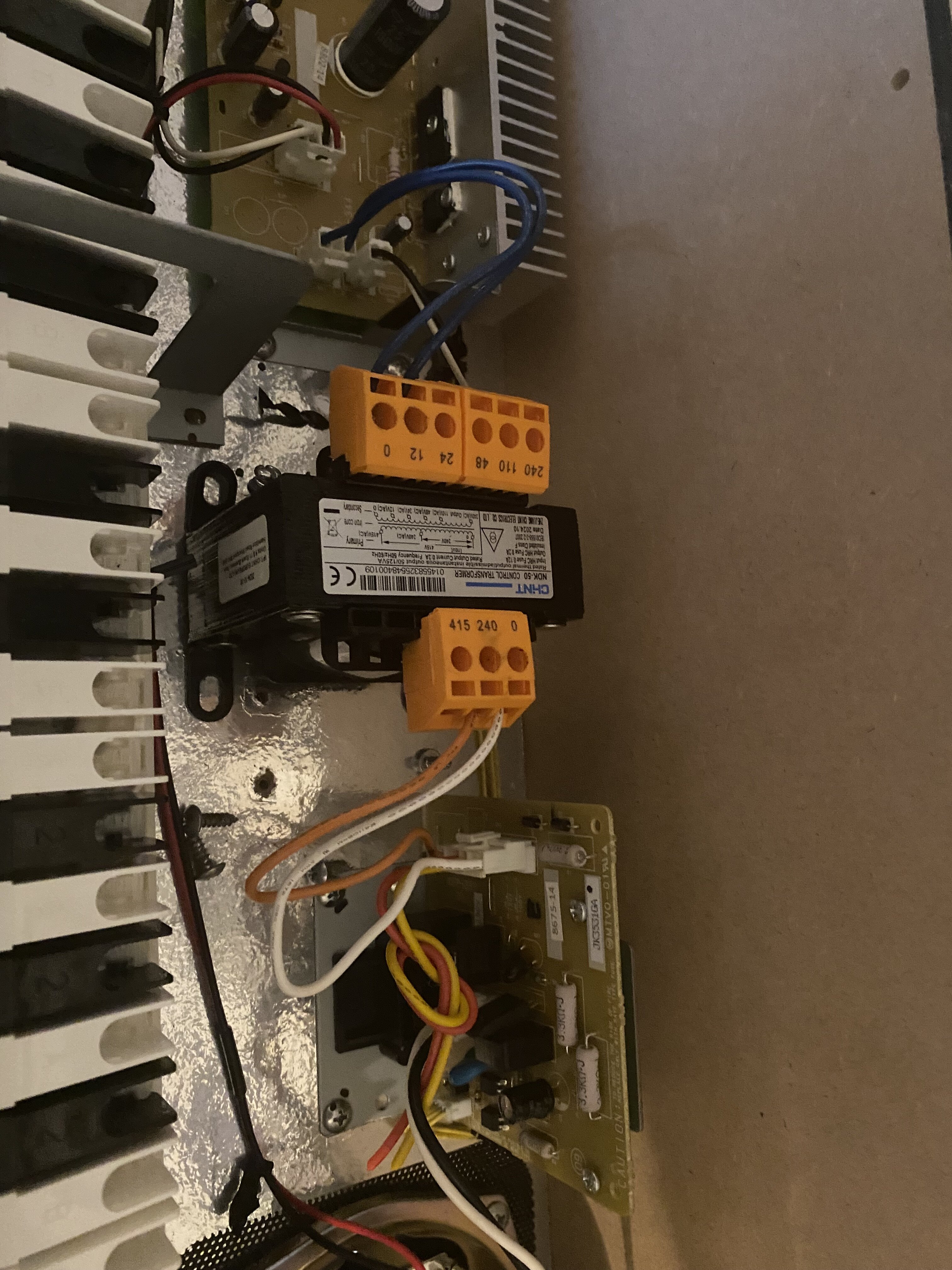

Glad to join the community. I have a Kawai KDP 80 Electronic Piano and can't get anything out of it. I've traced the 230 volt supply through the board and have 230 volts at the primary side of the transformer a Bando KT-031. The problem is I don't know what the secondary supply from the transformer should be and can't get any information I've tried Kawai and their distributors etc. The secondary is the two blue wires on the right of the picture.
I've got the service manual attached
but can't see what the secondary is any help appreciated.
I've bought this transformer which I'll fit next week. I would have liked an 18 volt tapping just in case the 12 volt doesn't work, the next tapping up is 24 volts which I'd be reluctant to put through the circuit

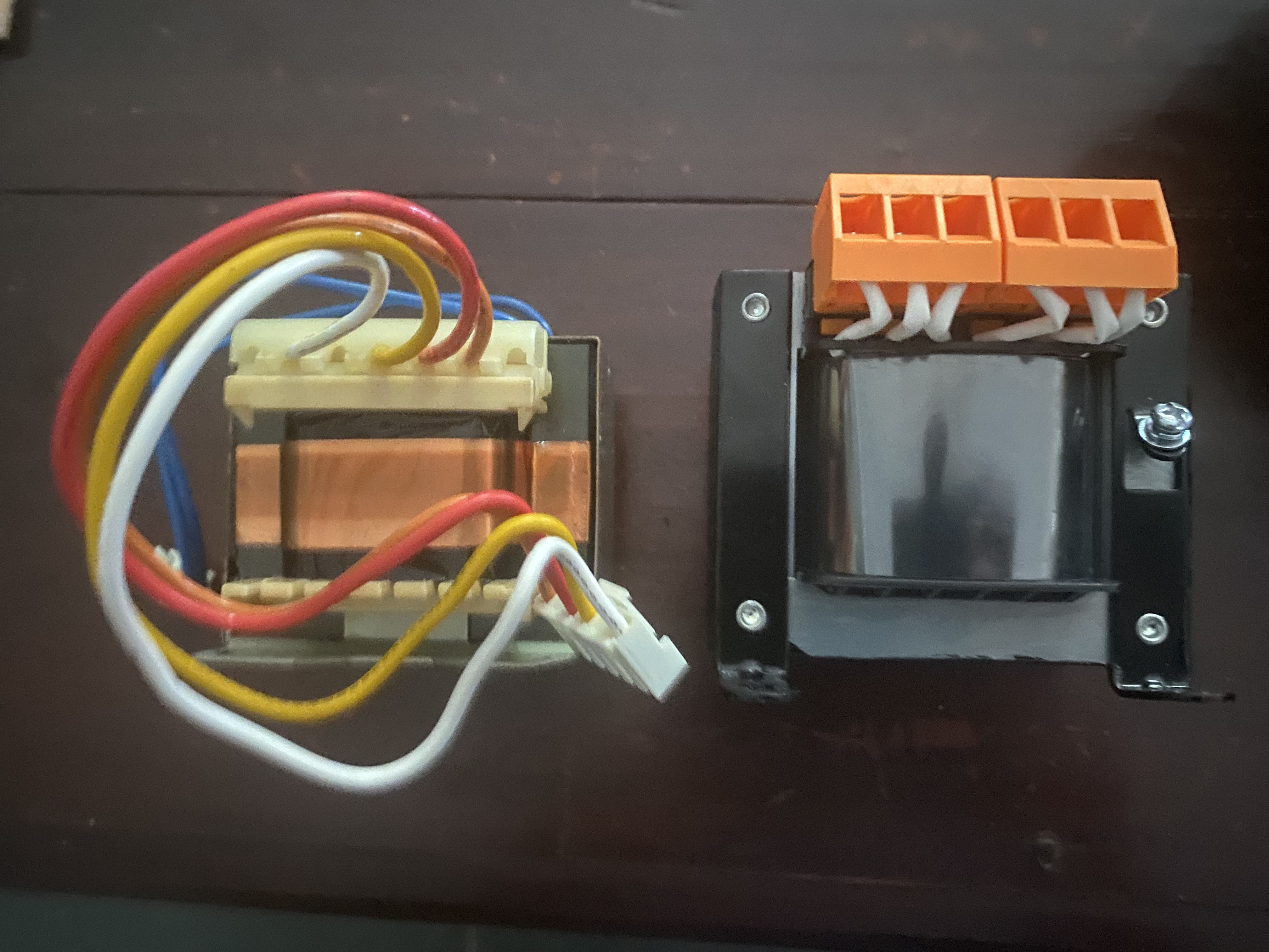

I’ve attached a photo of the transformers new one on right.
I took a step by step approach and found that the transformer was getting quite hot when I connected he 240 primary even before I’d connected the secondary side.
A number of times I checked the primary voltage and this was 90 volts instead of 240 the secondary voltages were half of what they should have been so I don’t really know what was happening.
I connected the secondary and all the voltages seemed to be ok and the transformer didn’t appear to be overheating. I had led lights on the piano which I didn’t have before but still no sound I also tried with headphones.

I see on the top the transformer says "rated output current 0.2A", so it's far too small - it's nothing like a standard transformer, but a special one for a special (and obscure) purpose.
How did you come by it?, it's an unusual thing to come across.
Seems to be a general purpose transformer 50 va
Nothing of the kind, it's a very specialised item, for a very specialised purpose (what ever it might be?), hence it's high price tag, and complete unsuitability.
There's no 'think' about it, it's printed on the top - a mere 0.2A
Unfortunately I can’t get a specification for the original transformer from Kawai or the transformer manufacturer.
You don't need it, it needs to be about 12V AC out, or a LITTLE higher (but 12V is the nearest standard value), and the size of the old transformer is about 50W, so about 4A (not 0.2A)

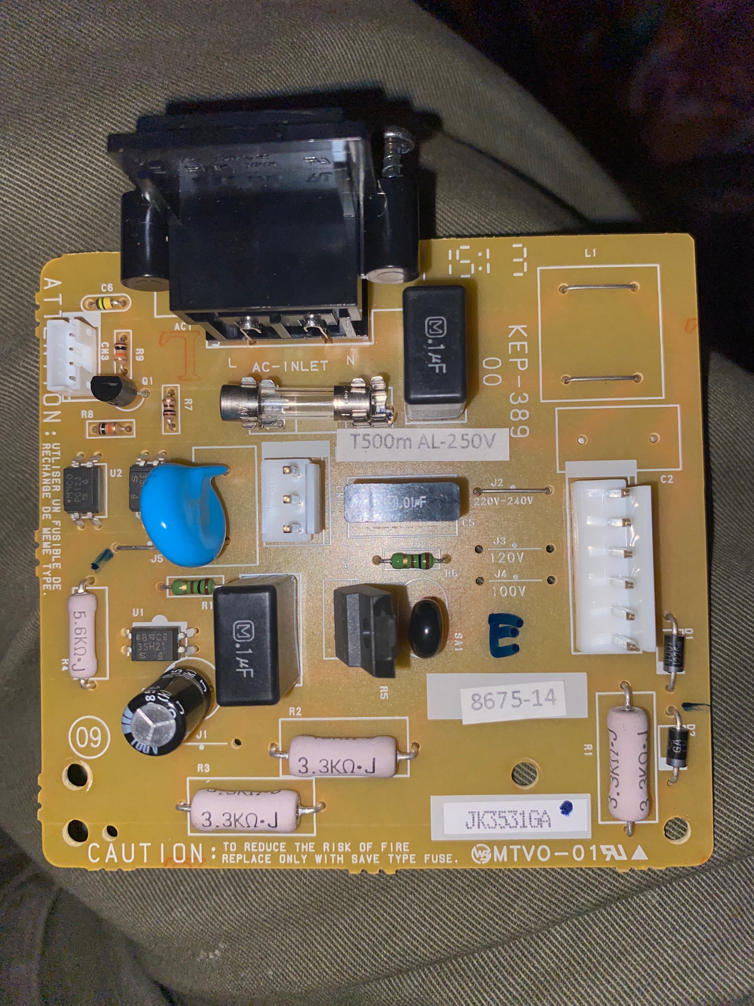

Assuming the schematic is correct, then it already has a mains switch, and it seems likely that the capacitor I mentioned is S/C. When you take the board out, have a good look - make sure that the capacitor hasn't been replaced by a piece of wire, and the mains switch discontinued.
I’ve had the piano from new so there shouldn’t have been any modifications to the circuitry. On other models you can program the auto power timer switch off so I’ll have a look at that. I’ll check the pcb but maybe it’s a case of replacing that as well.

I checked the capacitor on the pcb this was fine and wasn't shorting out.
