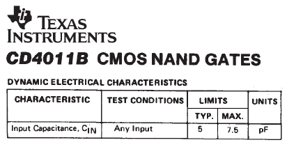

My manager says you have to have pull down resistors on CMOS gates because the inputs and outputs are floating, high impendance, and the FETS inside the CMOS gate has capacitance that needs to be discharged, the pull down resistor discharges the FET's capacitance
Is this true or not?
Not true.
Cmos logic circuits have many gates, counters and other logic devices all connected together with NO pull down resistors. The input capacitance is extremely low and does not need to be discharged.
If a Cmos input is not being used for logic then it does not need a resistor, it is simply connected directly to 0V or to the positive supply.

So Does TTL need pull down resistors so the input capacitance needs to discharge?
PF =1 means that the cos(θ) = 0 for sinusoidal voltages and sinusoidal currents. It means that there is no phase difference between the voltage and currents.
PF= 0.7, is the voltage and current sinusoidal and no phase difference?
Why does a circuit board create harmonics on the AC unity when hooked up? what is causing these harmonics?
Does having non- linear loads cause harmonics and changes the PF factor?
Why do you ask about input capacitance? It is so low that the datasheet does not spec it. It might be only a few pF and does not need to be discharged.
The inputs are the emitters of a turned on NPN transistor so they float high. If an input is not used and you need it to be a logic low then simply connect it to 0V, a pull down resistor is not needed.
Old fashioned, high supply current TTL needs a fairly high input-low current of 1.6mA as shown on its datasheet.
