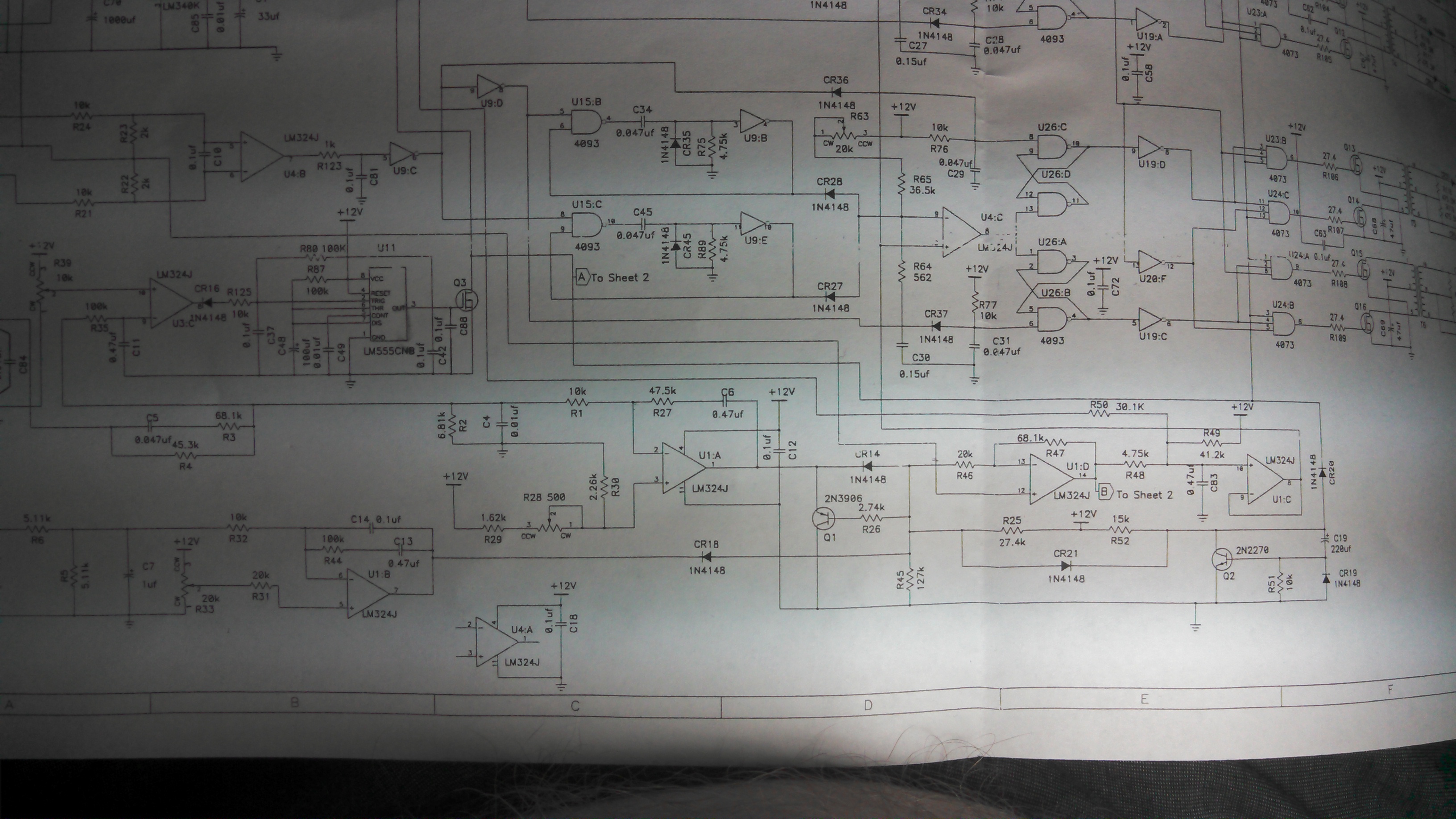

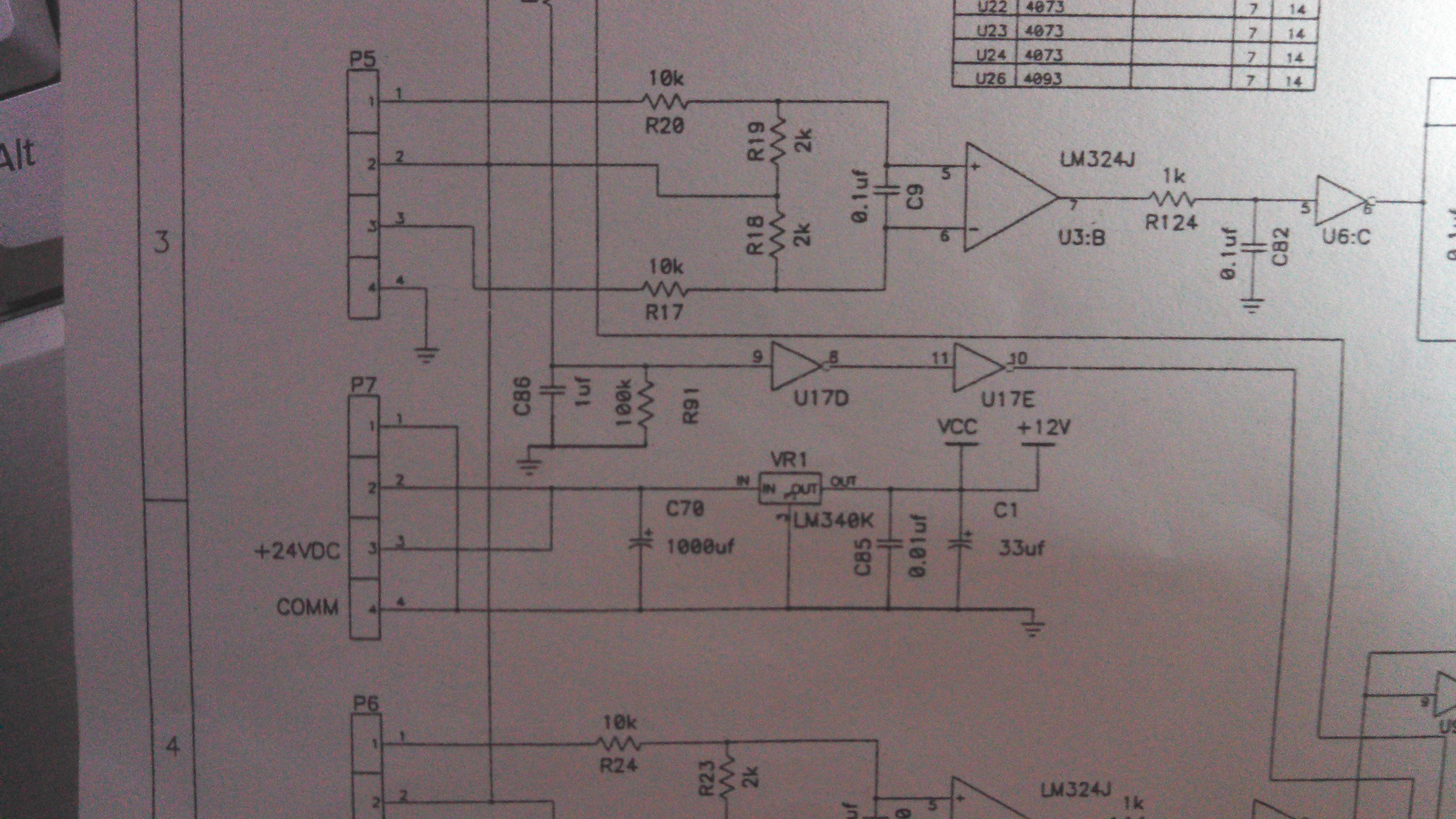

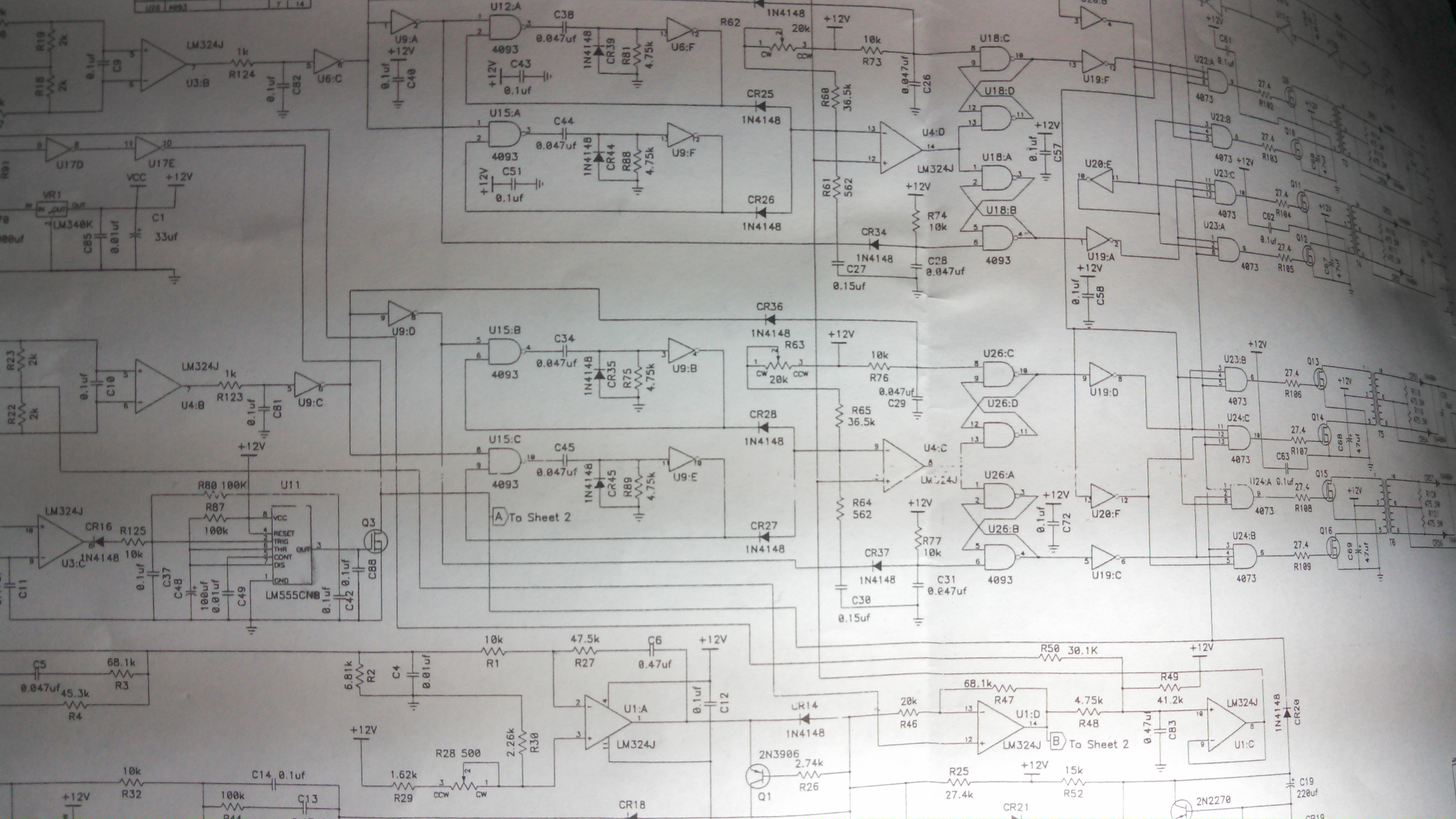

Is U17 an open collector inverter fed with a +12 V supply? Logic family/chip #?

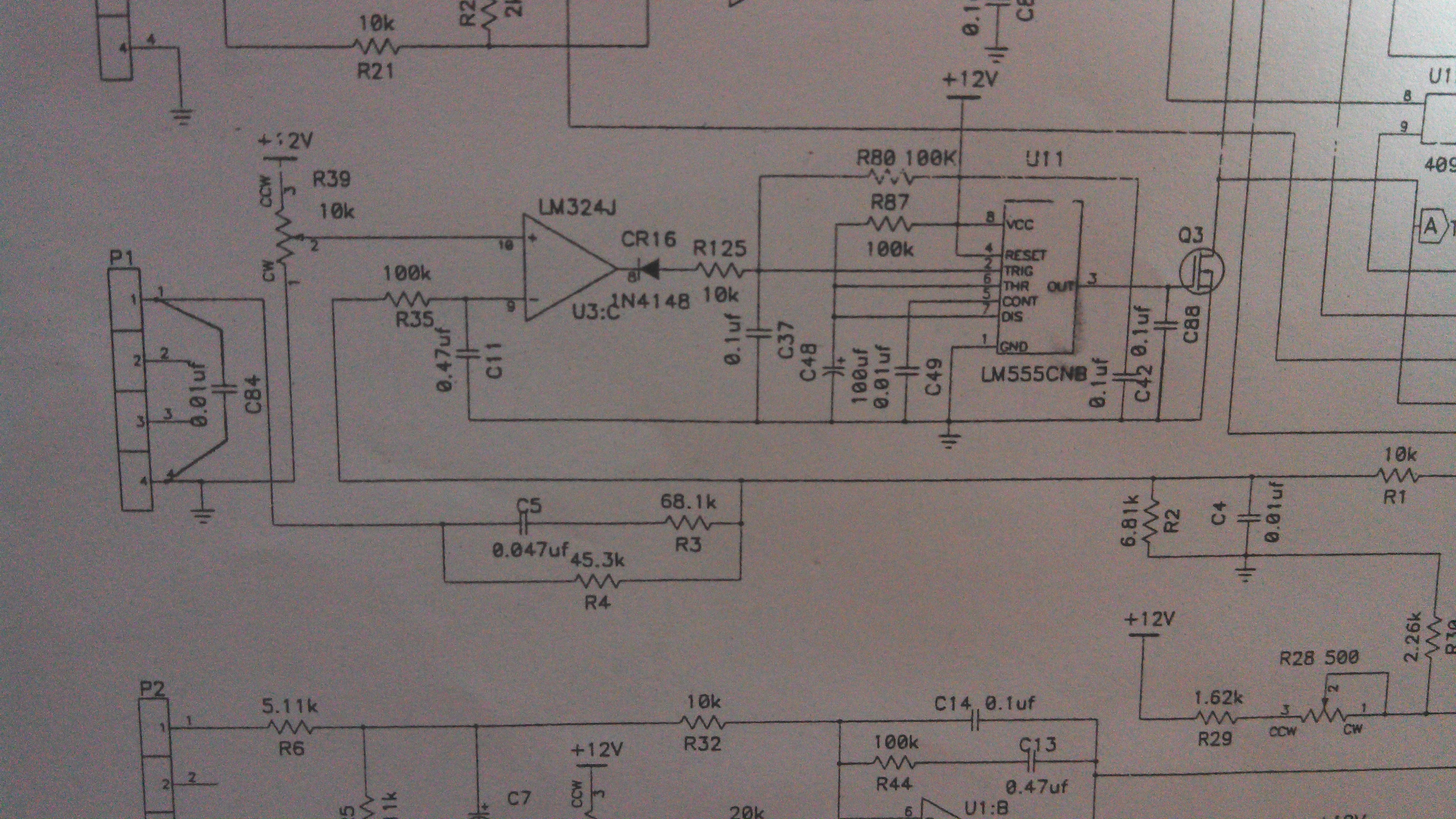

Where does that signal go to the right (source of the FET)?
So far, I think it's just to ease the interfacing to a CMOS logic family, but can't tell yet.
This sure looks like a complicated beast and/or definitely high power.

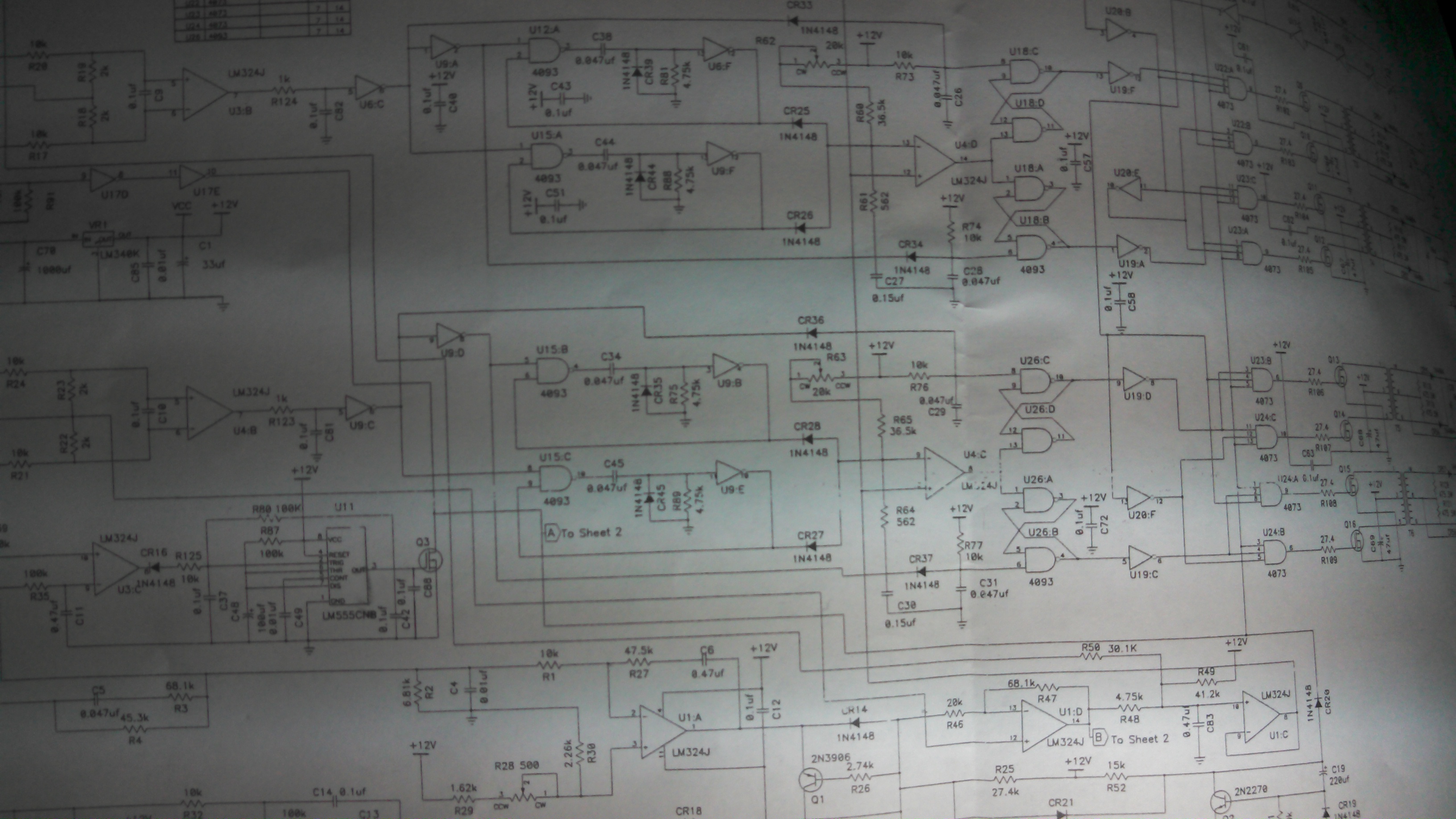

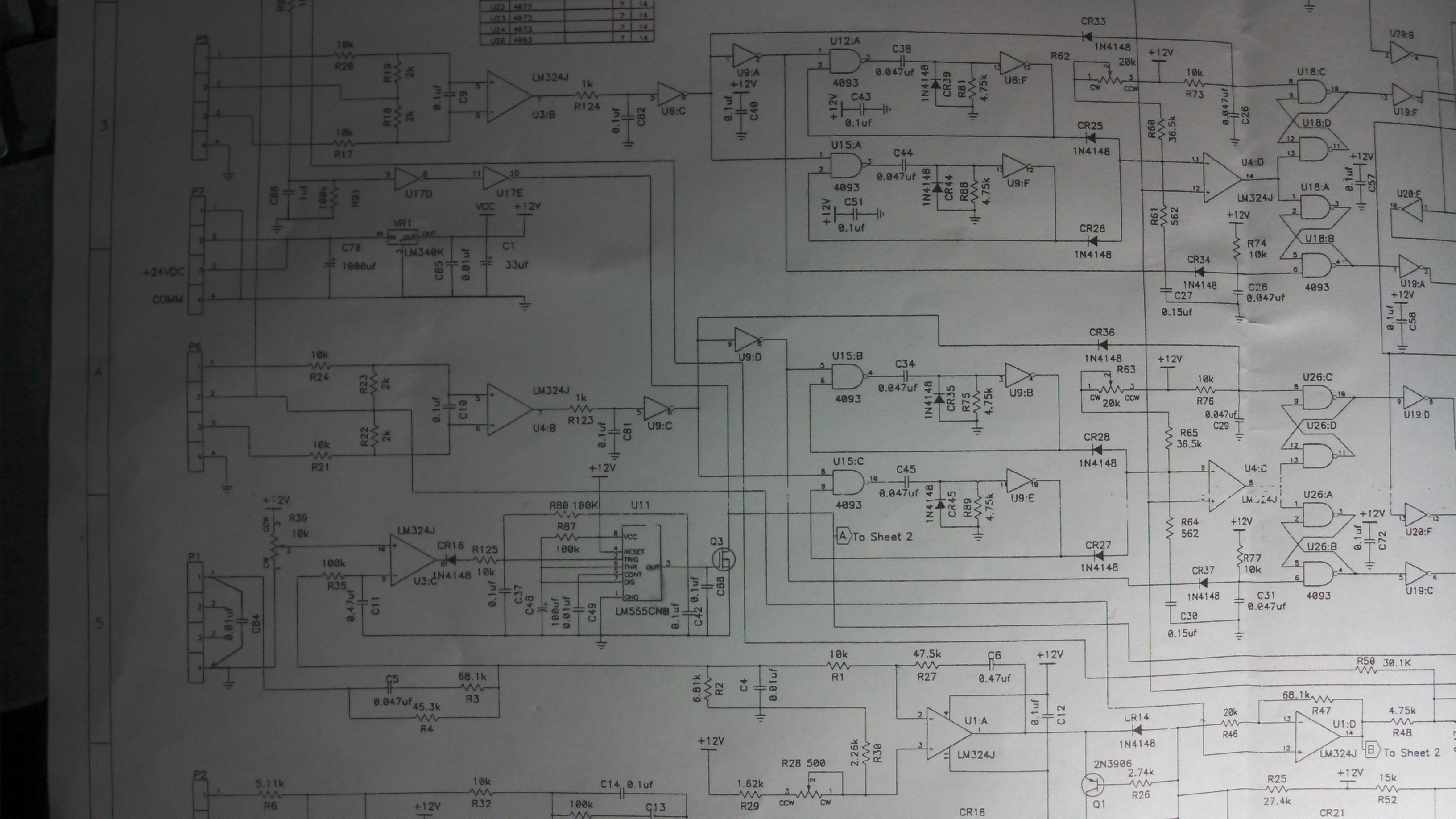

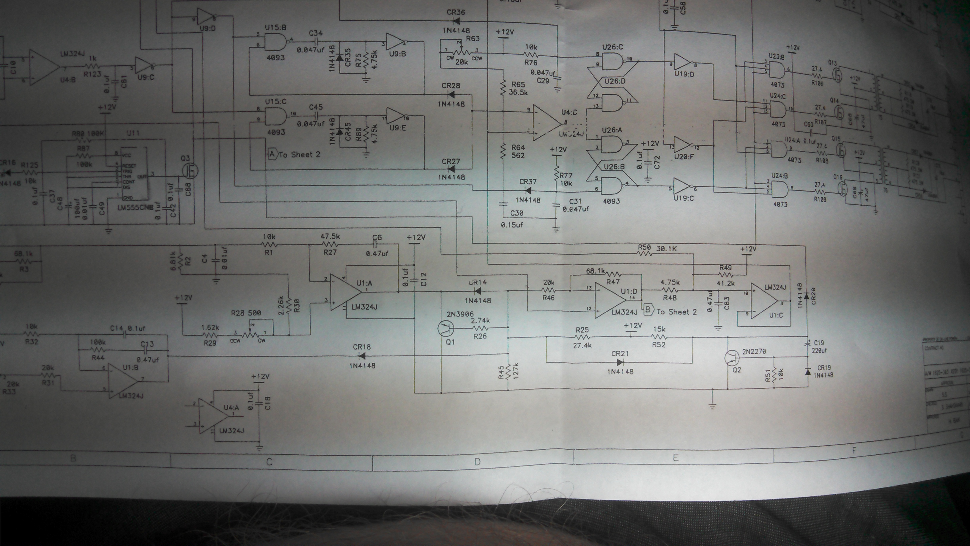

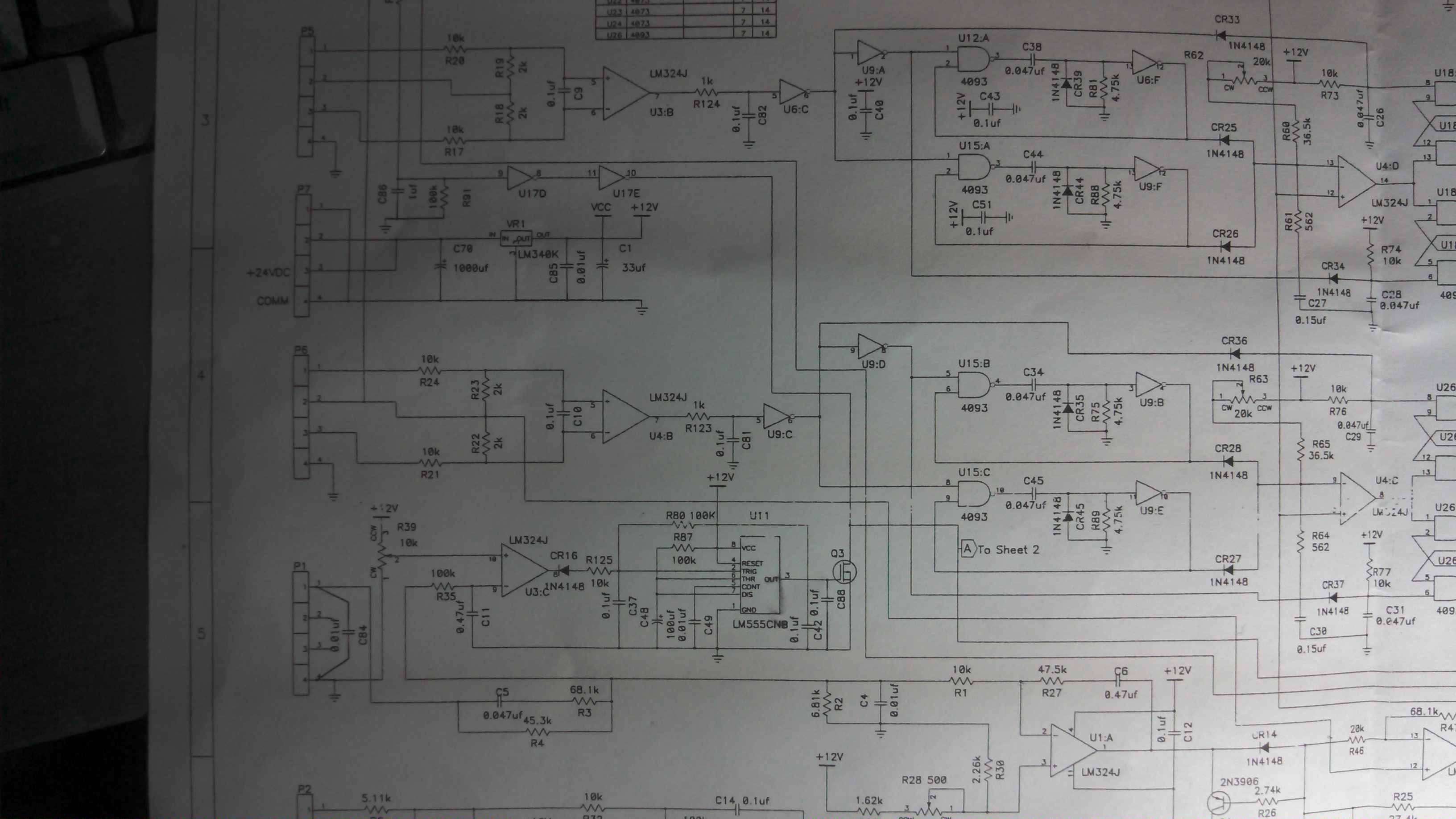

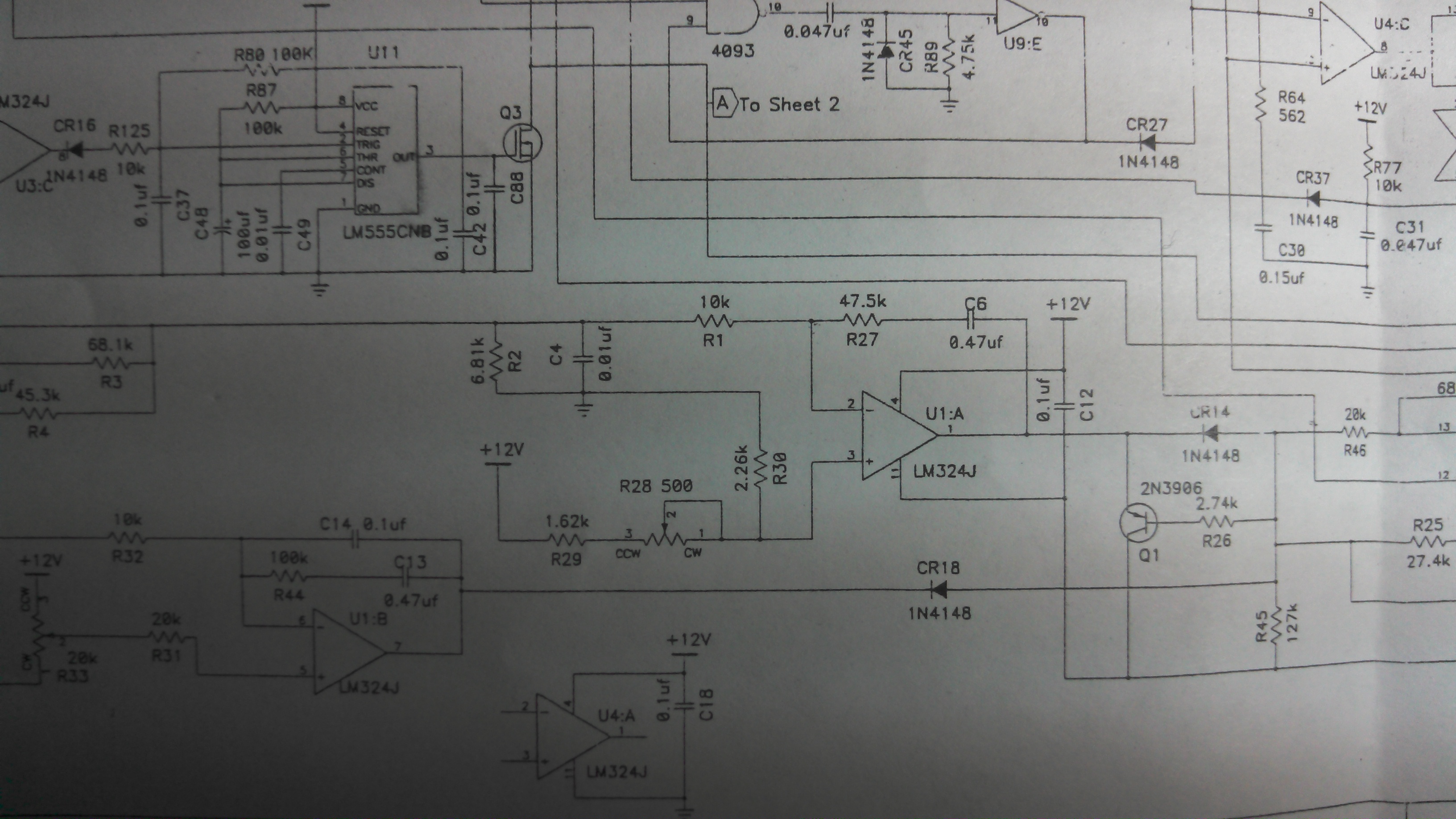

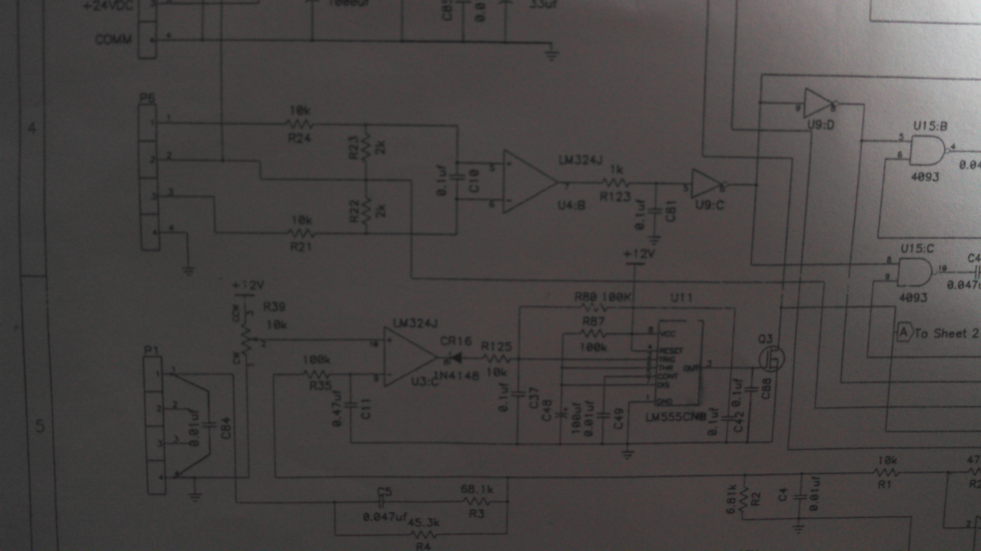

Here is more pictures
Looks like it's used primarily because of the logic family used in the 4073 and the FET may actually be faster switching than a bipolar transistor.
PS: Pretty nice pics BTW.
so the FET just speeds up the switching from the output of the 555 timer?
The 555 Timer Is TTL , and the FET converts TTL to CMOS ? likes a level shifter?
True. TTL has specific characteristics like a 5 V supply. TTL compatible means logic levels are compatible usually, so we have 3.3 V CPU's that have 5 V tolerant inputs if current limited by a series resistor.

My manager said that the Logic FET in that circuit just sinks the voltage to Zero volts
The 555 timer gets triggered by a comparator op amp
The 555 timer sends out a pulse train for 20 seconds to the FET
The FET than sinks the voltage to zero volts
