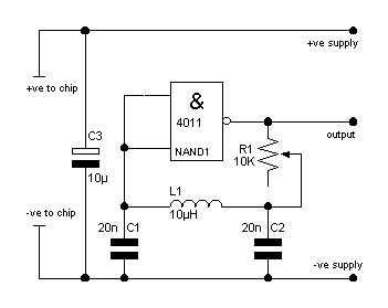

Here's the oscillator circuit from the EPE LCF meter, with the values shown it runs about 500KHz, it's nice and simple!. The preset is adjusted to ensure reliable oscillation.
As you are at school, presumably you have access to scopes and frequency counters - you could use either (or both) to check the amount of frequency shift you get, and find the optimum frequency and size and shape of coil. Your teacher should love you for it :lol:

Ok, maybe a very stupid question. But how would you attach that thing? I mean, if you charge a capicitor it won't oscillate forever... don't you need some amplifier or something? I'm sorry , but i'm just a first grade student ;) I found this sheme **broken link removed**, can't I use that? :) thx in advance

Sorry, do you mean 'where are the supply rails?', it's normal not to bother showing them on logic circuits - you do (of course) need power for it. The CMOS NAND gate is the amplifier, it's a standard circuit.

Yes that :P I feel really stupid you know :? but erhm... bottom is plus ? It dc right? And ehm.. where would be the output then, after the nand gate?? pff, i should really try this with a oscilloscope, much easier than guessing :) Where would I be without you ;)

Perhaps I should have labelled the diagram :lol:
Here's a slightly better diagram, you will need to sort out the pin connections for the chip yourself.
