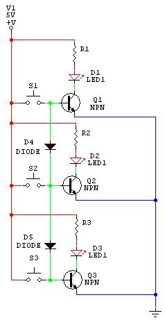

I am trying to workout how to light up the ball/strike/out counter. this is what i have come up with. I think it is done correctly but could someone please have a look as I don't really have a great understanding of transisters. the three buttons will be replaced with outputs from the 4017.

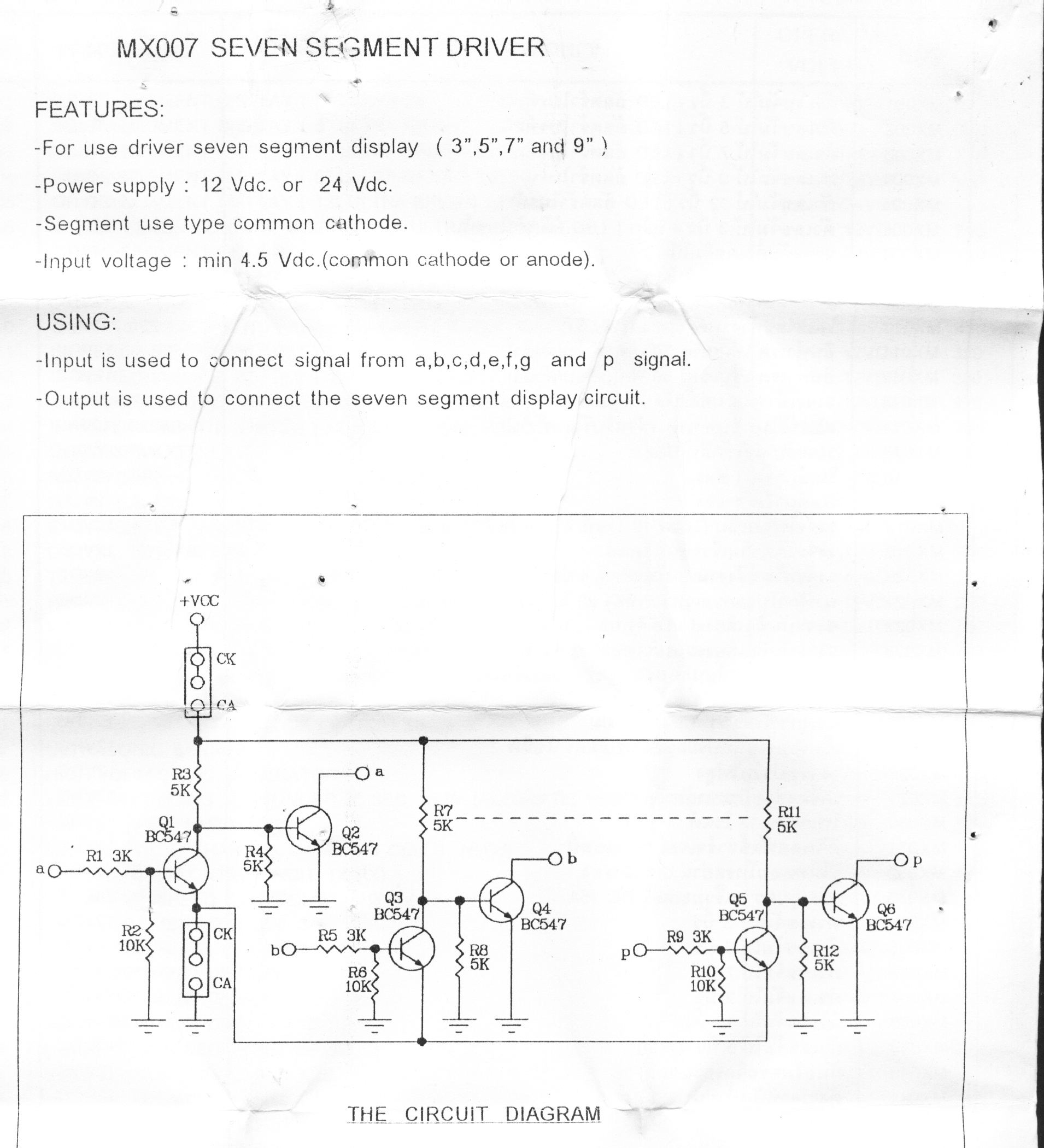

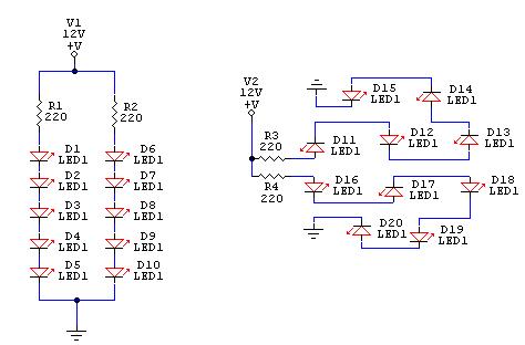

Still here and going at it. I have now got my Scoreboard Numbers which are powered by 7 Seg Drivers but the thing is these run off 12v. I have 5 Digits and another 7 seg driver which I will be using to light up the ball/strike/out leds as well. (see Attached Schematic). My question is how do I get 5v to power the BCD to 7 Seg decoder aswell as 12v to run the lights. I will need ball park 3amps 12v to power all the leds if all lit up at the same time.
Ben.
Simply use a 7805 regulator with 12v input from your power supply to get your 5V source for your decoder. Might need to heat sink it, depending on how many decoders you have hooked up to the 5v.
