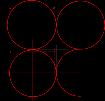

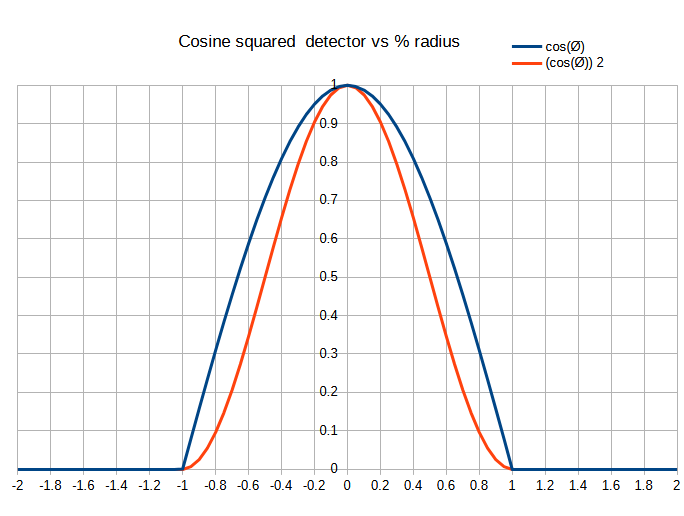

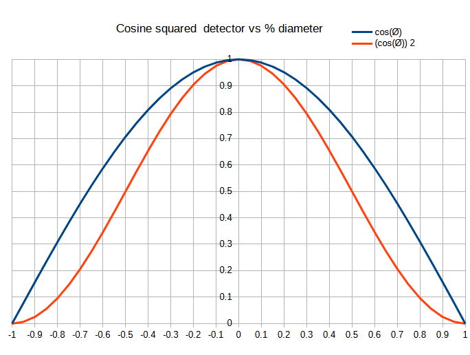

I am suspicious this is a complete waste of time without design specs on the optic sensors.
Where are all your physical optical electrical specs? I doubt you have enough sensors to block the corners then I doubt you have the speed to track all the sensors in xxxx microseconds. It's a round ball with a round sensor so you may need > 2 sensors per ball diameter minimum using this method. Perhaps there is a better method.
I doubt you will need "pro" speed, v,= 100 MPH = 4470 cm/s and the MLB baseball diameter d = 2.87 to 2.94 inches (7.29 to 7.47 centimeters) The ball speed may travel its minimum center diameter in d/v=t= 7.29/4470 = 1.6 ms
At an offset of 50% of 2.81" spacing the round sensor laser block time is from zero to some small percent of the time duration. The transfer function of blocking a beam with 45 deg vector on a circular object is cosine-squared but with a thin beam detector in just one axis along the middle it is just the cosine law.
This shows you need twice as many sensors as you have computed to block more than 50% of the incident light assuming 100% is calibrated accurately.
It seems like everyone is assuming your optical design is OK.
which it is not.

Firstly, even if it never works, I don't consider it a waste of time since I'm learning a lot. Old people need to use their brains to keep them functioning :) And the costs involved to this point are minimal.
I can throw a ball as hard as I can from 4-5 ft away and "most of the time" both the X anY coordinates will register. I would assume that those times where they don't are due to not having more sensors close enough together. It had not crossed my mind that the further from the center of the ball, the less time the sensor is cut off from the light and that a round ball through a square hole might slip through completely unnoticed. . That makes perfect sense and I can't believe I never thought of that.
I am currently using the 2 Arduino hardware interrupt pins to monitor the mirrored AB interrupts from two MCP23017s. The interrupt service routines do nothing but set a flag to indicate an interrupt has occurred on that particular MCP23017. The loop routine doesn't do much until/unless both those flags have been set. Doubling the sensors would mean adding 2 more MCP23017s and moving to my Mega to have the additional interrupt pins available. Will monitoring 4 interrupts bring everything to a screeching halt because there just isn't enough time as the ball travels through?? I don't know!! But I will certainly be giving it a try...
Thank you very much for your comment! It has given me something else to think about and probably answered why there are times when there isn't both an X and Y interrupt - or neither.
