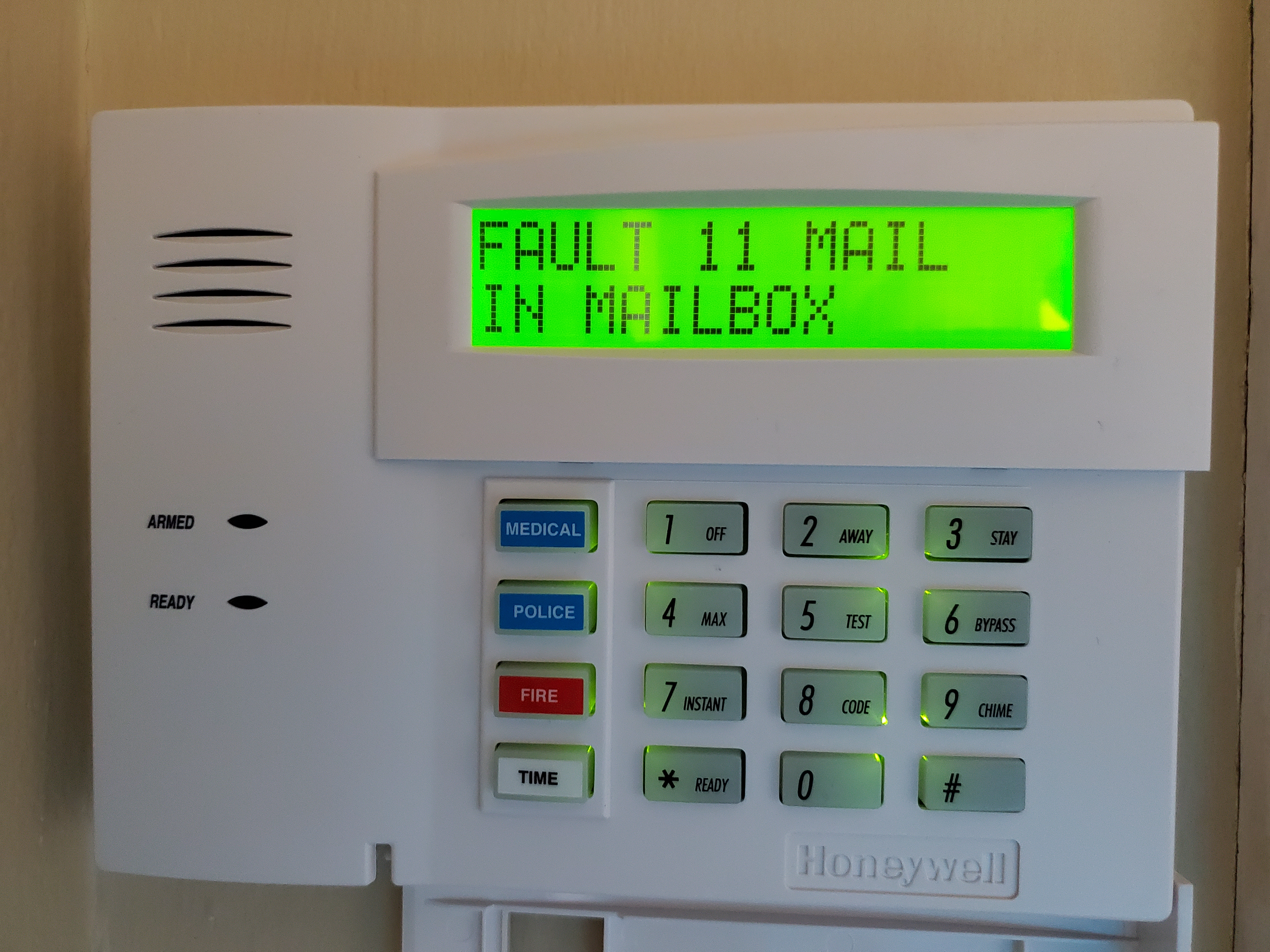

I put together a little logic circuit that tells me when we have mail in our mailbox and it has been working pretty good. I used two TCRT5000 proximity sensors and ran them through an op-amp and then to an OR gate, so if either sensor picks up the reflection of the mail, it would close the circuit on an Ademco wireless switch. The datasheet mentioned that the photo-transistor blocks visible light, but sunlight immediately trips the circuit. This really isn't much of a problem, because once the door is opened, then sensor trips the alarm and if mail is placed inside, once the door closes, the sensor sees the mail and stays in a tripped status. If no mail is placed and the door is closed, then the alarm will not remain tripped. I configured the alarm system to only chime & print "MAIL IN MAILBOX" on the keypads in the house, but to not activate the alarm in any other way. I chose this method, because I had the parts and I was bored during our COVID lock-down last year. I could not find a mailbox alarm that would notify me if there was actual mail inside. Most of them only alerted when the door had been opened. The whole reason behind this was to let my wife know the minute that the mail was delivered, so she could retrieve it as soon as possible. We routinely get heat-sensitive items and even during the Winter, the inside of the mailbox can get pretty hot.
This worked great until it started getting very hot outside (above 95 degrees Fahrenheit). Then the sensors get so hot that they trip the alarm sensor and the alarm panels chimes. This only happens briefly and the alarm sensor resets. Sense it only happens a few times during the hottest times of day, I just disabled the chime. We can still see the message on the keypads, but I'd like to get the chime back on, so she can hear when the mail gets delivered.

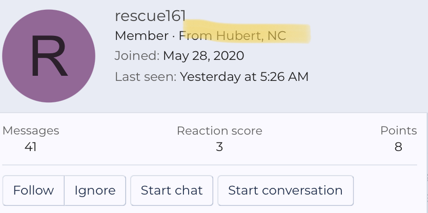

Where are you located?
ak

I finally got around to wiring up a fix. I went with an op-amp delay circuit, since I was already using two op-amps (one for each sensor). I changed out the dual op-amp for a quad and am able to adjust it anywhere from instant to 20 seconds. The cool thing about using this circuit is that the "timer" resets very quickly. Even a brief trip will reset the time completely, so I should be good to go. The alarm in the house won't chime until it stays in a tripped status for more than 8 seconds. It is really starting to heat up, so we'll see how well it does.
