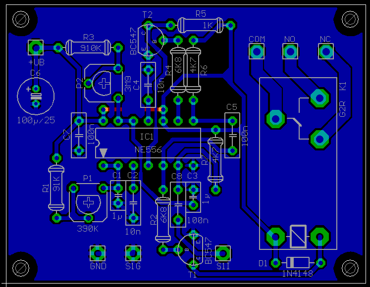

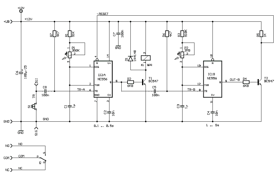

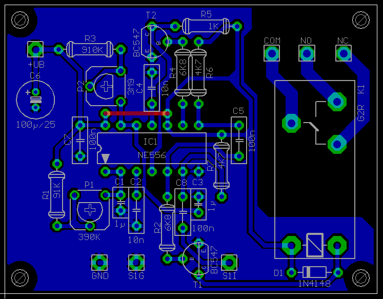

Hi 4pyros,
here is another design using the dual timer IC NE556. The PCB design has become smaller.
Dimensions are now 61.2754X47.3075mm (2.4000X1.8625")
The design is not fully single sided and requires one wire jump.
I doubt that if using an MCU the part count will decrease. You will need a clean stabilized 5V power supply (the NE556 can be supplied with any voltage from 6 to 16V). You'll probably also need a stabilized reference voltage.
Making the time settings via A/D conversion you need a fixed value resistor and a trimpot for each channel as you need for the analog version. 8-pin MCUs don't have a built in A/D converter and I guess the pin count will be the same as using the 14 pin NE556.
IMO it's wasted engineer work to use an MCU for such a simple task.
If you're interested in the Eagle files you might download them (zipped) from the article.
Here are the screen shots of the latest version.
Regards
Boncuk

Hi Andy
I have to agree with Boncuk in that the use of a uC really won't downsize things much if you look at it. Though the little PICAXE 08M will do pot input and has an A/D I don't know that it would be practical. I am guessing this is a Halloween thing and the clock is running down. :) Personally, I would run with Boncuk's 556 circuit, one chip and a few parts do it.
Ron

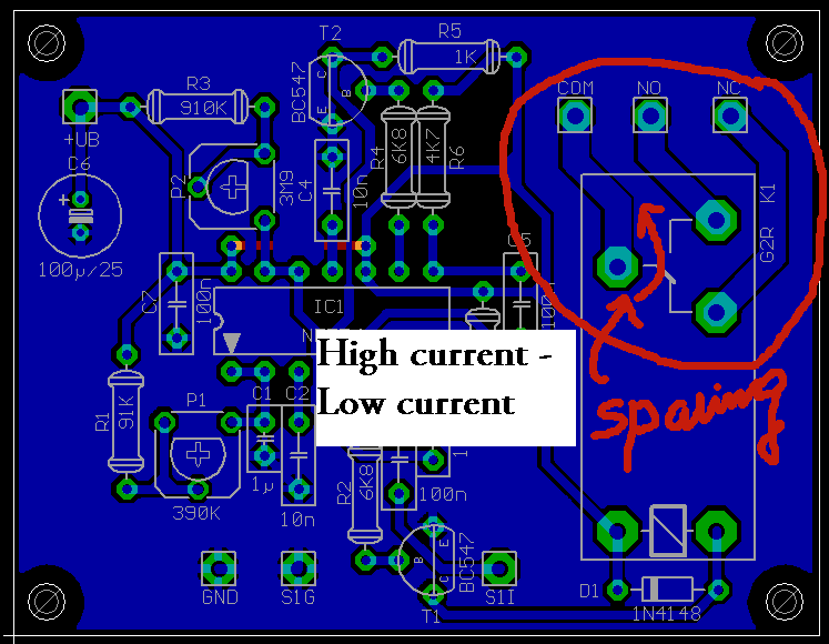

hey bonuk the spacing on PCB is too low. i think it may cause shorting.
Are you talking about component spacing or trace/pad spacing?
If your concern is component spacing - this is some kind of art not to be used by lumber jacks. :)
If it's trace/pad spacing: The spacing is big enough (0.3048mm between pads and traces) for everybody who knows how to solder properly.
Of course you'll have lots of shorts when you use a plumber's iron. :D
BTW, I'm Boncuk not "bonuk"
this might be the problem. may be you are using nano technology for soldering
hey boncuk (sorry for "bonuk") what software are you using for PCB, is it eagle?
It might become a problem if mains is involved because of insulation distance.
In that case it's up to the user to modify the ground fill or omit it around the relay terminals. For short traces like in this example the load could take up to 8A without problems.
It does not matter if high or low current flows via the relay, voltage is what matters, starting to arc between traces and pads if it's high enough.
Nano technology is not necessary for a clean solder joint with relatively bulky pads.
The ground fill modification took me two minutes.
And yes, I'm using Eagle.

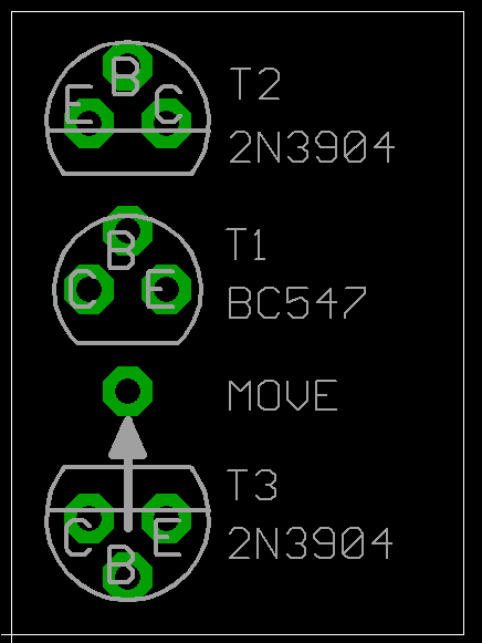

I will try and solder up a prototype tonight. Boncuk can you tell me what D2 is for? Can you tell me the right resistors to ues with 2N3904 Transistors? Thanks Andy
Hi 4pyros,
I don't see D2 on the latest design. It was contained in the 2XNE555 design. D2 serves to discharge C5 rapidly when powering down the circuit.
The 2N3904 is about the same as a BC547. You might use the same value for the base resistor. Check for different pin connection of the 2N3904.
Top view of the BC547 is E-B-C, the 2N3904 has C-B-E. Rotate the transistor 180degrees and bend the base-pin to the opposite side for correct connection. (see attachment)
Regards
Boncuk
