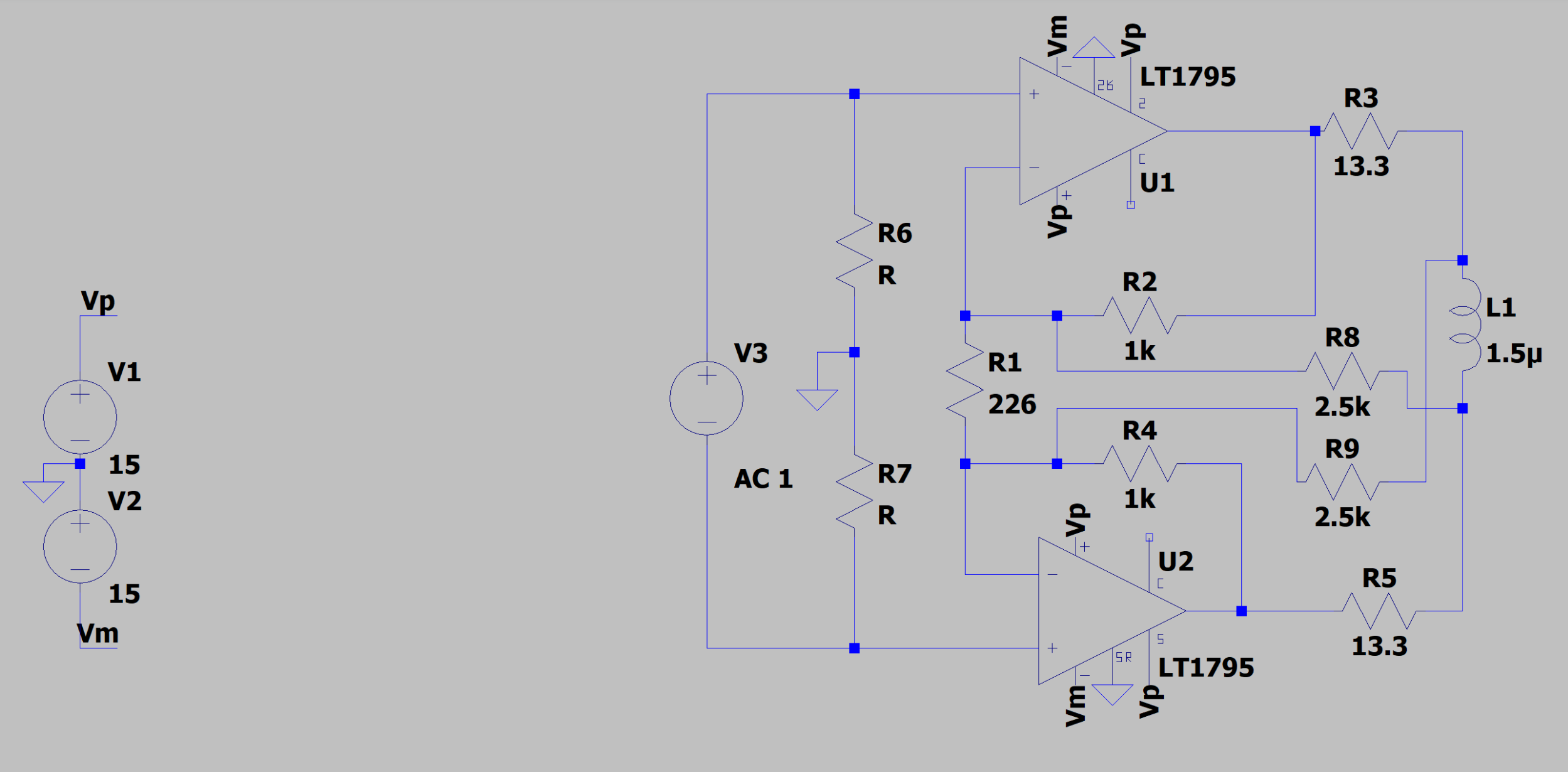

There is a circuit I built which inputs a differential and outputs differential present in Ltspice schematics. I want this circuit to input a single ended signal. Is there some active component or certain active configuration with this component which will transform single ended AC signal into differential signal? Thanks.
With any true differential input circuit, you can just connect one input to the common of the single ended signal, and the other input to the signal.
Use the circuit you have and ground one input, in other words.
