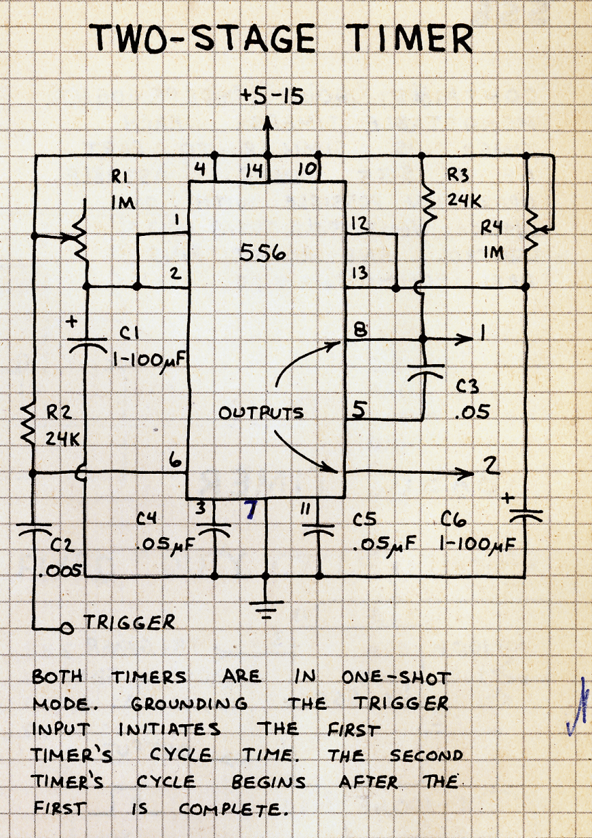

OK attached is an image from an old, old booklet that I have. Credit for the circuit goes to Forrest M. Mims III. I believe you will need two timers as you mention. This can be done using a LM556 or two individual 555 timers.
The attached circuit has as can be seen two outputs. The second output goes high (active) following the active high period of the first circuit. That gives us two re triggerable one shots. Your problem is that following your trigger you want a delay before the timer can be re triggered. You want any triggers to your first timer inhibited for a period of time. Before I forget, output #2 is pin 9 of the chip.
Pin 4 of the chip is the reset for the first timer. For the timer to function (timer 1) pin 4 must be high and thus it is tied to V+. However, if pin 4 is held low the first timer will not trigger. You would set the period of the output for timer 1 for your desired time and use it to drive your air cannon device. That assumes the device doesn't overload the chips output. Additionally the output of the first timer starts the second timer.
Possibly the output of the second timer could drive a small transistor like a 2N2222 with the collector attached to pin 4 of the chip (the first timers reset) and to V+ through a 2.2 K resistor. Normally pin 4 would be held high by the 2.2 K resistor but when the second timer went active high it would turn on the 2N2222 and place pin 4 at a low inhibiting the first timer from doing anything.
The attached circuit shows pots for R1 & R4 and as to C1 and C6 between 1 and 100 uF caps. Those values could be changed to fixed value components to meet your timing needs.
I have not tried this so will not say for sure it will work but it is a thought. Possibly another member could simulate it. It is a thought and a rough thought with little more than a circuit to modify. I have not really thought it through but figured I would toss it out there.
Also the 2N2222 should have about a 1 K Ohm base resistor between the timer 2 out and the base.
Ron

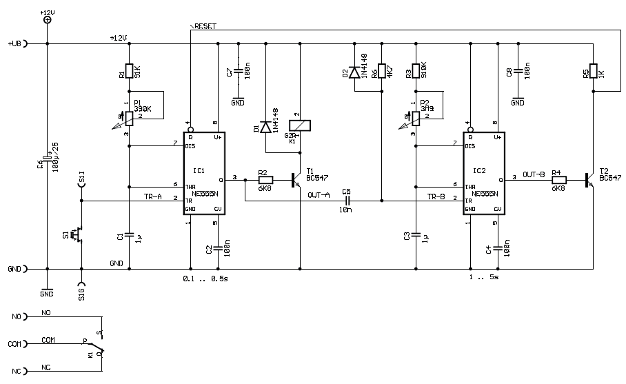

Hi 4pyros,
this circuit will do.
The idea is to have two monostables triggering each other.
Timer1 (IC1) is triggered by a switch (S1) to ground. It will start and activate the relay via T1. When timed out its output will go negative triggering the second timer (IC2) which is a non-retriggerable monostable. With its output going high T2 will conduct and pull the collector towards ground, thus disabling IC1 by resetting it until timer2 times out.
The circuit might be triggered upon power up, causing it to reset IC1 until IC2 has timed out.
If this is an issue you might use a power up reset circuit for IC2.
If 10nF for C5 won't suffice use 100nF for coupling.

OK I breadboarded Boncuk's circuit and finaly after some changes got it to work.
First off I added a .01uf cap to the trigger input to the 1st timer to make it a true oneshot, in series with pin 2 with 10k pull up resisters on either side of the cap. I did not use a transister on the output of the 1st timer because the relay draws less than 200ma. I did not use the diode to keep it simple. I used a 2N3904 with 10K resisisters on the output of the 2nd timer but I should be able to tie the output of the 2nd timmer directly to the reset of the 1st timer? to elimante the 2nd transister.
I always use a transistor to switch a relay. It's of course up to you to switch it directly from the timer output at low current.
It's just a matter of arithmetic using or omitting a cheap diode to suppress back EMF of the relay coil. A new timer IC will definitely be more expensive than the diode.
More later. Andy
IC1 is being reset by IC2 until that one times out. IC2 goes active high when triggered. That means you will not be able to keep IC1 at reset condition to avoid early triggering. Observe the dot at pin4 (indicating an inverted input) of the timer ICs. They must be kept low to reset.
Reset must be inverted and a simple NPN-transistor is an easy way to invert levels.
Boncuk

Thanks again Boncuk;
I assumed nobody will be standing on the mat for hours to retrigger the circuit.
Sorry I did not make it clear that I only what it triggered once per group of peaple.
It was not the relay diode I left out it was D2 what was that for?
Yes after thinking about for awile last night I saw the need for the invershoin so T2 stays. Off hand can you give me the proper resister values for using a 2N3904 thare?
the circuit has not been taken off the shelf. I designed it just for you and it hasn't been tested, but should work the way I designed it.
yes it worked as desined just changed the trigger input to detter sute my needs.
