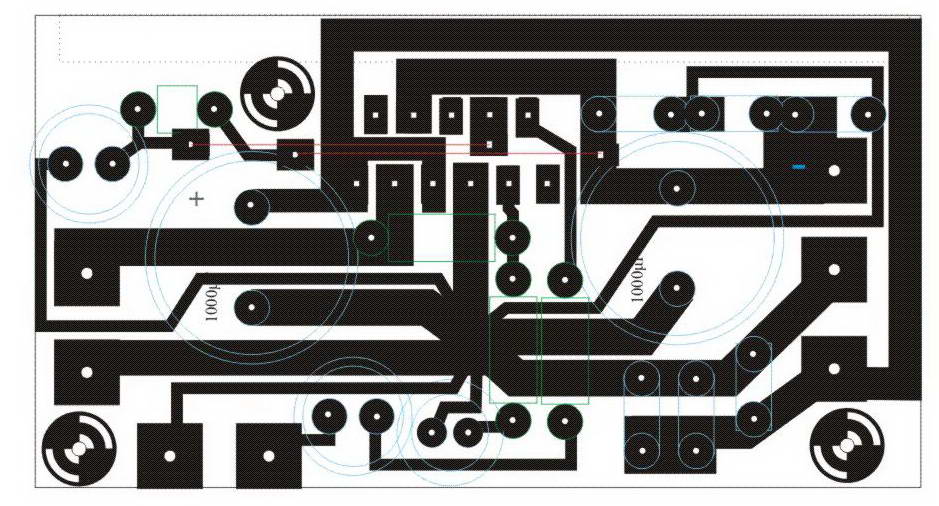

Well here is my problem.
I put everything on that board I did from National datasheet and then supply it. what I get? +40 volt at the output...
The supply I use is +, - 41.8Volt.
Ok there was a miss calculation somewhere there and got a 2x30Volt 150Watt toroidal for my 2x50Watt amplifier.
Ok I know it is a bit high (at the limit of the chip). When the supply is open air I measure +41.8 and -41.8 but then when I connect it to the board and measure the supply voltage at pin 1, 5, 4 it is +38 and -38
It is strange to me that I hear everyone say how good that chip "work" and all I get is +supply at the output (pin #3), having nothing connected as input signal. Thank god I measured the output before I connect it to the speaker, or I would have them in my hand :p
I also get that +40 volt at the output, even if the mute pin has no currect drown from it.
Is it realy that power supply I use? or something else?
p.s.
that is the circuit board I made :)

i just built an amp with the 3886 that is very similar. i doubt there is anything wrong with the chip. there could be a small piece of solder bridging between two tracks or something could be hooked up wrong. do you have a schematic for the circuit or an overlay for the pcboard artwork. i would check every connection and make sure everything is where it is supposed to be.

well I have attached the circuit board you can see it if you like.

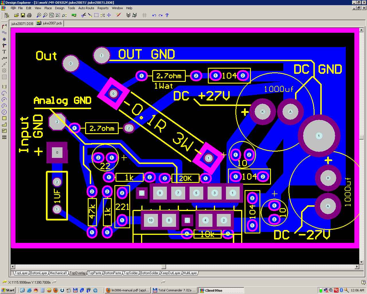

Anyone that wants a Fully working proffessional LM3886 & LM3876 Design here it is.
Tip.1 the chip amp at pin 7 does not have a DC ground. it is an Analog Ground pin which goes to the DAC or input signal ground :) The chip amp simply does not need or use any DC ground at alllllllll....
Tip.2 if you use at the Input the 1UF Cap high quality, then you will not get any noises from the input wires or any interference at the inputs :)
Tip.3 Make sure you have the Grounds separated... with a 2.7 ohm resistor between DC Ground planes and Analog Grounds as shown in the design...
Tip.4 Also as i have said before... Use a GOOD speaker about 500 WAT with a nice BIG magnet... this will increase the Speaker Response time and give you the FULL benefit of the 50Wat chip which has extremely wide BANDWIDTH...
Tip.5 Do not increase the Gain resistor to more than 20K in this circuit it will give you a 20 x Gain. and DO NOT go lower than 15K. Lower Gains means MORE BANDWIDTH and higher gains means LESS bandwidth but higher output power.
Tip.6 The less the Bandwidth the more Voltage one can use. this means if you power the amp at +/-35V DC you should set the Gain at no less than 20K. if you want more sound detail then set it at 15K the gain, and use +/-28V DC and you should have a nicer sound.
Do not think that if you use a +/-28V this will decrease the sound by much if you use the right Speakers. believe me when i tell you , you wont be able to stand in front of it at +/-28V-DC if you have a good speaker of 500Wat with a huge magnet. your chest will be pounded by a hammer at 2 meters away.
PS. in the design at the output i have a 0.1 Ohm resistor which should be ignored as it is used for parallel designs. However for the best output performance with LONG speaker cables to the speakers i strongly suggest to use a 10K resistor in the output with a 0.4 coated copper wire with a 10 turn over the resistor with the ends connected to the resistor, and make sure it is ANTI CLOCK WISE from the OUTPUT of the chip...
The reason it is used is because the LONG cables become CAPACITORS due to long distances and can destroy the AMP in a split second if the capacity on the cables reverse :) so the resistor becomes a BLOCKING PROTECTION to such output SURGES... before one should consider using this resistor one must make sure that the cables are more than 10 meters from output of the amp to the speaker...
i highly recommend this amp and this design to anybody that wants to have only but the BEST.
Best to you all and i hope you will enjoy it.

the problem with the board in post #1 is that the input is isolated. in the data sheet example, R2 serves to ground reference the input, and provide somewhere for the input bias current (yes, this is just a big op amp) to go. with the cap at the input and no ground reference such as R2, the input bias current just charges the cap, and you get offset.
you need to ground reference pin 10. it's floating negative, and that's what's causing the offset
not if i'm reading the PCB layout in post #1 correctly....
The 22k on pin 10 should make it ground not -19 so you might look there. However if something is wired wrong it could be anything. Maybe a check of all the voltages on each pin would help.
yes it is, and should preferably be a star ground, which you do have, sort of... btw what's the voltage on the INPUT GROUND compared to the DC ground?
